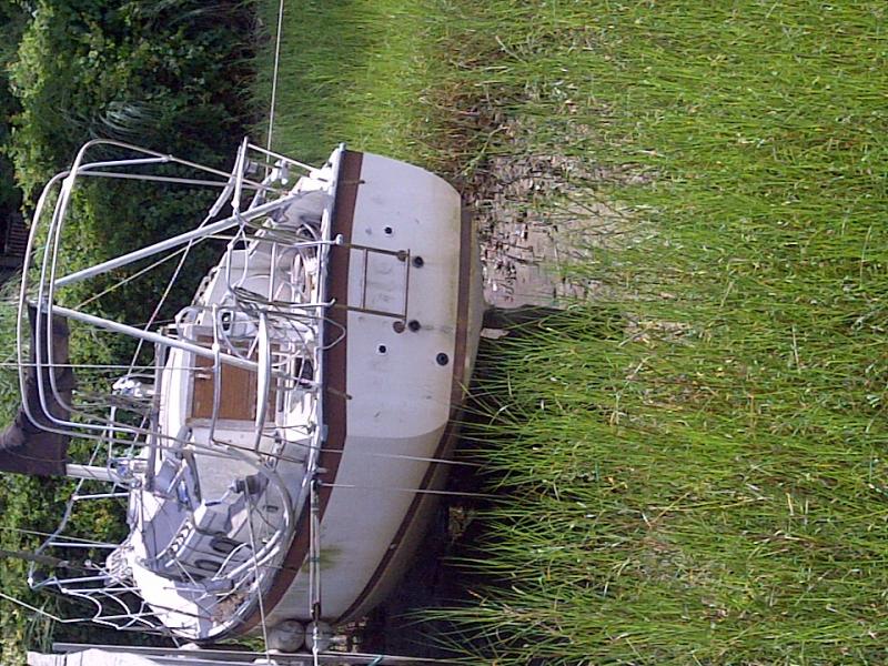

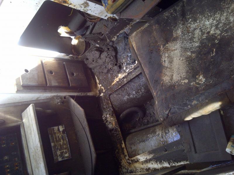

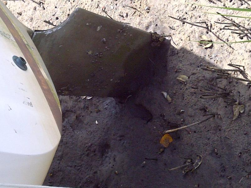

Mm. I went last year to look at salvaging a Compac Yacht, it was around 35 ft. Some years earlier, the now deceased husband had somehow managed to winch/pull whatever the thing up on the tidal mud banks. How or why he did this is a mystery to me, and not the point here. But the tide swings about 4 1/2 feet there, and would just barely make the waterline at times, mostly not. The fixed keel was planted FIRMLY in the mud, and again, had for a few years I guess. Through the rocking from waves or whatever, it had pushed the keel up into the cabin by a few inches. Water and mud was inside. A total loss/ruin. It's probably still there, there's not enough value in scrapping/excavating FRP boats.
If this were the case with your boat, the evidence inside will be obvious to anybody. That's not to say that it hasn't begun to crack, or the keel separate.
I would think, and just my opinion here, but the only way to know for sure is making it high and dry. Anything else would have to be a very educated guess, by someone who has dealt with this specifically.
One more thought. While the keel will sit straight on a block, its motion is carried by the jackstands, (which ideally hold little of the actual weight of the boat). Even careening seems to be an acceptable short term solution to bottom issues, but the keel and the hull both support it. So the idea of the keel stuck firm, with little or nothing holding up the "sway" of the hull, and maybe knocked about by the water, uh...can't be good...

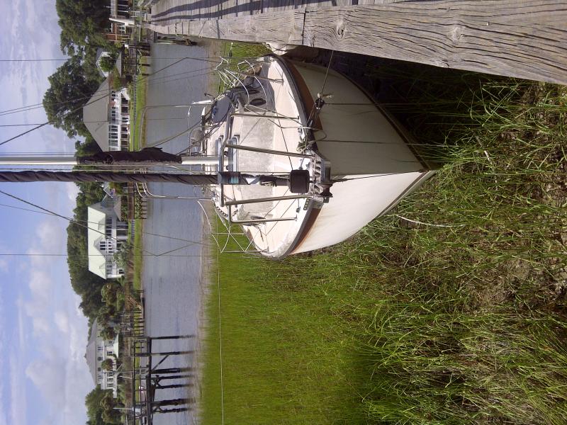

Nah, that's the problem mostly I think. It rarely, if ever actually floats anymore. It's stuck up in there like a popsicle stick. The water only goes partially up the hull, and that's the I.C.W. in the background, so it see's little mercy from the passing traffic. Pretty sad end actually. I have the means to salvage this boat, but the numbers said no..

Hehehe. That being the case, this guy drug it up in the mud about 200 years ago.;)
The sad note is, this woman's husband had died recently, and left her in arrears unexpectedly. She thought the boat may be worth something, and I investigated it. Even out of the bottom of my heart it was beyond me. It was going to cost $xxx to move the derelict. Intact, OR in pieces would be an undertaking..
