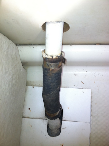

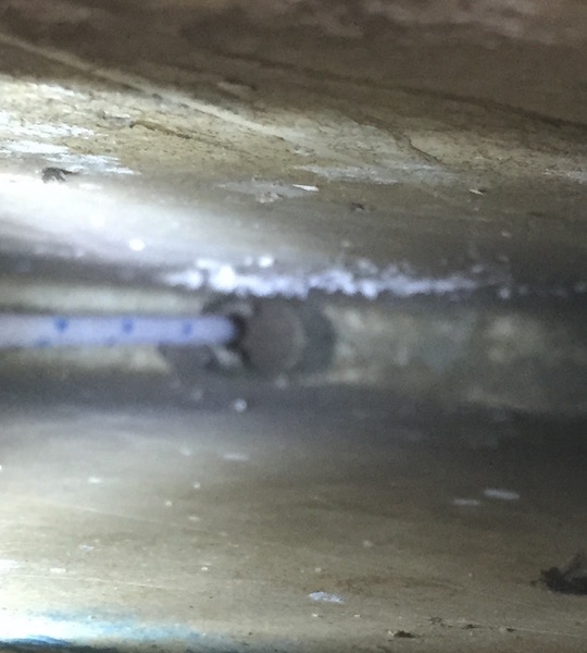

On my 1980 25 the pendant tube is fiberglass or plastic. It is held in place by fiberglass and resin and only slightly protrudes into the center board slot in the keel. Mine was well worn by the line so I glued in a SS bushing.
Inside the cabin the pipe is connected to a metal pipe by a short length of hose. That pipe then is connected to the cockpit thru hull by another short length of hose.

I attached a photo of the pendant pipe inside the cabin and one showing the bottom of the pipe in the keel trunk slot. You can see where the line wore a groove in the pipe. I switched to the 1/4" line you see in the photo which was taken before I put in the bushing.
