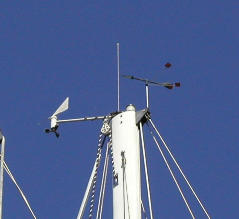

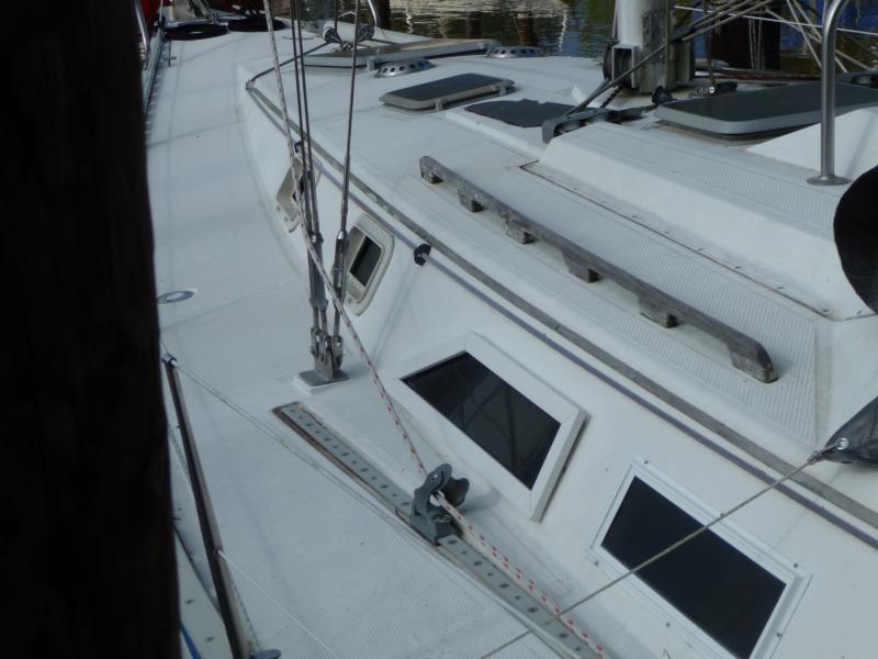

Hey, Mark.. the spin halyard on my boat enters the mast on the top (port side) and exits through the sheave on the mast bottom .. here is a picture of the top showing the black/white spin halyard entering through a fairlead .. from there, it goes straight down to the mast base sheave, through the organizer, and out the tunnel at the winch..
Previous owner had moved the jib halyards out of the mast base by exiting through a fairlead above the pulleys and turning at the mast base with a hinged sheave to the organizers.
