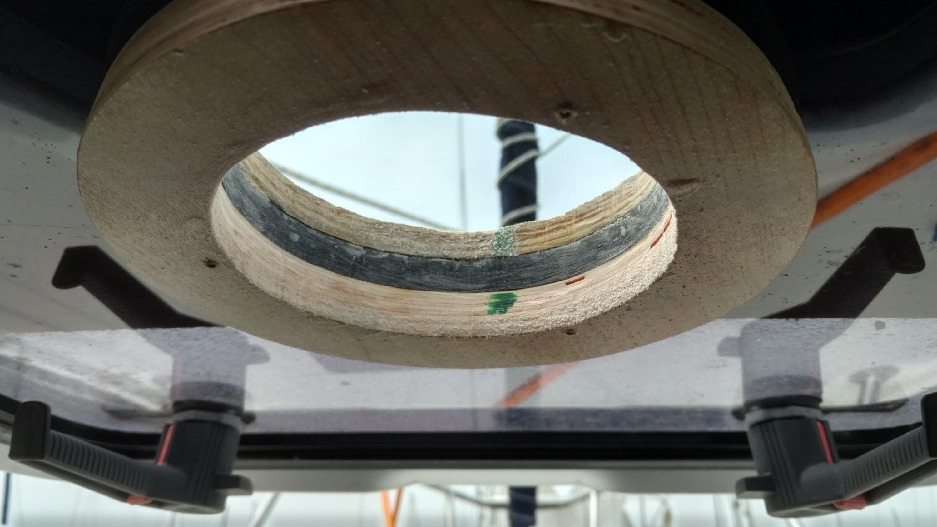

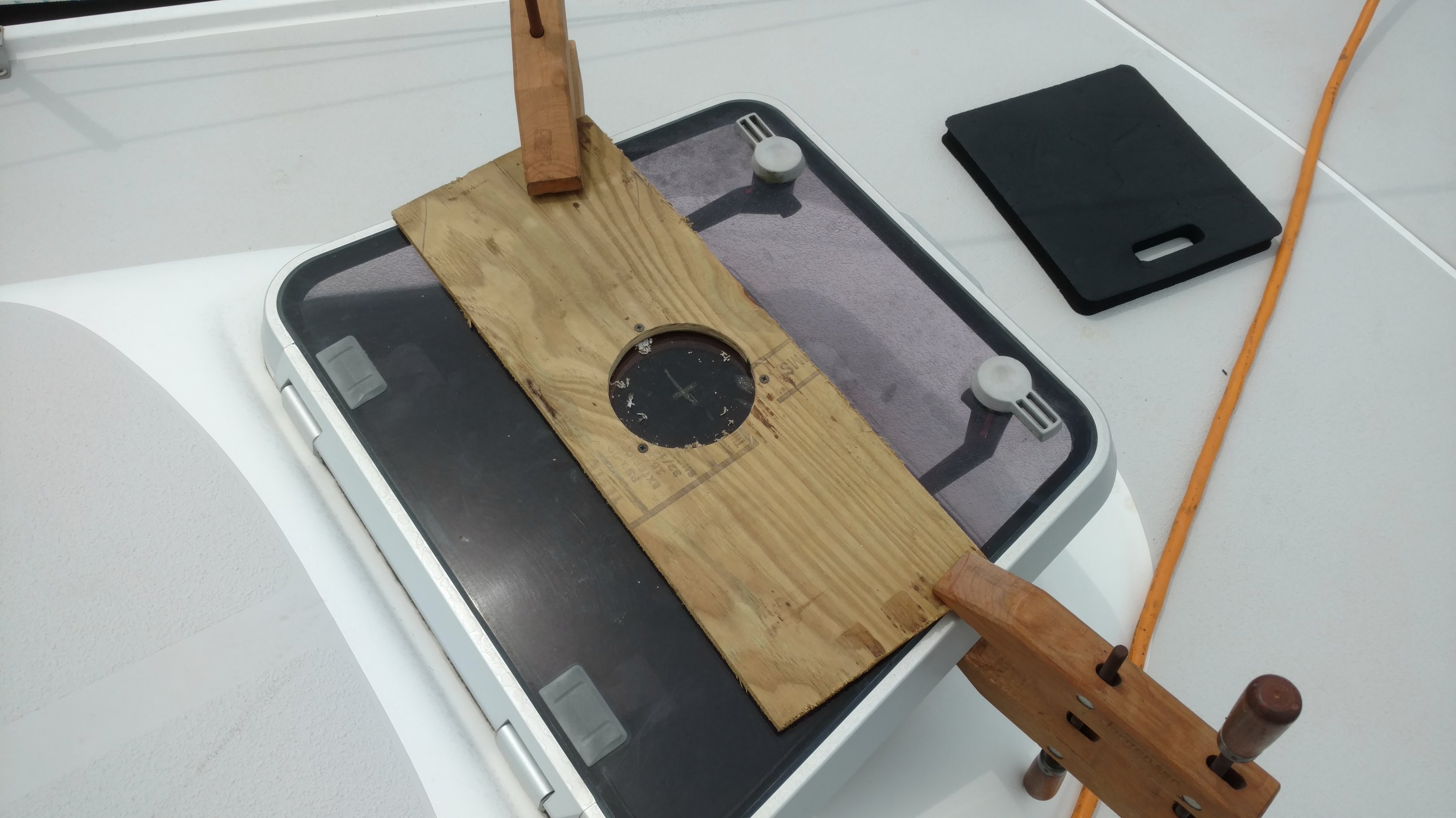

Well just following up. turns out the hole needed to be 4.75 inches....not an easy hole saw to find. instead I took Ron's suggestion and cut a hole in a piece of wood and clamped that to the top of the hatch. Then drilled 3 holes (to be used for the final mounting of the mount-ring). I also cut a wooden ring to fit below the hatch and used screws through those 3 holes to tightly sandwich the lens in between the 2 pieces of wood. i then used a sabre saw with new fine tooth blade.
Worked like a charm! the crazing was just on the thin outer surface of the plastic. And turns out the lens was a full half inch thick...a lot thicker than i thought it was going to turn out to be. Easily mounted the vent...
