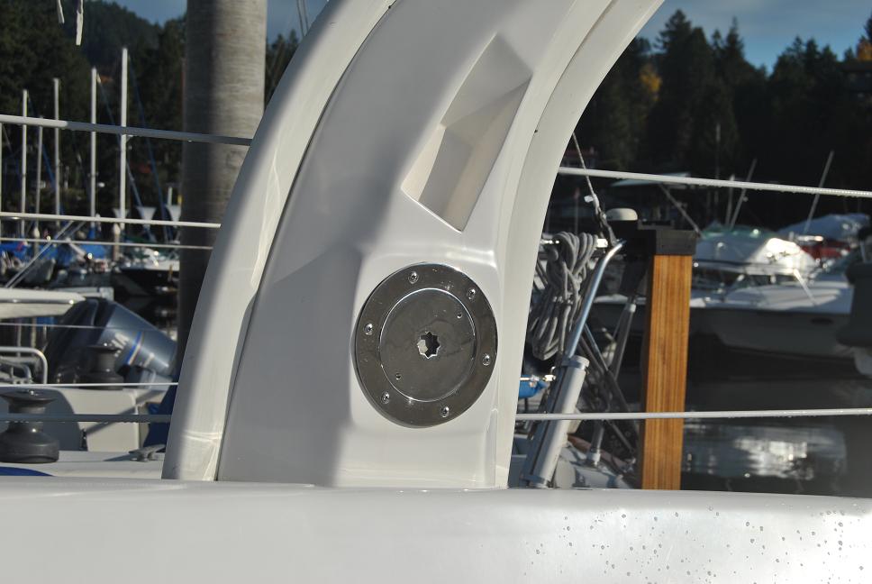

+1 on the deck plate. Make it oversized because a plate is a plate, and a few inches larger won't change the look. You might as well do something effective.

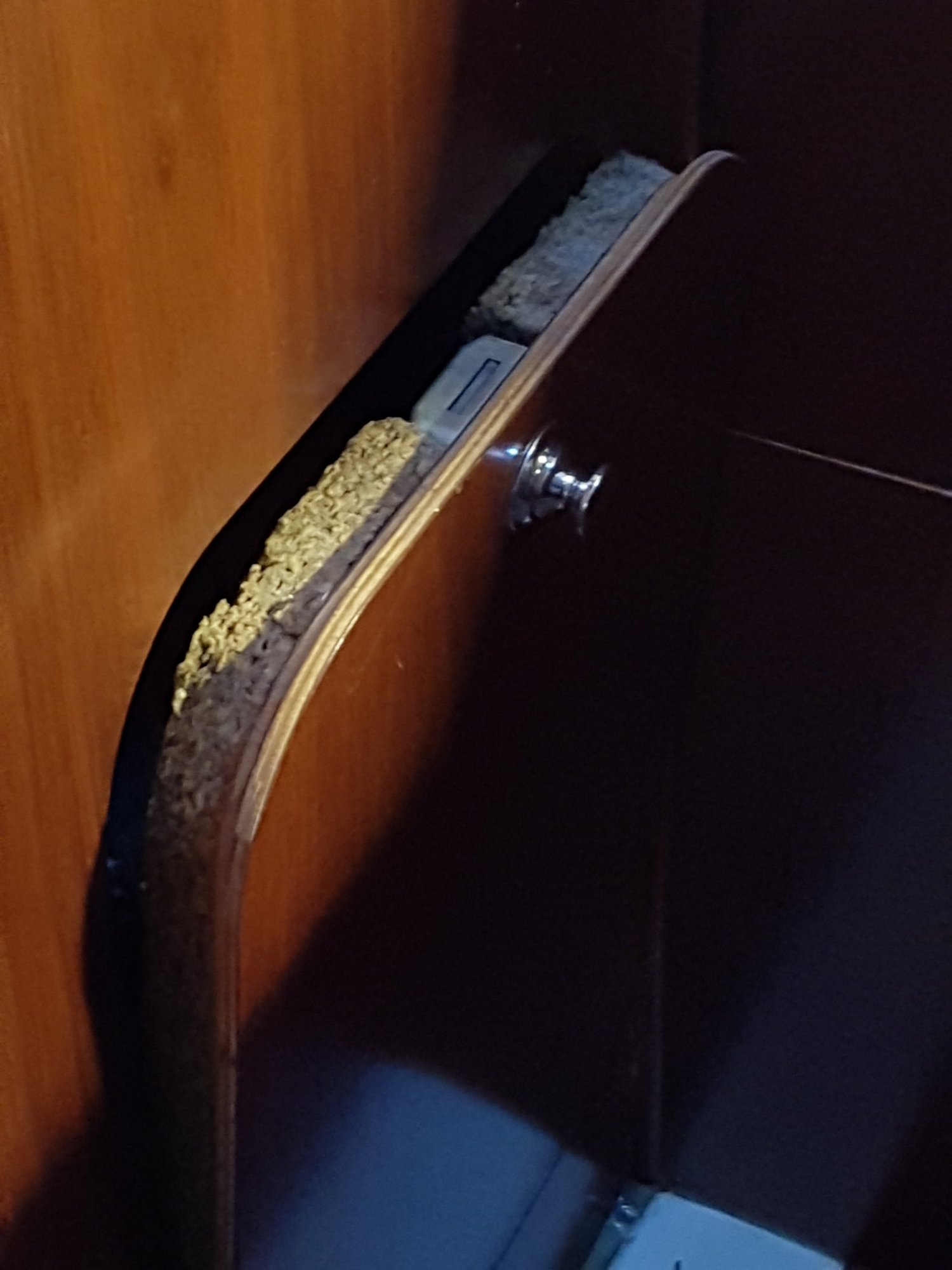

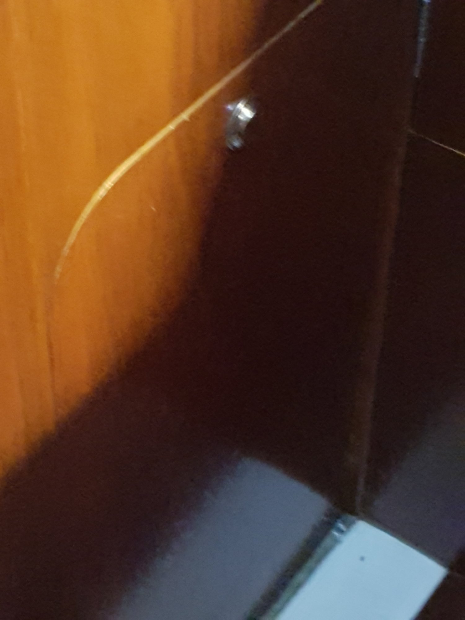

I have a Beneteau 331 two cabin model.It seems like everything I need to get to on the engine (Westerbeke 30B) is a blind reach and can't be easily accessed from either the front (under the stairs) or from the rear in the aft state room. Has anyone cut a hole through wood paneling in aft state room to access oil filter, dip stick, engine zinc, and raw water pump. Suggestions requested as I don't want to muck up the job as it is a beautiful piece of wood.
This is how I would do it.....Make a template the size you want the hole out of plywood so the template outlines the hole diameter. Install of carbide spiral router bit that pulls down not up (dust comes at you not pushed through). Using the template attached to the bulkhead with double sided tape, cut the opening starting with a plunge cut right up against the template. Finish the hole, remove the template, back block the opening, add trim to the plug you cut out to cover the kerf cut and now a hatch, install latches and now you have a access hole. The router method gives you nice clean corners. You just have to keep the bit up against the template. If you aren't familiar with routers, I recommend practicing on a piece of scrap. The thinner the bit, the smaller the kerf.
