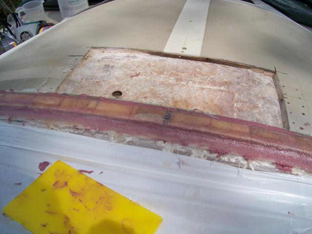

As some of you guys may remember, i started a thread called Cutta hole in my boat to discuss my problems with sagging under my mast on my 1984 Oday 26. I had to remove the outer skin and found rotten core. So I was left with a big hole in the deck. Since then I have removed most of the deck hardware and even removed almost all of the interior due to rotten everything. Now I am in the painfully slow, but satisfying task of rebuilding. I am learning as I go by reading books, using the internet, and asking questions of all the helpful folks here.

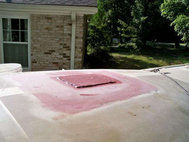

Finally, I am close to getting the deck area under the mast tabernacle completed. I patched with epoxy, end grain balsa, and fiberglass cloth, and fared with thickened epoxy. The trickiest part is trying to match the curves of the deck and maintain the proper angle where the mast mounts. To accomplish this I made a sanding block (second picture) by screwing a wide flat piece of plastic from a window blind to the deck over the cuttout area, this created a curve that matched the deck, then i layered epoxy and mat over that and when it hardened I had a curved sanding block that matched the curve of the deck.

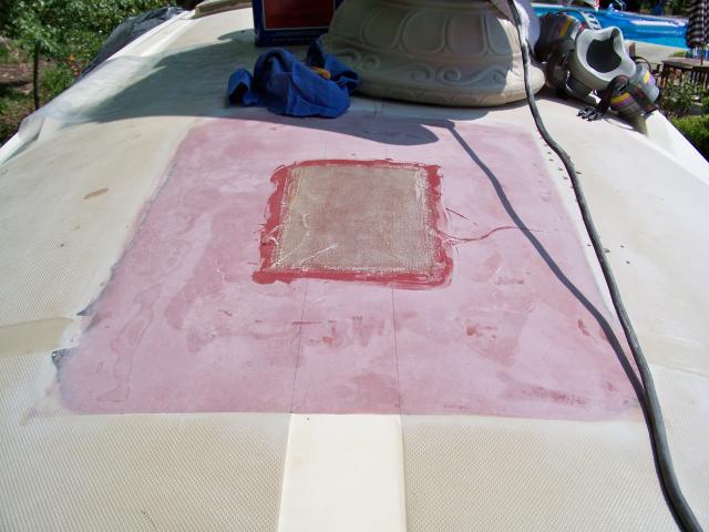

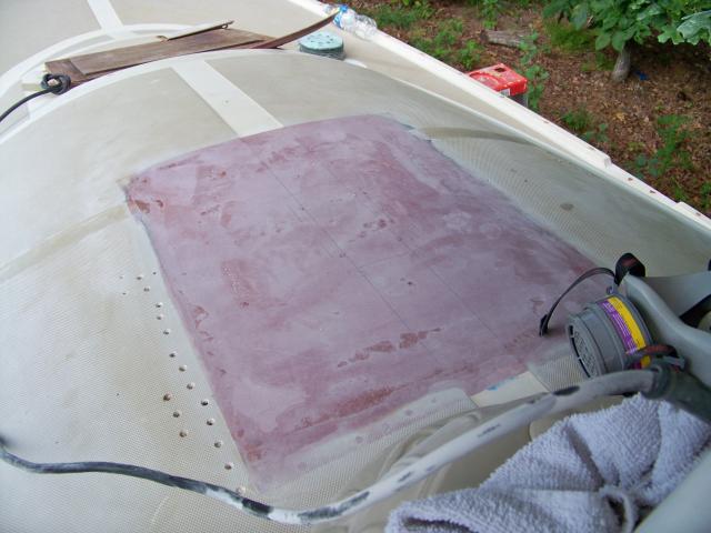

I decided to raise a small area under the mast slightly higer than the surrounding deck to try to cut down on leakeage. I wetted out a few more pieces of cloth (third picture), then layered thickend epoxy over that. Since the last picture was taken, the raised area has been sanded and the edges rounded off....it looks pretty good!
