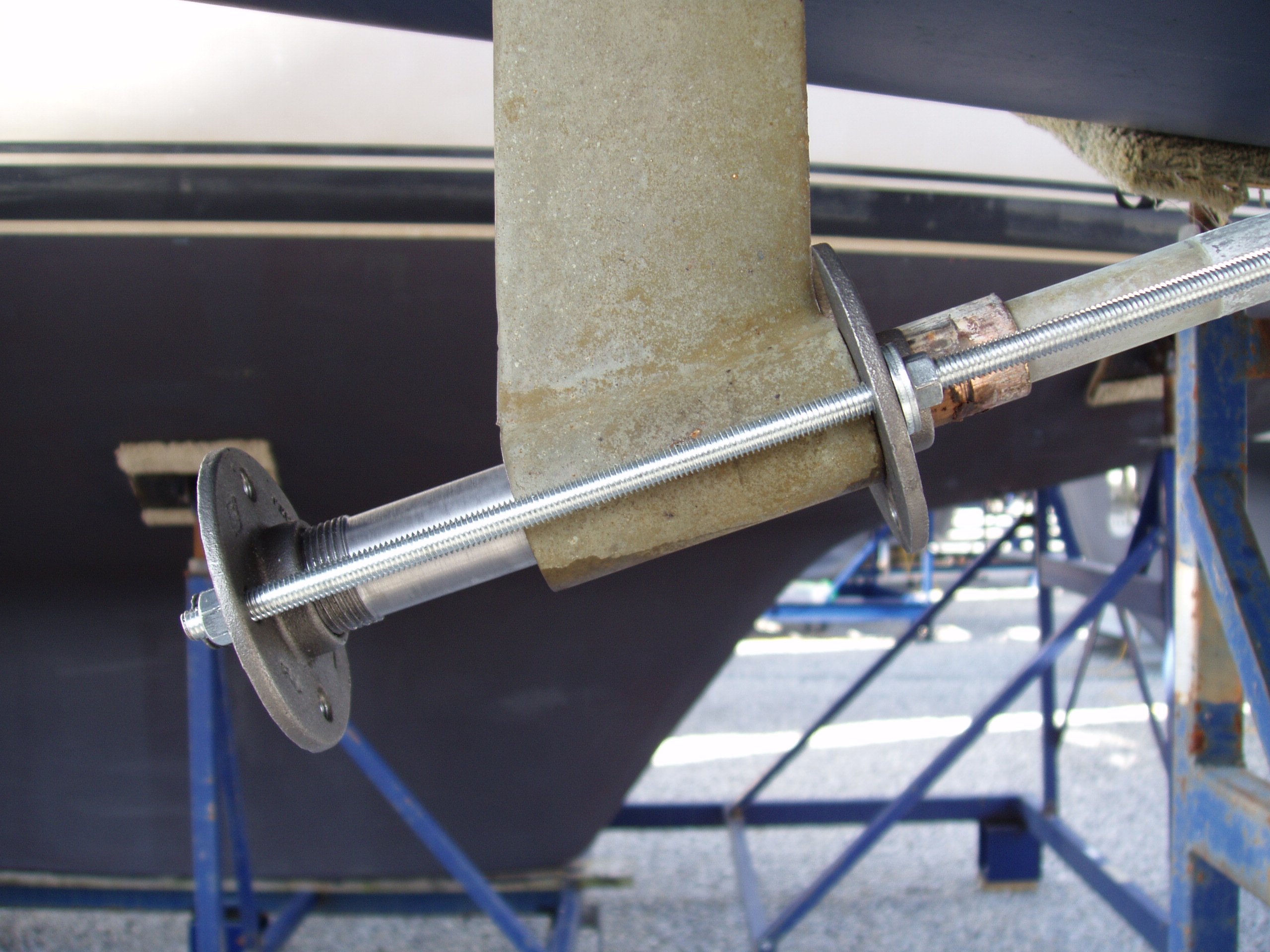

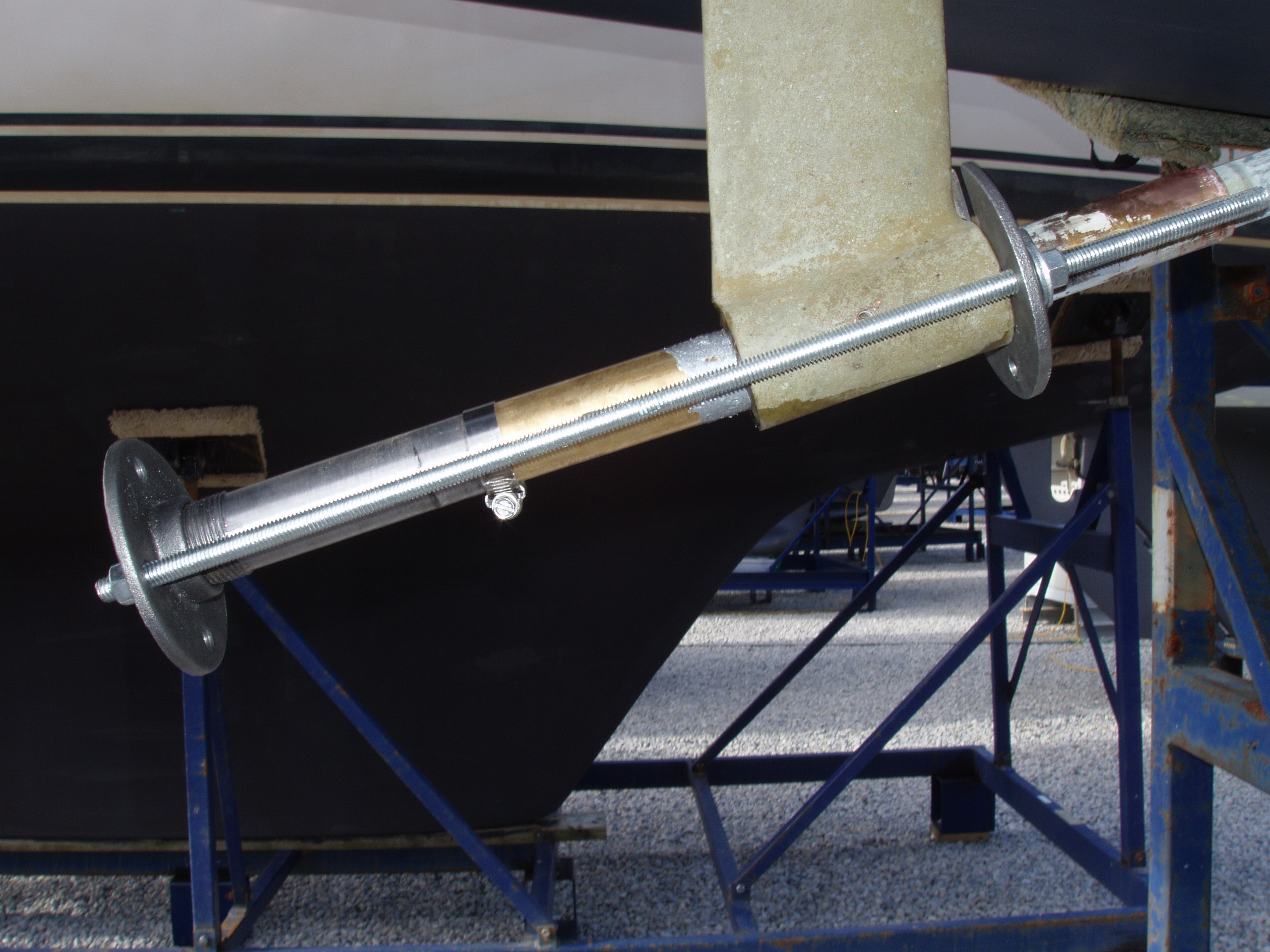

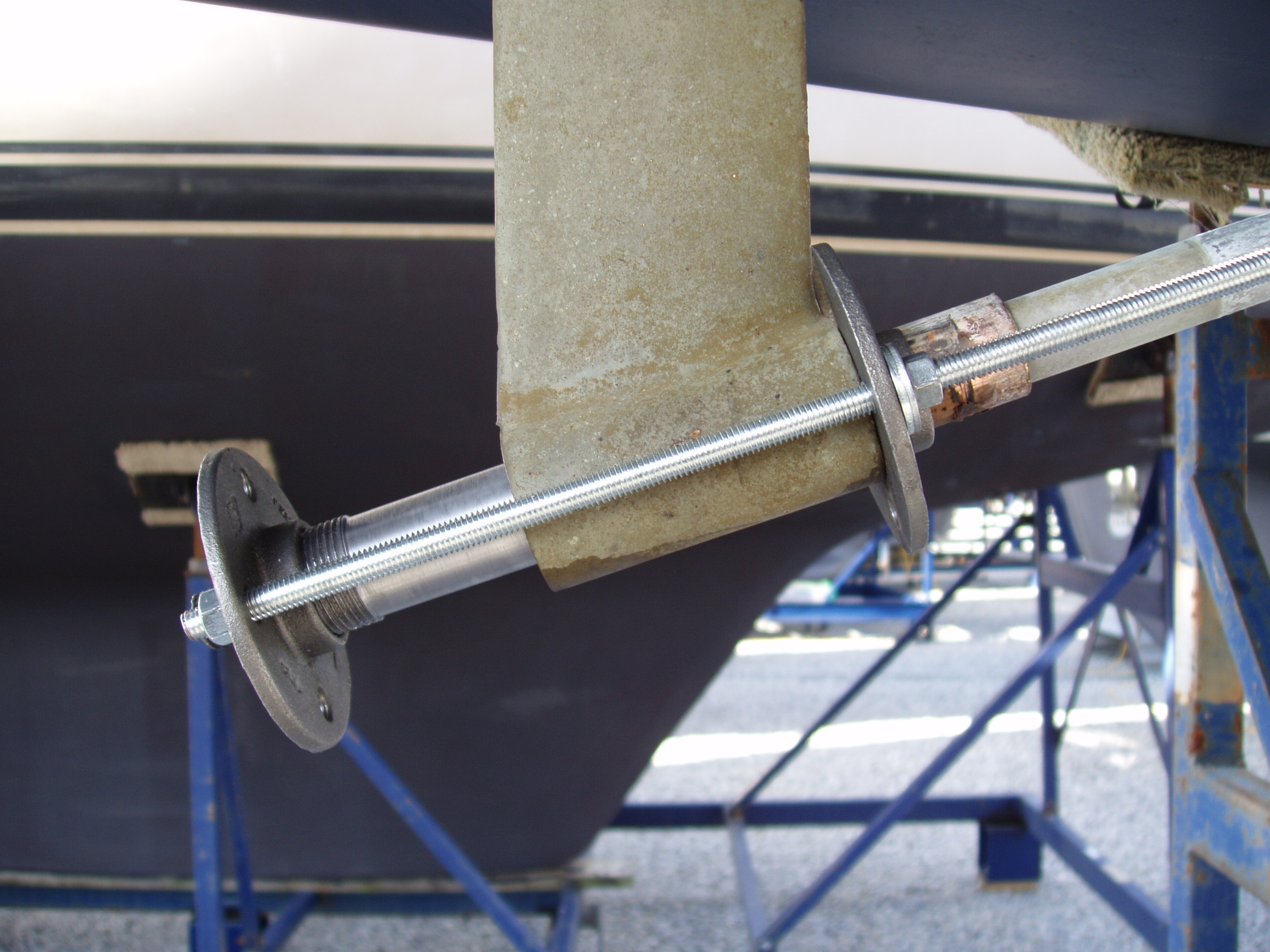

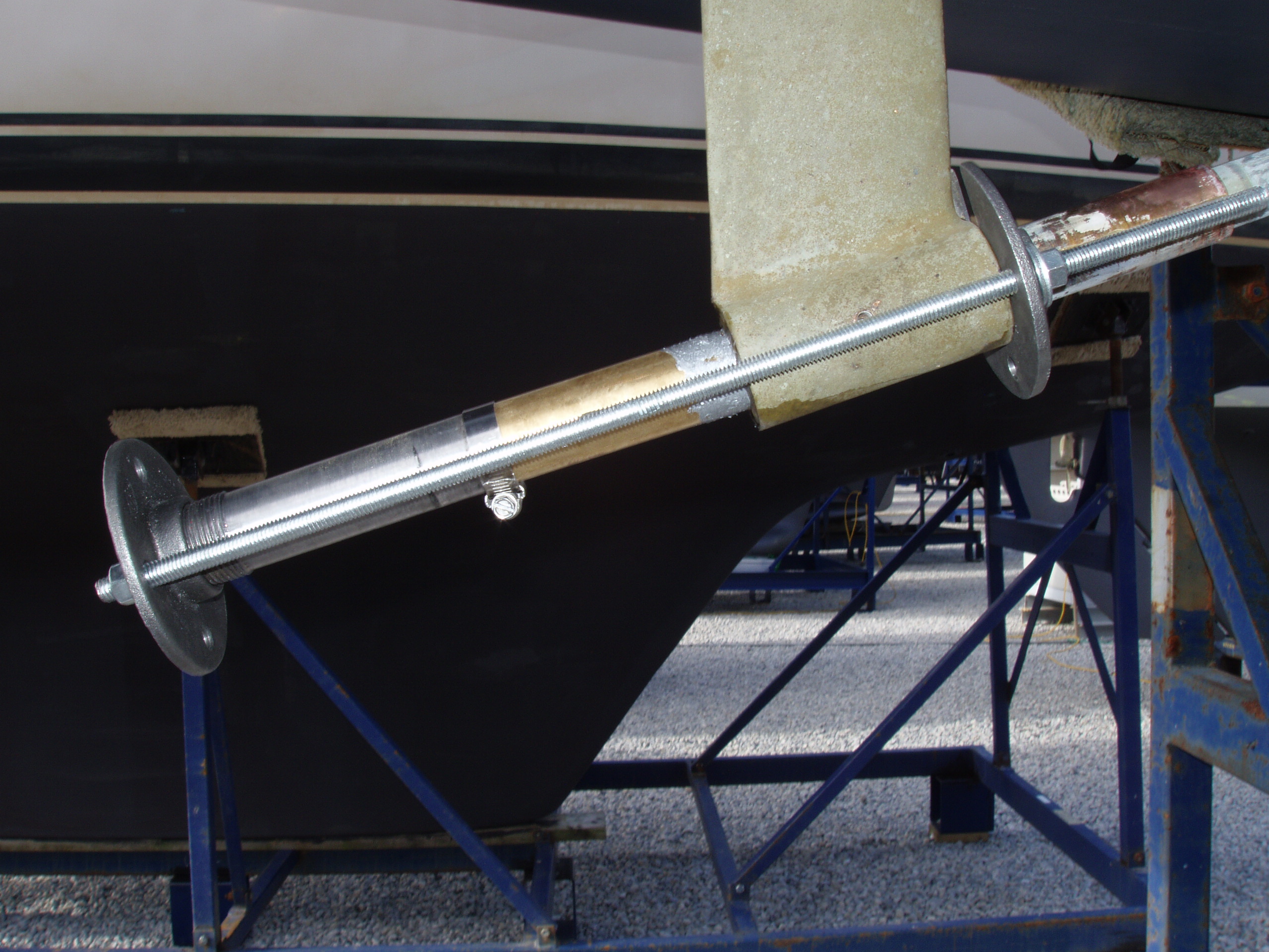

Not sure why every tool assume pushing the bearing out. Why can't you push the old bearing in and slit it open. The tube is a lot easier to make than a split tube.
These are made with black iron tube and flanges from HomeDepot. Cost next to nothing. Machine shop costed $30 to turn down the tube.

Not sure why every tool assume pushing the bearing out. Why can't you push the old bearing in and slit it open. .
. Certainly makes the tool easier to make. But I would worry about knicking the shaft trying to split the bearing. Worth a try though if you could not get the split tube.

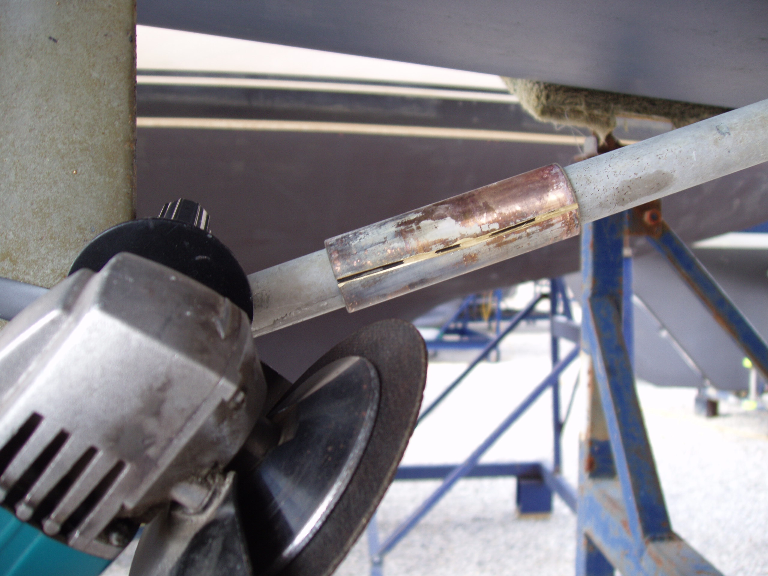

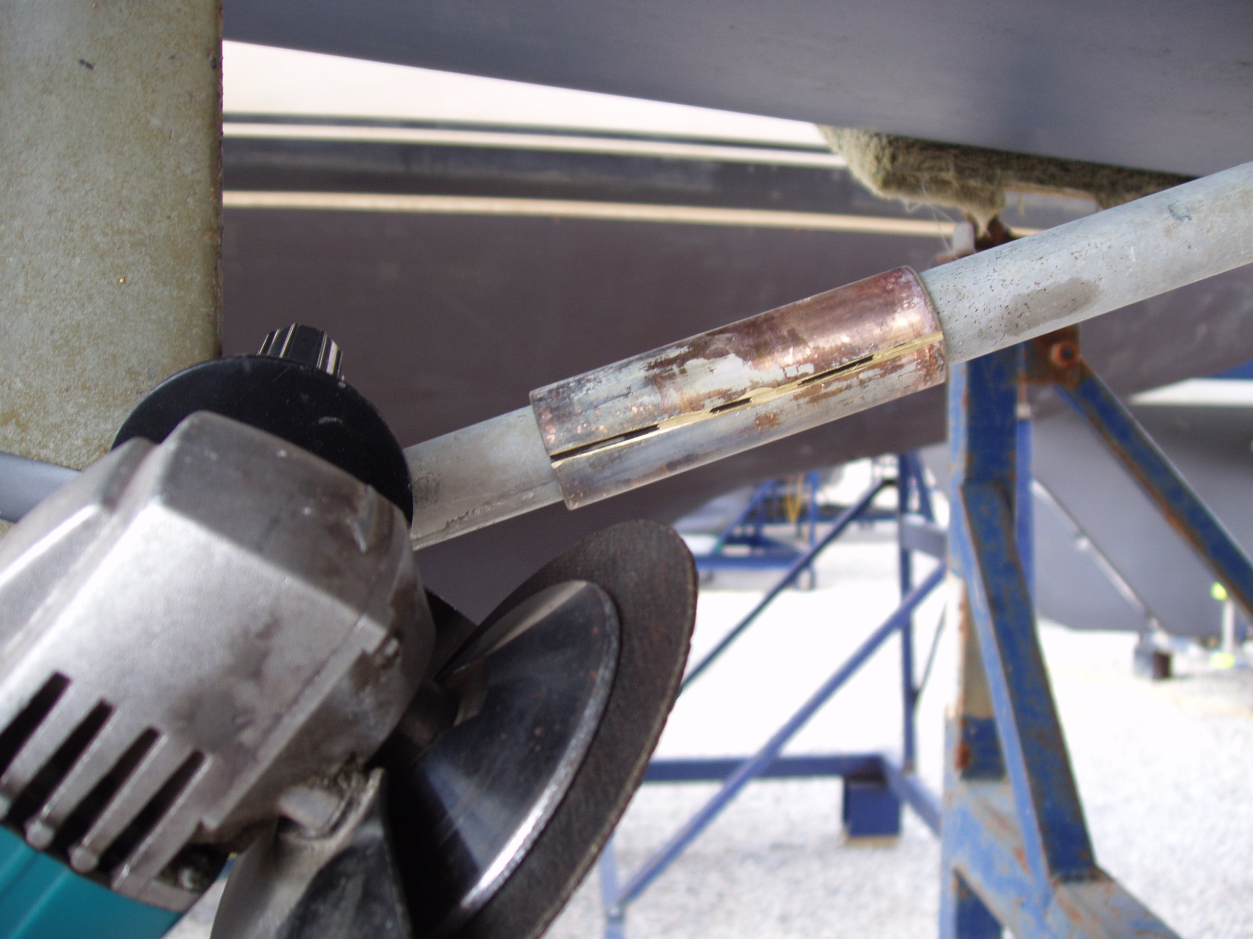

There is rubber inside the bearing. You won't nick the shaft as the rubber prevents you from it. The rubber almost 1/8" thick.
If you don't have steady hands you can always use Dremel tool with smaller disk.
I've done 3 boats so far. Not commercially, just for friends.

Al, why is the tube turned down, is it or the new bearing pushing out the old bearing? If the turned down tube pushes the bearing out, is it hard to then remove it from the strut? Bty, is that a grinding tool or a cut off wheel adapted to makita single action polisher? Would be nice to get more use out of mine.
Looks like a sweet simple system. Thanks for the tip.
The black iron pipe (from Home Depot) is slightly over sized than the inside diameter of the strut. Hence you need to turn it down to slightly smaller. You don't want it tight fit as you need to pull it back out. Never use a new bearing to push the old one out as you may damage the new one. I brought the new bearing to the machine shop as example.
I use the manufactured pipe to push the new bearing in. As you can see, to prevent it from slipping, I use a hose clamp to keep them aligned.
It is a cut off wheel. You just need to slit the bronze part. The rubber will show as soon as you are thru. Don't go further.
As for thin wall bearing, I found that the split tube is harder to make. A whole tube is stronger than a split tube. There is no need to keep the old bearing.
There is another method using saw blade but have to remove the shaft. I didn't want to do that as I have to remove the rudder as well.

I agree, a split tube can collapse, a round tube can't. Hence I designed it that way. I can make the round tube just slightly larger than the shaft and just slightly smaller then the outside diameter. There is no gap for it to collapse. Success is 100% for me even for very tightly fitted bearing. You still need to BPlast soak it first and heat it with a heat gun, but alway work.
