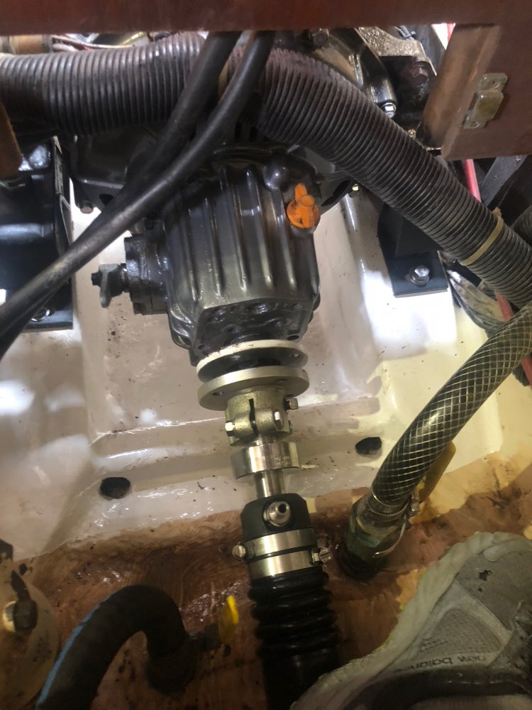

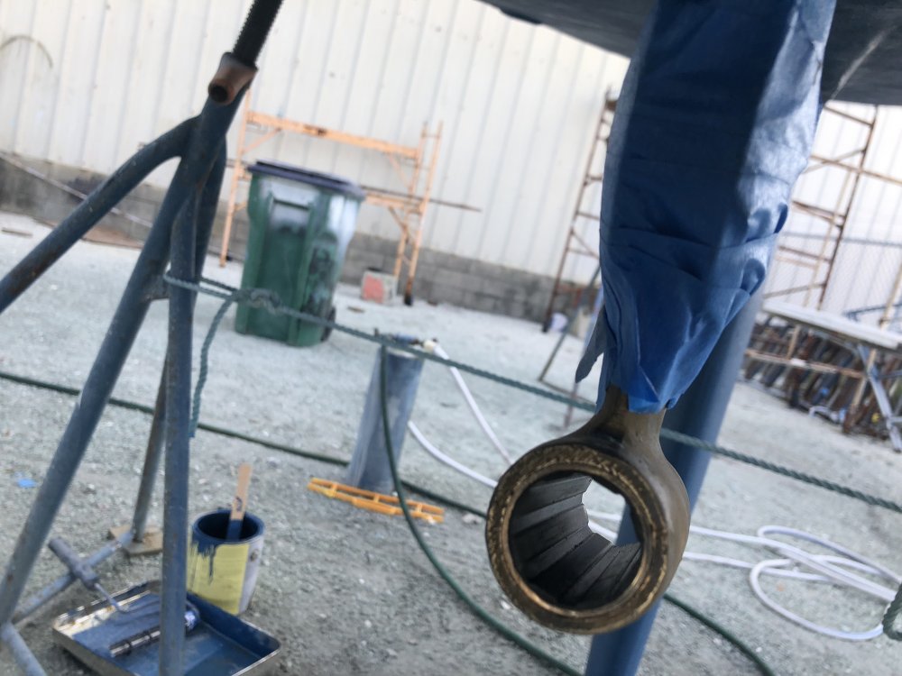

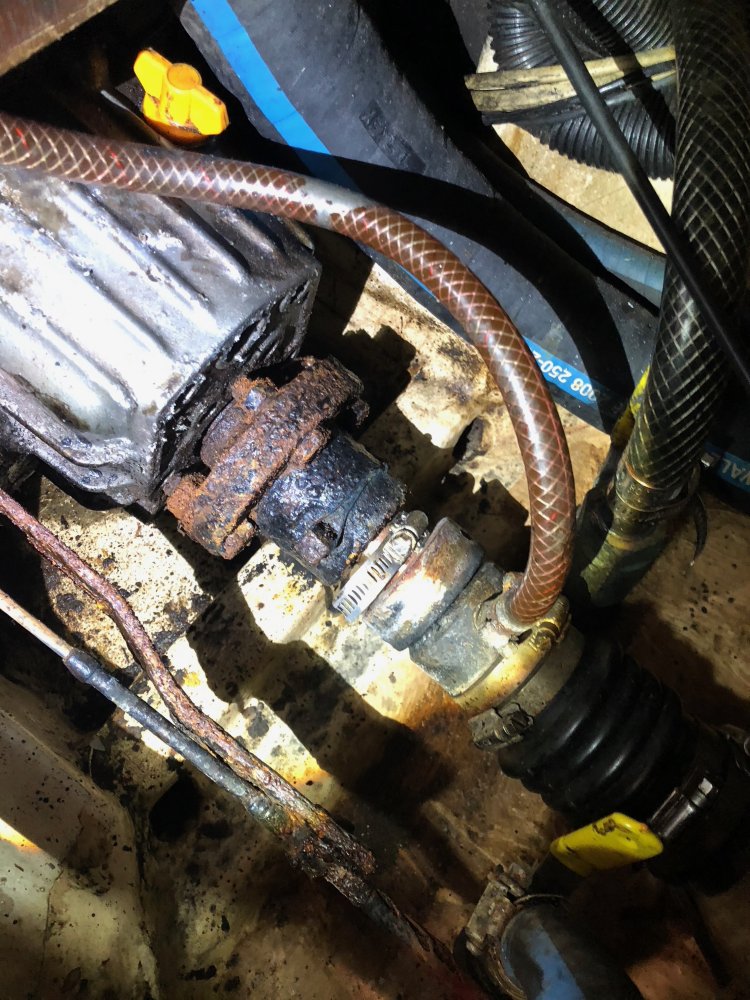

I just did both.. Good info above on the cutlas bearing. I had to pull my prop shaft anyway so I sent it to the shop and had some corrosion repairs done, got new coupling for transmission (oil seal replaced in the process) and for the shaft. Before and After, now on to Alignment. :) Let the fun begin.
Steve
