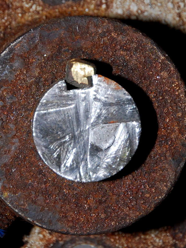

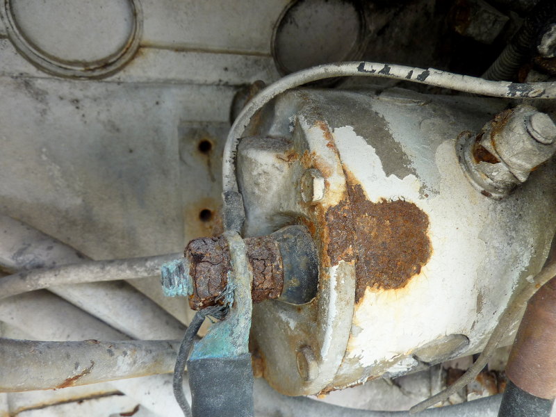

Re-use of a used coupling that had lost its fit tolerance.

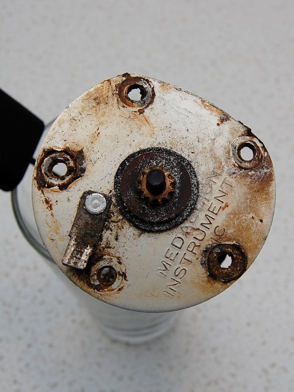

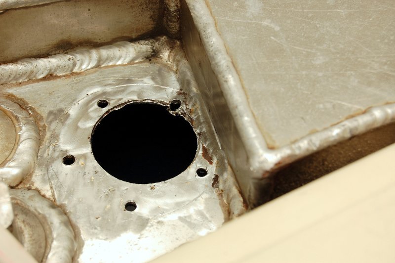

How do you suppose this sending unit kept diesel in the tank....
They even went so far as to molest the sender to "make it fit"..

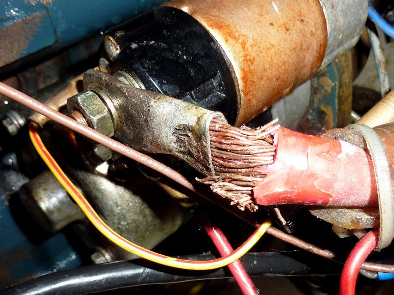

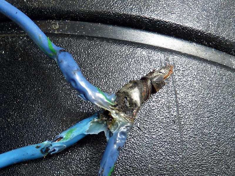

Yep the old Vise Grip crimp.....
There was a soldered terminal on here but it broke off..
What Scotch Locks are not good on boats....? Who knew...

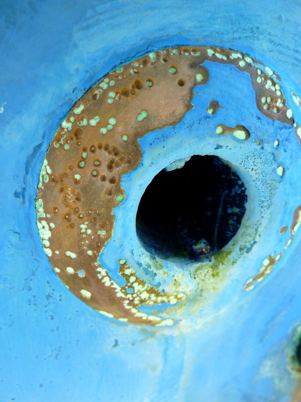

This yard employee decided it was fine to use the bonding circuit as the neg return to the battery for the 12V DC system ..... That thru-hull was installed only a few months prior to this photo being taken.

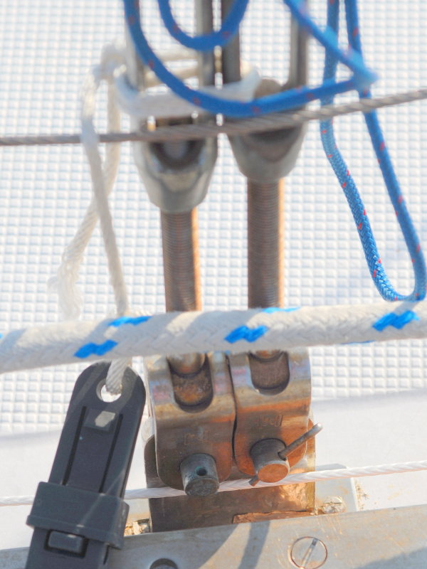

This owner was charged for rigging his boat and tuning his rig..

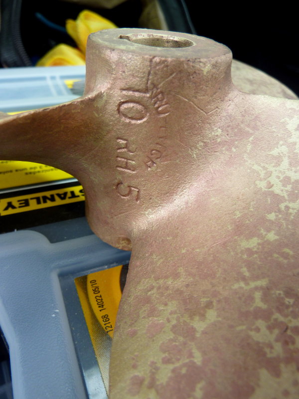

When he hauled it in the fall he found his prop, shaft and zincs all covered in copper bottom paint. They had NEVER been previously painted and the prop had been in perfect condition the year before. The prop was deemed "ruined and unusable" by two prop shops due to massive dezincification. (14 year old kid hired as summer help with no training at all)

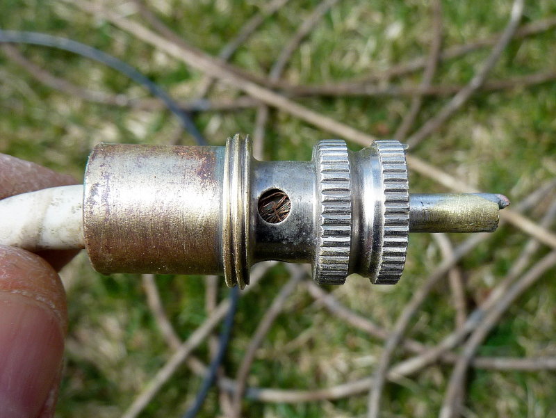

This owner was charged for a new VHF cable terminations. The shield had never been soldered just stuffed into the PL-259.. "Can't seem to make VHF calls?"... No kidding...
