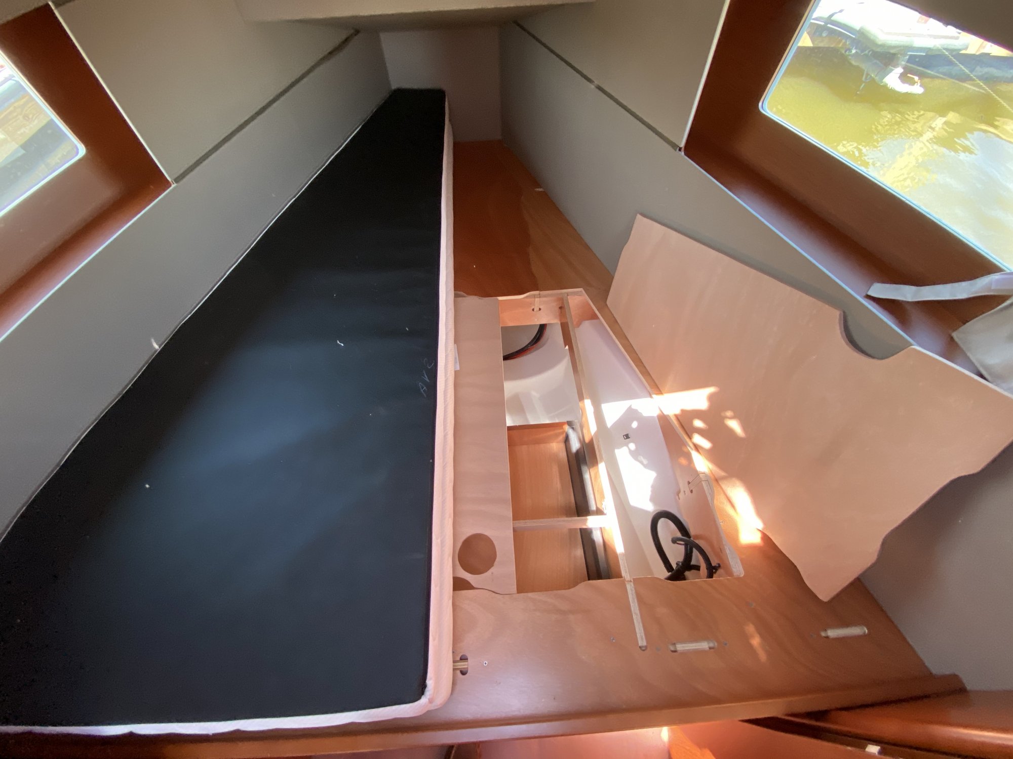

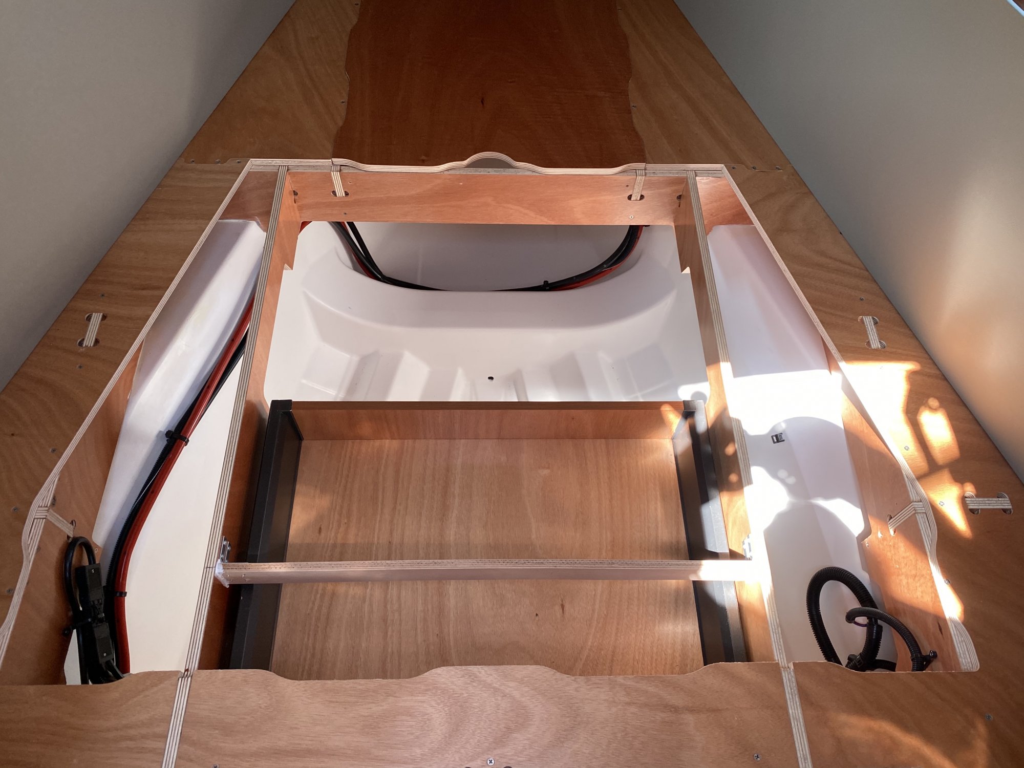

As our boat does not have the 50 gallon optional water tank in the bow, the boat has a large and unused space in the bow under the V-berth. To access this space, their is a large insert cut out from the panel under the mattresses. It is easily 5" wide and 2" wide. As it is beneath both mattresses, to access the space require removing the mattresses from the forward cabin.
I'm thinking removing the insert and cutting it into two peices, about 40%/60%. That way, I only need to flip one mattress onto the other to access the space.
Is this a reasonable thing to do, or am I overlooking something?
So, cut or not?

Will the newly cut edges have the support required to support someone laying on it? The thought experiment you need to do is: if I cut this piece 60/40, can I still lay down on it without it collapsing below. You should be able to remove the mattresses and crawl around or lay down on the plywood no matter how you alter them.

If there's not enough strength, you could add a beam under both to keep them supported.
But that's the way the boards under my C-30's vberth came from the factory. Very useful to toss all the stuff on one side to open the other side.

On the 351 it is 2 pieces , one screw permanently and the other is just a small piece to allow access to the tank port hole .The tank actually helps support the wood. I would experiment with 2 new pieces of wood and leave the original alone

i assume you mean 5 feet x 2 feet?
probably cutting it across the 5 foot length would work. Cutting it longitudinally might not work.
How thick is the board?

my 423 has storage under the mattress.... panels are half width ways and have a center beam for support.... no issues. Sure you can modify this to make it work for you.

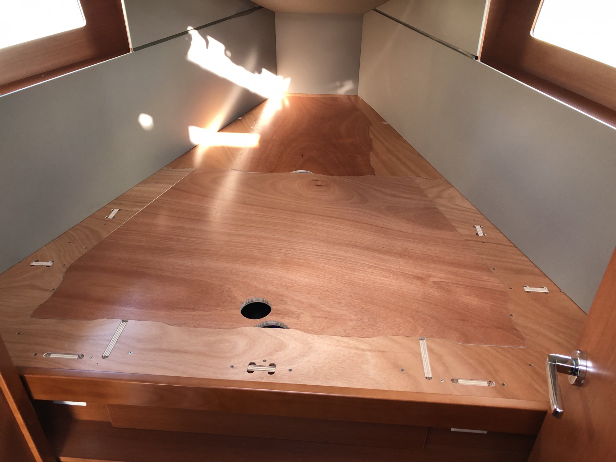

There are two access inserts and the aft one is closer to 4' by 3'. I didn't measure the forward one as it is more oddly shapped, a stubby pyramid.

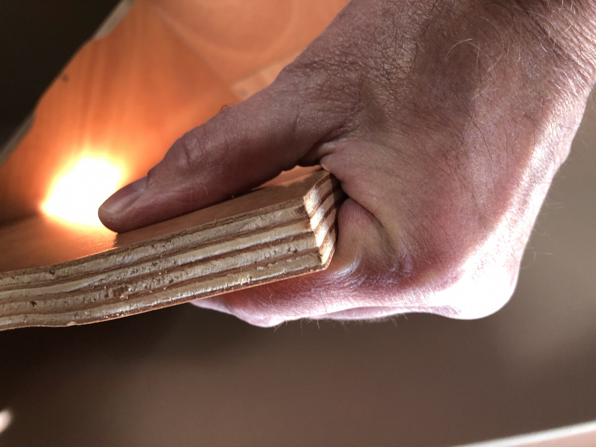

Thanks for all the good inputs. The plywood is good, nine-layer, 1/2" thick marine plywood. I am hesitant to cut it, so I will take the suggestion to make new pieces. I'll need to bring the inserts home and outline them to make templates. It would be too hard to add a fore-and-aft support under the aft insert due to the drawer under much of the space. However, the two existing fore-and-aft supports would permit me to make a port-to-starboard cut with the resulting smaller section not too hard to slip out from the two stacked mattresses.
I'm starting to think the forward space is too difficult to access. Since there is no seperator between the two spaces, I could put rarely accessed items in there and get to them from the opening in the aft insert. Maybe just work on the aft access for now.

With that drawer I. There, I would think it really limits your use of the space around it...you don’t want something getting under or stuck around the drawer.

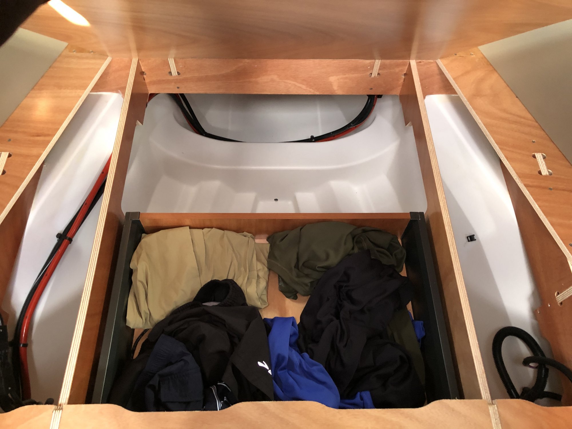

Is that a pull out drawer or a box that just sits in the space?
Dr. D
Nov 3, 2018
288
Beneteau Oceanis 35.1 Herrington Harbour North
It is a pull out drawer. Good size.
24,503
Put 1/4” side panels on your drawer space then you can use the vertical space on the sides for additional storage. As they say “box in your drawers”.

It looks like you could put a support towards the bow where it would be behind the drawer and then do the wavy cut joint over the support to allow the both parts of the insert to be supported. Assuming the drawer in your photo is fully inserted it would appear to give you a 60/40 split of the larger insert.

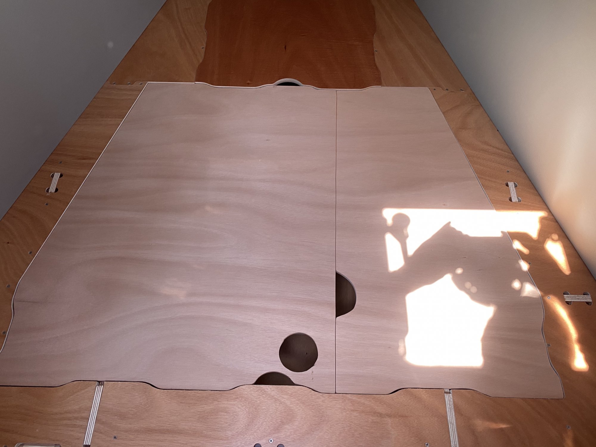

Thanks for all the inputs. I got the job done today. I picked up marine plywood from
Chesapeake Light Craft ( if I spend too much time there I will buy a small boat kit). Traced the orginial piece and cut away. I think this will work. The access to the space below the drawer is better than the pictures make it appear.
