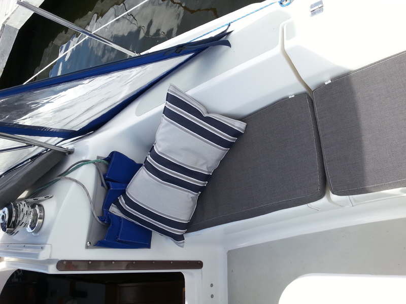

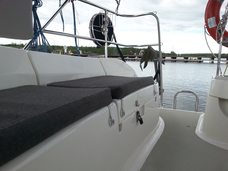

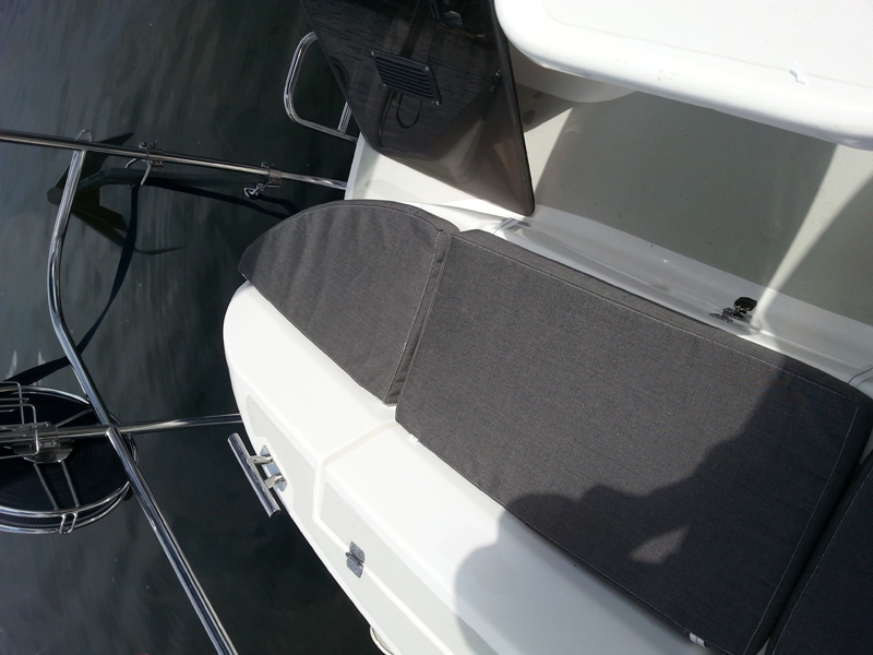

I am using sunbrella covered cockpit cushions with dryfast foam. No problems whatsoever and personally I prefer them over vinyl as you do not "stick" to them after sitting for some time and they are more comfortable. Yes, they may be little bit more difficult to clean, but we did not have to do that yet. No land shoes on the boat helps with that ;-)
