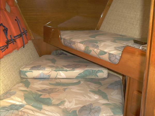

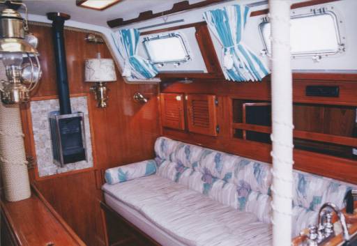

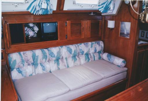

Jorge, just use the "Search" tab for "cushions upholstery". Lots of good reading with sources of the foam, best kind of foam and covering, etc. Maybe something like the attached pictures, Capt. Sanders' or the suede?

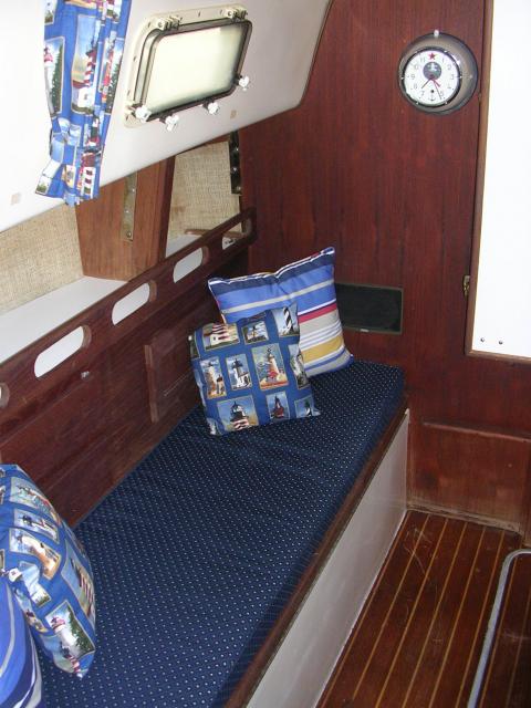

My boat had been reupholstered by the previous owner's wife just before I bought it. Would not have been my choice of fabric colors but is comfortable and has served very well. I use one of those foam egg crate pads under the v-berth cushions. Even these old bones sleep well there.

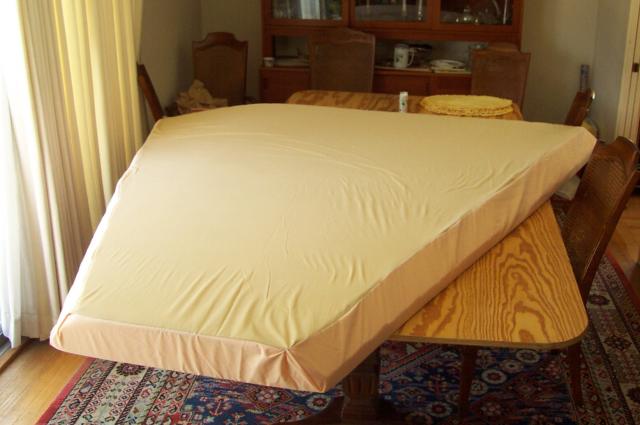

We created a mattress by taking a stock rectangular piece of foam, cutting two triangles of the foot end and gluing them on the head end.
An electric meat carving knife works well for cutting and trimming foam because the blades move in opposite directions and cut instead of compressing. The glue for the foam was in an aerosol can and sprayed on.
The absence of joins and the fact that the mattress fits snugly into the vee berth makes for a great bed.

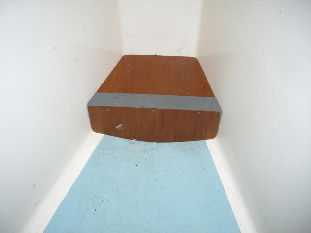

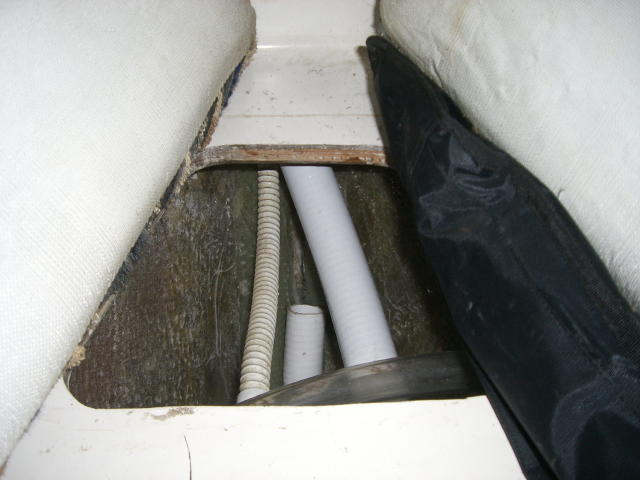

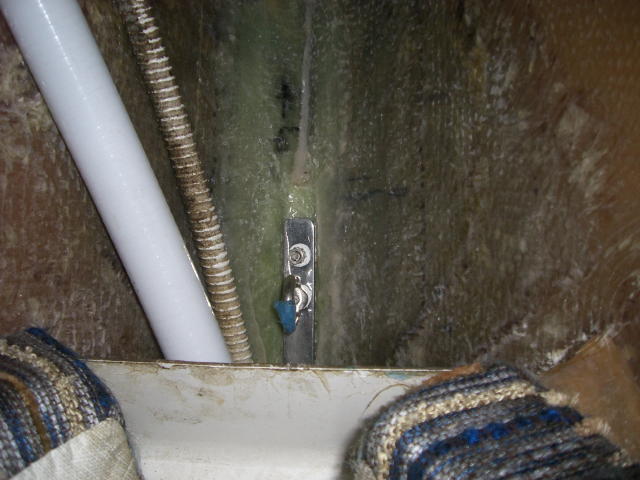

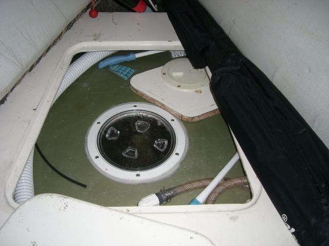

The round cover is an access/inspection port to the fill and vent hoses for the water tank. I pulled out that panel when I fiberglassed inside the hull for the bob-stay tang I mounted. The space made available became the preferred stoeage place for extra life jackets.
Pictures show:
Area just inside bow, now used for stowage.
8" access/cleaning port cut into water tank.
Larger access area cut into V berth surface to allow better access while I was Adding fiberglass reinforcement tot the bow.
These are all good reasons to keep the cushions as two pieces or even four.

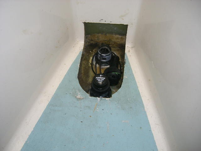

Jorge;
You asked for pictures, so as long as I'm in the bow, here is how I mounted my depth and speed transducers.

Sam, I'm trying to figure out the 2 pictures you sent me:(the depth and speed transducers...)
Is that the anchor locker?

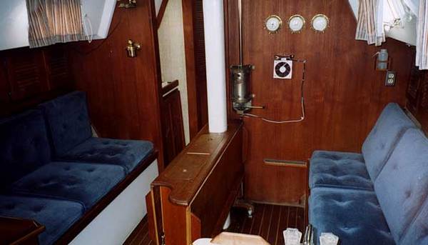

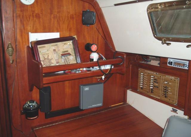

Just noticed your compass mounted on the wall in the navigation room: how did you secure it?
Can you take a closer photo, or can you tell me what you did?
Small thing, but I like it, I have a few of those compasses
