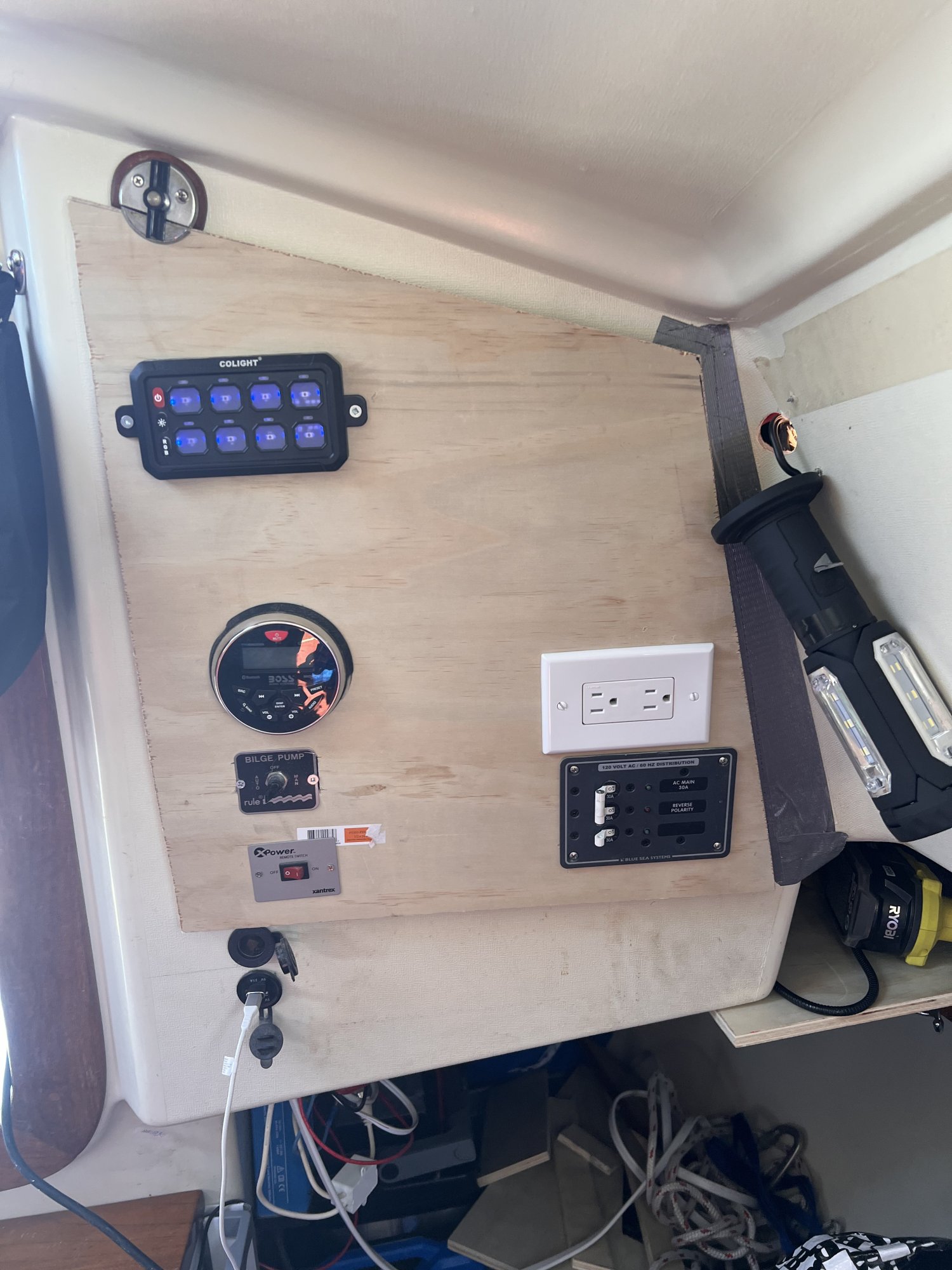

Ok, so time went by and I did a few things, still a work in progress, I will take pics next time I am on the boat, but so far…
I took the 2 golf cart batteries from the starboard lazarette and installed them on then port side quarter berth/storage area, they fit very nicely and are very secure there, this does 2 things, it frees up some nice room in the lazarette and helps keep the boat sitting straight, it was listing to starboard with the batteries and the fridge( too much beer).
moved the electrical panel to port as well, made a simple plywood panel for now, looks nicer than before, added the bilge switch, the inverter switch, radio (am/fm) switch panel, AC breaker panel and AC plug, later I will also add the vhf to the panel
not finished yet, the main part of the wiring is complete, just need to wire the mast lights and pass AC wire to the old plugs (add a junction box where the old panel was).
I mounted the inverter this afternoon, will wire it over the weekend.
Going to wait and get a 12 gang switch panel.
still a work in progress.
Will update once I do more.
