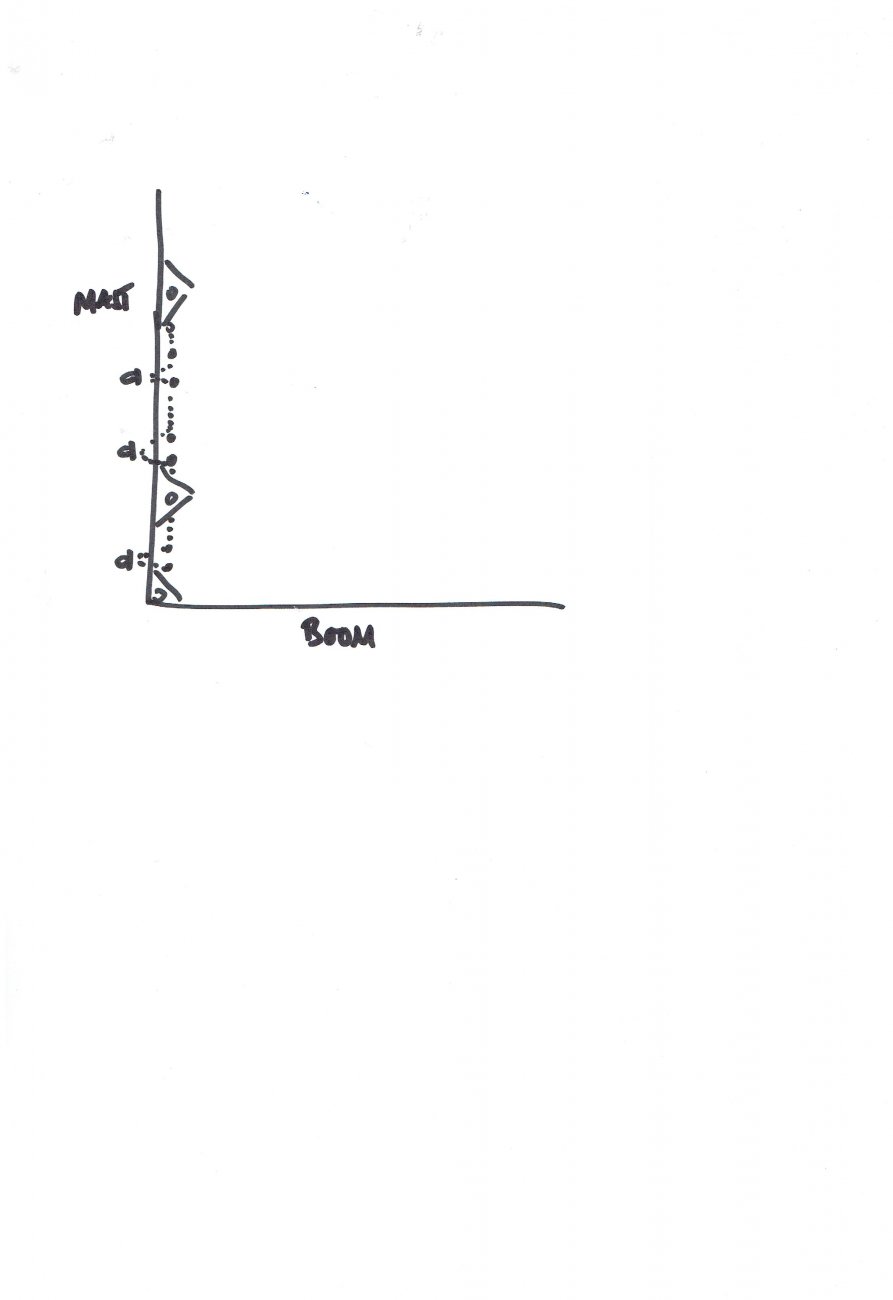

Looking at my mainsail recently I noticed that many slides on the sail are being held by a line on the lower section of the sail. Thinking this as jerry rigged, I purchased some extra slides and slide shackles. Took some time this weekend to review and perhaps replace when I realized it seems like this line with the slides in place is exactly how it should be. I have no experince with this set up. My immediate thoughts are that is helps to lay the sail flatter at the cunningham rings when the sail is reefed and flaked. I hope I've been able to explain the set up and can someone confirm my theory or tell me I've got it wrong and explain what its all for?

((To explain my Van Gogh of a drawing, the large circles are the cringles, the 3 pairs of larger black dots are the collets that the line runs through. Each pair of collets has the line run through holding a slide. The small dotted line with the slides (drawn in reverse of how they mount) is the line (rope) in question. ))

Nice drawing Robert. Can you post a picture of how the lines are run? Are there holes in the sail? Are the lines only at the luff?
Only on the luff, only below the highest reefing cringle of which i have two for reefing and down, one at the base of the luff.
There are 3 or four pairs of collets, the line runs through the collets, between each pair, the line holds a sleeve.

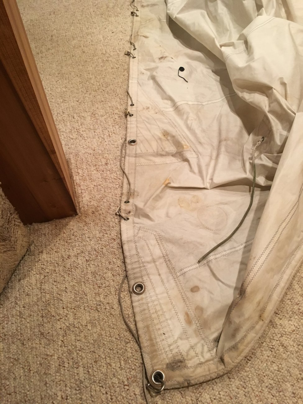

Well gosh darn it, I've learnt something again. Stu is spot on. That exactly what I've got, but my sail is much dirtier (HA HA).
Thanks Stu, you really came through. Very good video. Thanks. Oh and jury or jerry.......mmm, quite interesting.

Have that as well. Also you should use a cam cleat on the mast just below the boom to tension the jack line after raising or reefing the sail. When reefing just grab the jack line near the bottom of the reefed sail and tension while inserting into cam cleat. Simple to use and shapes the sail nicely at the bottom. Jack line end should be loosely tied at the sail tack until the halyard is tensioned and tied off. Then tension the jack line by pulling down by hand and place in the cam cleat.

Keeps the lower luff tight against the mast even when the slides are piled up due to reefing, but you need the cam cleat on the mast.

@RoyS it sounds like you are using the 'jack lines' as a Cunningham or downhaul to tighten the mainsail luff. From the size of the lines I see being used in the video or the picture by @twodzusfittings I would think the lines are not designed for that purpose. The 'jack lines' appear to be designed to just capture the sail slugs when the sail is dropped and the bottom slugs fall out of the mast track. The sail image shows two cringles that would be used to tighten the sail luff with a proper sized line.
Am I missing something?

In my case the reefed sail lower slides do not fall out of the mast slot. They do stack up at the bottom. When reefing the appropriate cringle is placed on a hook on the boom and the halyard is tightened. Lastly the jack line is pulled down and clipped into the cam cleat. This last action draws the luff snugly against the mast. Even the stacked up slides are applying this force. The downward force, applied with your fingers, is minimal and the jackline is not under much strain. I would supply a photo but I am away for a few weeks.
