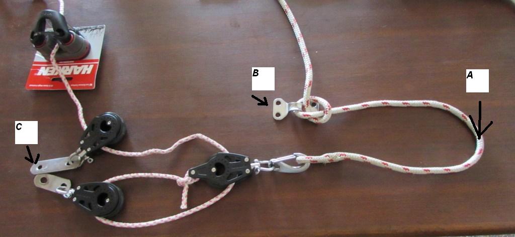

I wont visit the boat for a couple months so cant install this yet but have the plan in place. My main sail fortunately already had the cringle (hole) for the cunningham. What I have shown below should be set up for 8:1 leverage and Im thinking it will all be 5/16 line. The blocks I plan to use are all Harken 40mm (available on this web site). The first two pictures show about what Im thinking. In the first picture "A" is the cringle and you can see the corresponding spot A in the second picture (just the line running through the cringle on the sail - no block). The point "B" is on the mast and I will drill a 1/4 inch hole through the mast at this point and install the bolt "B" shown in the second picture. "C" is at the base to hold a block that will route the line back to the cockpit.
Since this boat is used as a trailer sailor, I always try for fast setup. When trailered, the boom/main sail is removed from the mast so I will have to install the cunningham each time I rig. In the picture below is a loop sewn on the end of the line that goes through the cringle and once through, the loop simply fits over the fender washer on the area "B" shown on the mast. There will be a spacer between the fender washer and the mast to allow for the loop. The loop is sewn so that its real snug going over the washer so I think it will both stay in place plus be fast to assemble.

I don't see the 8:1 purchase. But that's okay, because you don't need that much... unless you're trying to bend the mast also, which is a common function on beach cats or racing dinghies with no backstay.
Okay.,.. here's my suggestion. NO through bolt. Overkill. A small horn cleat on port side will anchor the cascade line.
Next... replace the cascade line with 3/16 dyneema.... splice an eye in one end only... whip the straight end... The dyneema is super strong and will glide through the cringle easily.
Keep the top block.. single with becket .. replace the two singles with a double and attach to the deck at the "C" location. You can increase purchase if you want... but you really shouldn't need any thing more than 3:1 .or 4:1
You can also add a small bullet lead or eyestrap to the mast on starboard side, opposite the horn cleat, to bring the cascade line forward, if you like. But I'd wait to see how the system works first. You don't want the blocks rubbing or banging on the mast.
So the entire assemble can stay on deck when the mast is down... or simply unclipped at the bottom block to remove. When you set up... you clip the lower double to deck.. the tackle should stay below the boom... then run the dyneema up through the cringle and tie off to the horn cleat on port side.
Finally, use the smallest blocks you can find that are rated for 5/16.
Additional comment: if you choose, you can use this line to secure tack for reefing. That's what I do on my 27 footer. Rather than a cascade through the cringle... there is a metal reefing hook on a pendant.. attached to the purchase tackle the same as the cascade pendant.

Joe, many thanks for the response. Yep.. I didnt know how much pull I will need so I picked the setup I used from a picture I found doing an internet search. Lots of good ideas there, I will also look into that 3/16 Dynema.
I really like this idea!

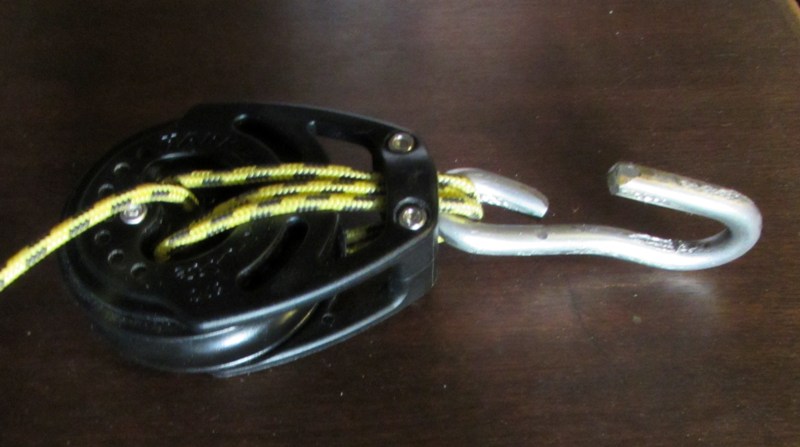

Interesting also the idea to use cunningham also as a reefing hook. I made the pulley and hook in the picture below from looking at another picture off the internet thinking this would solve the easy setup for trailering but decided not to use it. But this hook and pulley could also work like you mentioned for the reefing and I could get rid of some other hardware.

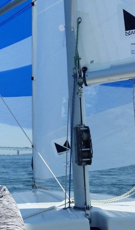

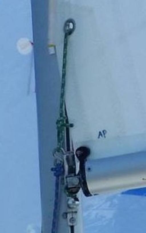

From a Flying Scott.. another idea for quick setup for trailering. The cascade line looks to have a permanent connect to the mast and the loop fits through the sail cringle.

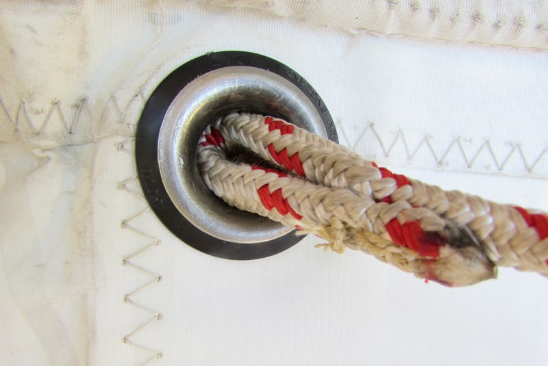

For small boat there is no need for 8:1 or even 4:1 on a Cunningham. A very simple 2:1 can be made (a variation of Walt's post) like this: loop the line though the Cunningham eye and back down to the tack cringle. Push it through and put a stopper knot in it. Easy 2:1 with minimal hardware. A bonus; it never falls out!

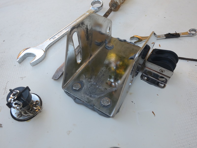

I visited the boat this last week and implemented the 4:1 version of the cunningham shown in post #11 which at least in the back yard seems like it will work well. Still have not tried it out. I like those wide angle fairleads because I often single hand sail this boat so generally need to run the controls from either side of the boat. Most of the setup remains on the boat for trailering. Setup is very quick, just feed a line with a loop on the end through the cringle on the sail and clip to the cunningham pulley assy.
Thanks again to SBO as this site is the best forum I am aware of for posting pictures
Picture below - the new cunningham cleat is on the left. The upper cleat on the right is for the jib inside sheet and under the jib cleat is the centerboard cleat.
