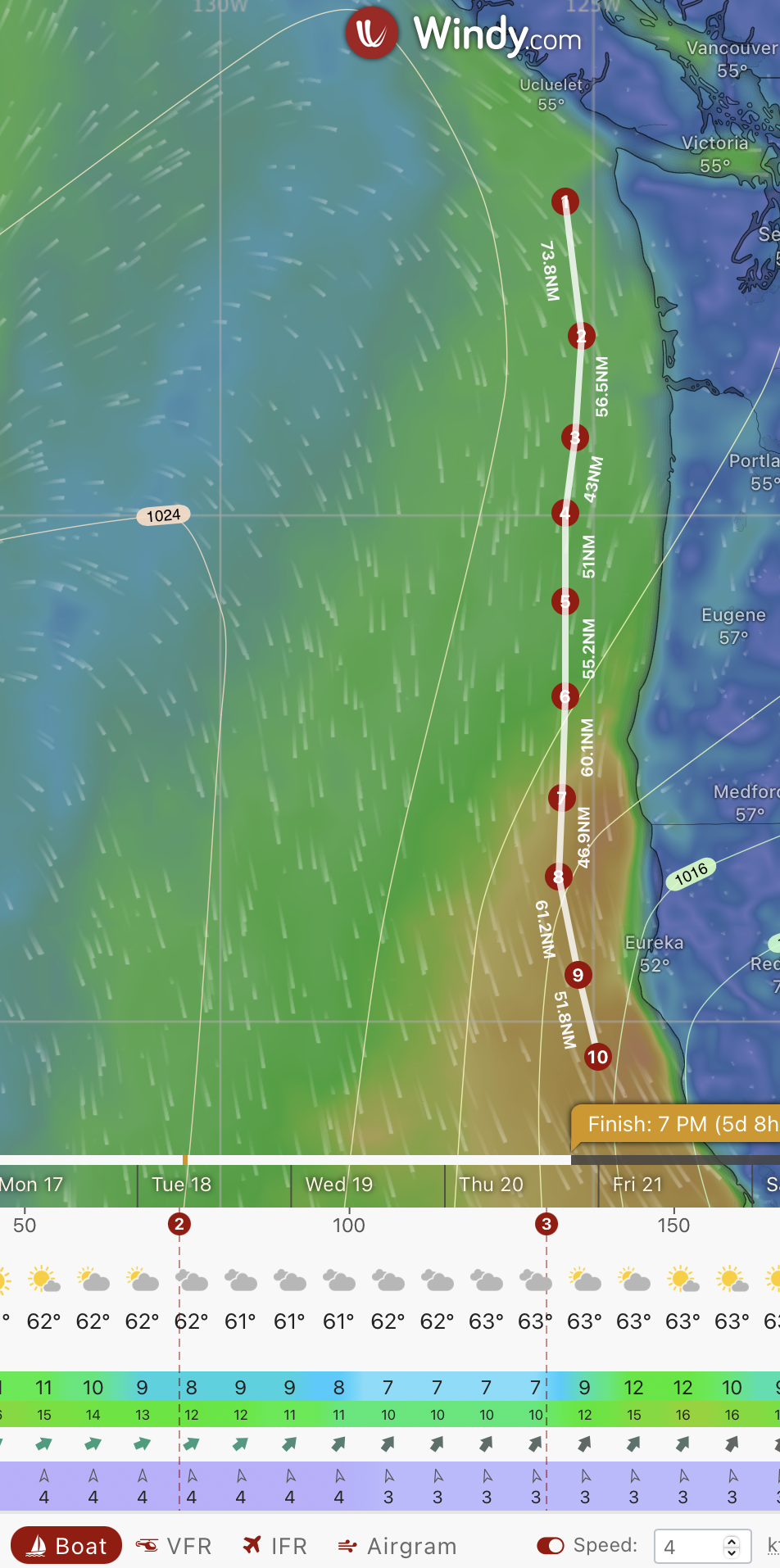

what is your expected VMG assuming at least minimal crew (2-3) in a 45-ft yacht? Say, route from Cape Flattery to Cabo San Lucas or Southern California to Oahu, etc.
You can do this very easily with Windy.com
It will compute VMG and forecast in front of you.
I set 4 knot speed in this example, but you can change your route too to maximize VMG.
We are helping @dLj cross the Atlantic, so far his 41 foot boat is half his theoretical Hull Speed or 4 knots.
