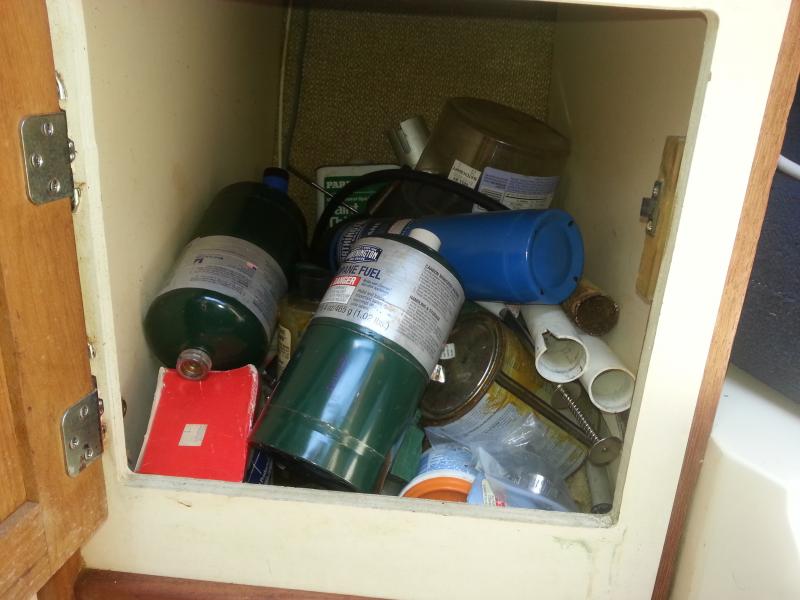

I guess you see the quart of paint thinner in the back. That's trinitrotoluene in the box below it..
