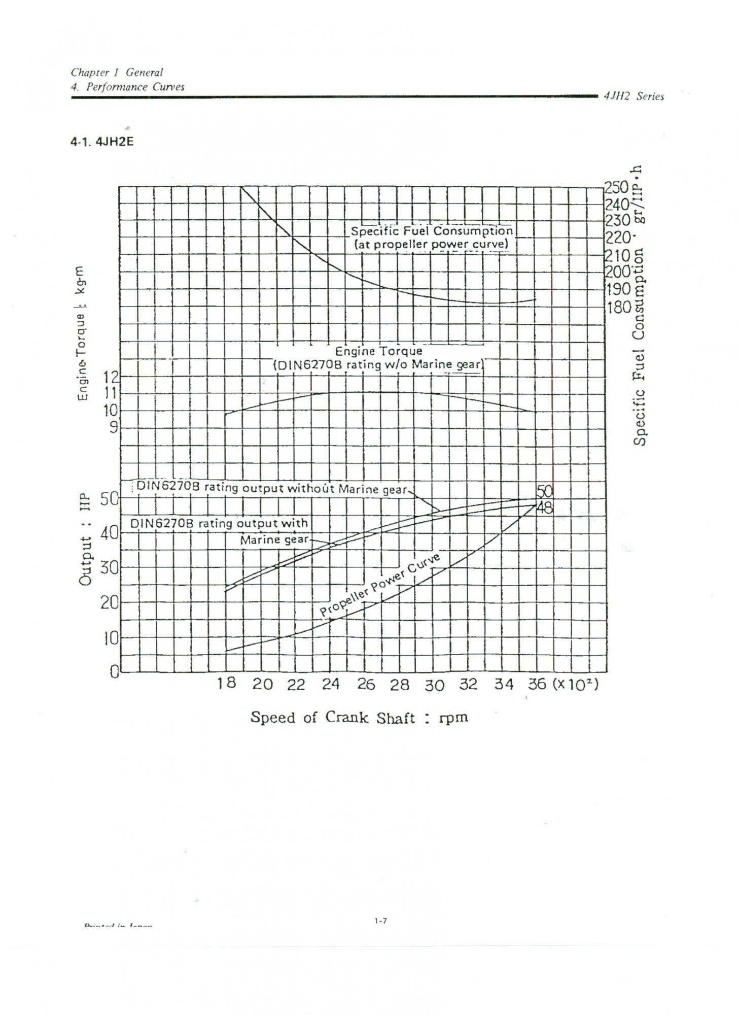

Here are the power curves for the 4JH2E, which is the diesel in my 40.5. I am not sure yet what to make of it but am attempting to get smarter on its meaning. It seems to show that the Engine Torque without Marine Gear is relatively flat and at its highest from 2400 to 3000 rpm. IF the "best" point in operation is to operate at the max on the torque curve then that would suggest that optimum operating RPM from an engine load standpoint would be between 2400 (67%) to 3000 (83%). That is a big IF though since it is withouh marine gear and I am not sure how the marine gear impact that torque curve. Assuming the addition of the marine gear impacts the torque curve the same way it impacts the rating HP output it would shift it a little right. However, that is only an assumption right now. The torque curve is surprisingly "flat" over a wide range so @Don Lucas operating range doesn't look like it would do any harm at all (IF operating at the torque peak is the desired range).
Using the Specific Fuel Consumption and the Propeller Power Curve and crunching the numbers it shows what we expect. At 2200 rpm the fuel consumption is .75 gph. At 2400 rpm, the fuel consumption is .89 gph. At 2700 rpm the fuel consumption is 1.18 gph (which is pretty close to what I am observing on my boat with a clean hull and prop.} At 3000 rpm, the fuel consumption is all the way up to 1.57 gph and at 3400, the "continuous operating limit" it jumps all the way to 2.24 gph :yikes:. The real thing to consider is the speed for your boat at various rpms what this translates to in nm/fuel consumed.
Next time I go out in calm weather with no current I plan on plotting speed vs rpm to generate my boat specific fuel consumption and effeciency
The question that is probably specific to your boat and how you use it is what speed you do at each of these RPMs and which is more important, maximum range and minimum fuel consumption or higher speed (shortening the transit) and accepting the higher fuel consumption.
