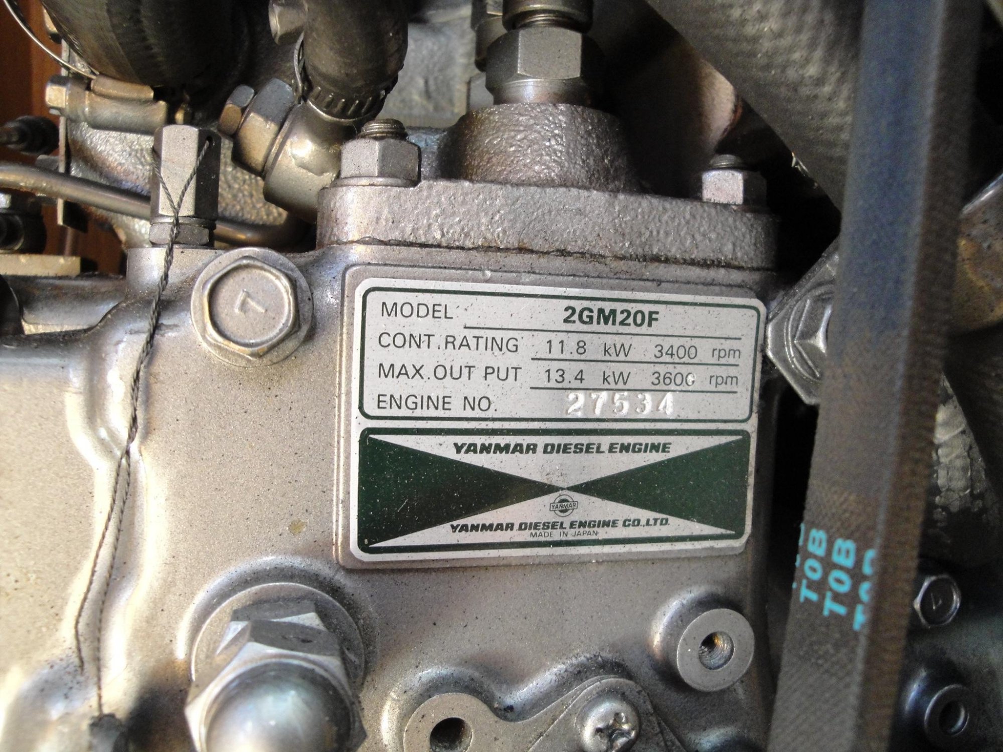

Jan 4, 2006
7,290
The point I was pondering earlier is whether "running it hard" in terms of its normal, everyday cruising RPM is the same as running it at its "continuous rating," which for my 1GM, at least, would be 95% of max RPM.
My take is that you CAN run at the continuous rating but you fuel economy will sufferEngine Rating Plate.JPG
Likes: Mikem
