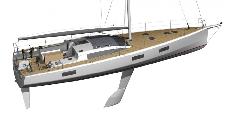

So would they like some additional feedback based upon the drawing provided?
I can solve the beer problem by switching to rum and storing more.
In looking at the design I see a few areas which would raise concern for long passages:
1. a lack of comfortable seating behind the helm - granted these boats are AP driven but, still its nice to be able to sit behind the helm when docking or going into a new harbor where the AP can't get me. Also the distance between the helm and the winches makes it difficult for a single person to handle things. If its meant for a couple it needs to be able to be handled by one person.
2. Beefier rigging - When caught in a storm, this lightweight rig (no back stay, minimal side stays, etc.) would come down in a minute. Also with no back stay, rigging an SSB antennae could become an issue which would limit offshore communications capabilities.
I'm sure they are thinking through these things, just my comments, one other item the deep keel is a problem - it limits harbor accesses and becomes a point of failure during a storm.
These types of boats are great for racing and having loads of fun but when the speeds get too high they become dangerous and require significantly more skill and knowledge to handle, cruising couples may not be a great target market.

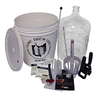

Given an unlimited amount of fresh water via the watermakers, would it be possible to brew beer underway? What would you need to provision?
and
Might be better to just increase storage space for the store bought stuff...
hey Victor,
Here are some of my thoughts on your comments, partly based on a deeper understand of the the boat than I posted here.
1) Seating for sure is a personal choice. On these wide transom boats, by for the most popular/comfortable place to drive is sitting on the coaming. The wheel (or tiller!) position allows this. The coaming is designed to be comfortable, and you get a great view of the telltails. It also allows you to sit in that same position IN FRONT of the wheel, and drive while using the winches, either in manual or electric mode.
2) It must not come through in the pic, but the boat and rig in particular are designed for anything, indeed to go around the world. The design team has designed half of the winning Vendee Globe 60-foot race boats, and a lot of that ended up here. The rig is immensely strong, overbuilt carbon and stays tied directly into the hull. And while it can be sailed without a backstay in all weather, it also has running backs that can be pulled on for more performance.
Yes SSB more of an issue. But the guy with the means for this boat simply checks the box that include the Cobham Sat Imarstat dome.
Typical of Finot boats, the keel is lifting, providing 13 feet of draft when down, but only 5 when up. It is also fused to pop-release in a hard grounding.
While not for everyone, it IS designed for a knowledgeable couple to sail. I've done lots on the 40-foot version of this boat, and its totally manageable by 2. The first (who commissioned the design) was a couple in their 50s. The 2nd (semi-custom built from the same molds) was the same type of people. The 3 is going to 80 year old Stanley Paris, who has had two boats fail on him in attempts, but figures this is the perfect boat for the job.
https://www.sail-world.com/Australia/With-80-years-around-the-world/-154634?source=google

Jackdaw,
Thanks for the clarification, I knew there was more to it than I was seeing. Sounds like it could be fun if you have the means :)
V
