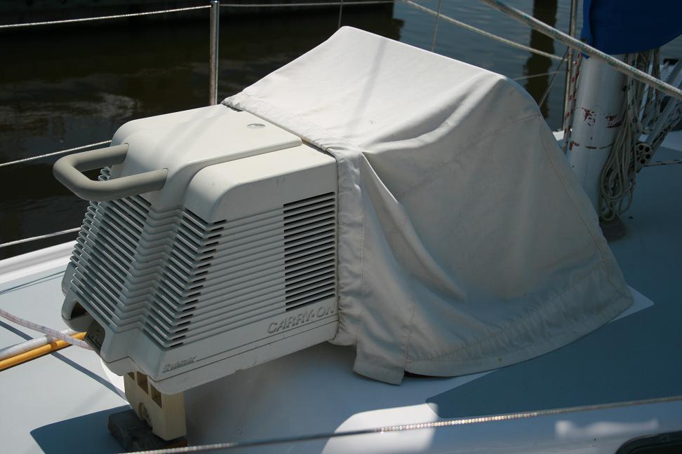

I have an older Cruise Air Carryon that I got for free from a customer. It had been sitting in his barn for 10 years. It works great, but I do not have a generator for while on the hook.
Example picture Not Mine.
What size generator would I need to run this while at anchor? Any suggestions?

i am thinking a e 2000 honda would do the job...those are great little units...i had one on my boat last year while working on the boat sitting on the hard..it takes a little while for the temp to get down in the boat starting from scratch but when it gets there it seems to maintain it reasonably well

I agree. I run a 5000 btu window ac and a fan and light off the honda EU2000.
sometimes it had trouble kicking in the compressor in eco mode, but fine in normal mode.
if I had a sugar scoop transom, Id consider running it on the boat. (with a good CO meter in the cabin)

I have one of those cabin top air conditioning units also, bought new. I used it two seasons but didn't like it very much for two reasons. First, it never cooled very well. The other issue is the condensation from the air duct drips directly into the cabin over several different places. And I mean a lot, we had two keep towels and bowls in place. It is way expensive compared to a window unit. Noisy too. I never tried to run it with the generator. I have run the window unit with the Honda 2000

Interesting. It looks like someone else is now making hatch air conditioners like the old cruise and carry ones.
A window unit can be had around $200. Why in the heck would a glorified window unit with an extra plastic piece and a hood be $800 more? I don't get it.
Has anyone modified a window unit and made it into a cruise and carry?
