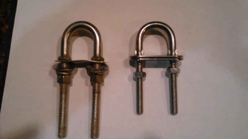

1) Even though the distance between the centers of the two "arms" are the same 1 3/8", the bolt diameter of the OEM's is larger than the the Wichard's I bought;
2) The OEM's upon removal looked GREAT! No crevice corrosion evident at all. Actually no rust or pitting I can see. 35 years on the boat? Amazing!
Also attached is a photo of the old OEM and the new Wichard side-by-side. All I did to the OEM was soak in acetone for a while to remove the original caulk/sealant. Although the Wichard legs are shorter, still plenty long enough for my application. The amount of thread of the OEM part that Hunter installed was about 2" longer than necessary.

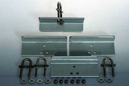

However, of greater importance to any kind of rigging to deck connection is to insure there is a proper backing plate for the hardware. The old Catalina 27's, for instance, had similar u-bolts attaching the four lower shrouds to the deck... after owner complaints of deck buckling in the area (probably from over tensioning the backstay, heh, heh) a retro fit kit was offered that was essentially a large plate replacing the washers, that spread out the load.... So... just saying.. while you've got your head down there.. take a look at how the load is distributed under the deck and see if any improvement is necessary.

is this an optical illusion the one on the right seems smaller than the one on the left in diameter
Sep 15, 2009
6,243
S2 9.2a Fairhope Al
That's what the OP says.
sorry about that i just reread the post and yes he did...... i personally would try to go with the same size not smaller dia...the engineer that rated the hardware originally knew what he was doing and it lasted 35 years
I don't know what they did to retrofit yours but on mine the put in four 2" x 2" x 4" 1/4" thick ss angle iron. It looks like way overkill. Here is a picture of it.
Yep.... that's the fix.... That kit is available through CatalinaDirect.com (also Catalina factory parts dept, I think) for $162.
