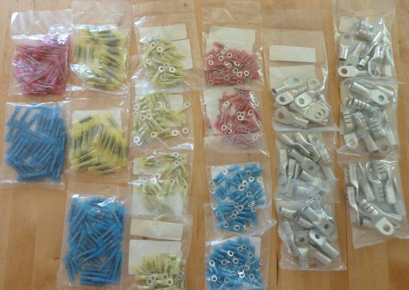

I now order most of my FTZ stuff through Phil. Just had a $350.00 +/- order of terminals show up a few weeks ago...
These FTZ terminals all came from Sailboatowners.com a few weeks ago and I already need more....:doh:

SBO FTZ RING TERMINALS
The "P" in the part number, as in P-25 is how many per bag. At these prices it makes no sense to try and cobble together your own heat shrink terminals..
