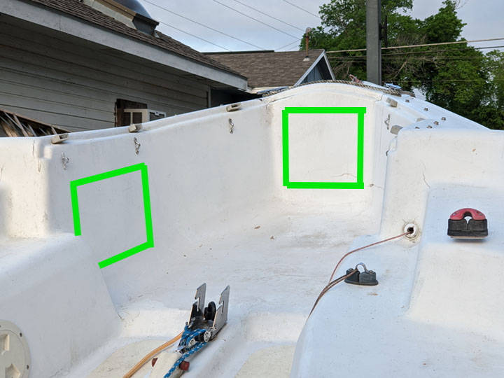

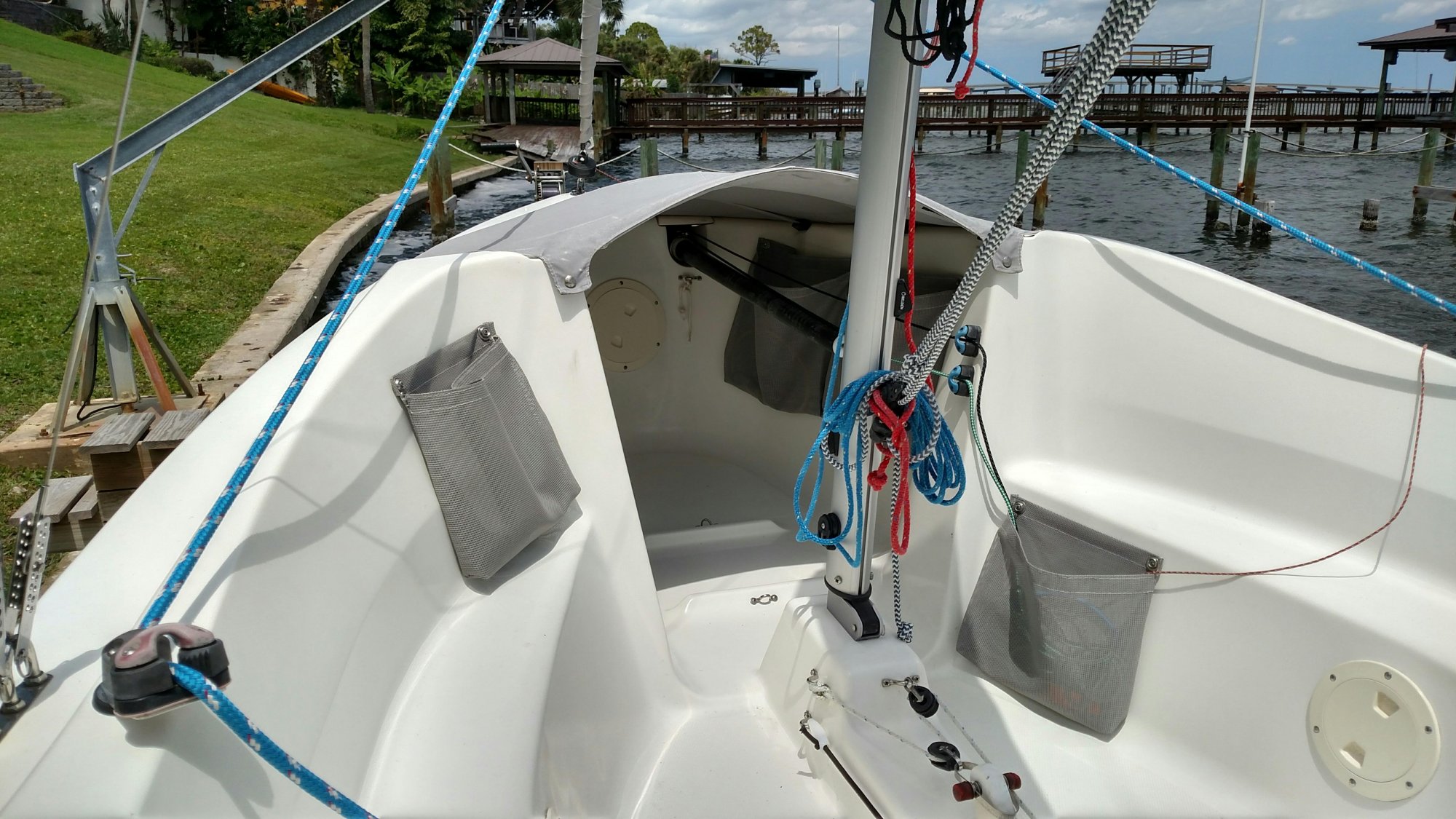

This leaves the forward cockpit. The two areas I am considering are outlined in green in the attached photo.
So, my questions:
Has anyone else tried this? If so, please share your results.
Which of the areas I am considering might be the least subject to stress?
What is your general impression? Good idea? Maybe could work? Bad idea?

For the space on the port side I'm wondering how much space there is between the liner and the hull laminate. It looks like only a few inches. The liner stiffens the boat a significant degree - especially since you don't have a deck. For the bow I would probably shrink that one about half in area. What's in the access port on the port settee riser? I wouldn't give up on the seats. Try to learn if there is a core in the seats. You could always build in stiffening battens. And there are always dry bags.

Good points. Space would be limited at the forward cockpit. about 6" and 12" from face to face means no more than 3" and 9" at the top, and less at the bottom. Useful for ropes and maybe a small anchor.
The access port reveals plenty of open space beneath the seats. I am pleased to be finding ready-made hatches available, water-tight and designed for use in traffic areas, so putting them on the seats themselves is an option. Less handy than at the front cockpit, would mean lifting or possibly removing cushions, but roomier, and hidden when not in use.
So, you don't think I would be weakening the boat at key areas (point about forward opening taken into consideration)?

A few thoughts:
1) To minimize localized stress cracking, avoid sharp corners. Circular access ports are best. If you decide to go square or rectangle at least use a healthy radius at each corner. My guess is there's more stress in the forward bulkhead wall and I'd recommend a circular port only. Side areas are probably less stressed but I'd keep still the opening to a minimum.

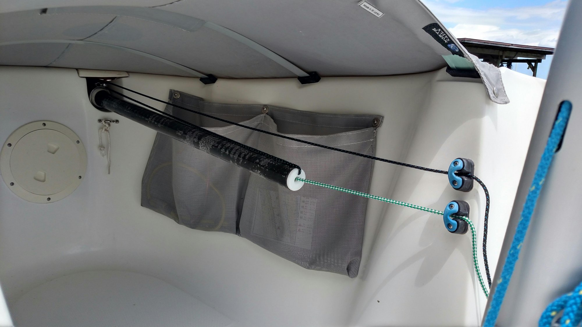

2) The Hunter 18 comes with a 6 in. fwd access port but presumably for access to install the cleat and forestay fitting hardware only, there's nothing to keep stowed items from disappearing back into the hull. Both locations will have that challenge so not sure how you'd secure an internal net to the outer hull short of glassing in a mounting flange of some sort?
3) Have you considered external storage bags hung on exterior walls of the forward area? I bought a set for the 18 from the parts store - a large double pocket net bag for the side wall and 2 smaller bags that can be mounted anywhere. All were well made and reasonably priced at $45 (Hunter 18 storage bag). Geometry is probably different for the 170 but suspect the parts folks can make to order if needed.

I wouldn’t cut any holes in the structure of the boat. The layup of several models of Hunters - 170 included are fibreglass mat, foam, Luran. The outer Luran layer is prone to some problems and does not lend itself to traditional fibreglass repair.

Apprehension abounds regarding cutting into any parts of the boat. They crack easily enough without my help. I have considered the possibility of bags such as those suggested courtesy of CurtisC. Yes, I C what you did there ;). Those bags appear to be out of stock, but I could make my own with mesh easily enough. I suppose another option would be to fashion a trapezoidal box to fit behind the bulkhead. Perhaps both.

Drop a bait box in the cuddy cabbin floor as close to tbe front as possible.
While you have the hole move the bow eye close to the water line.

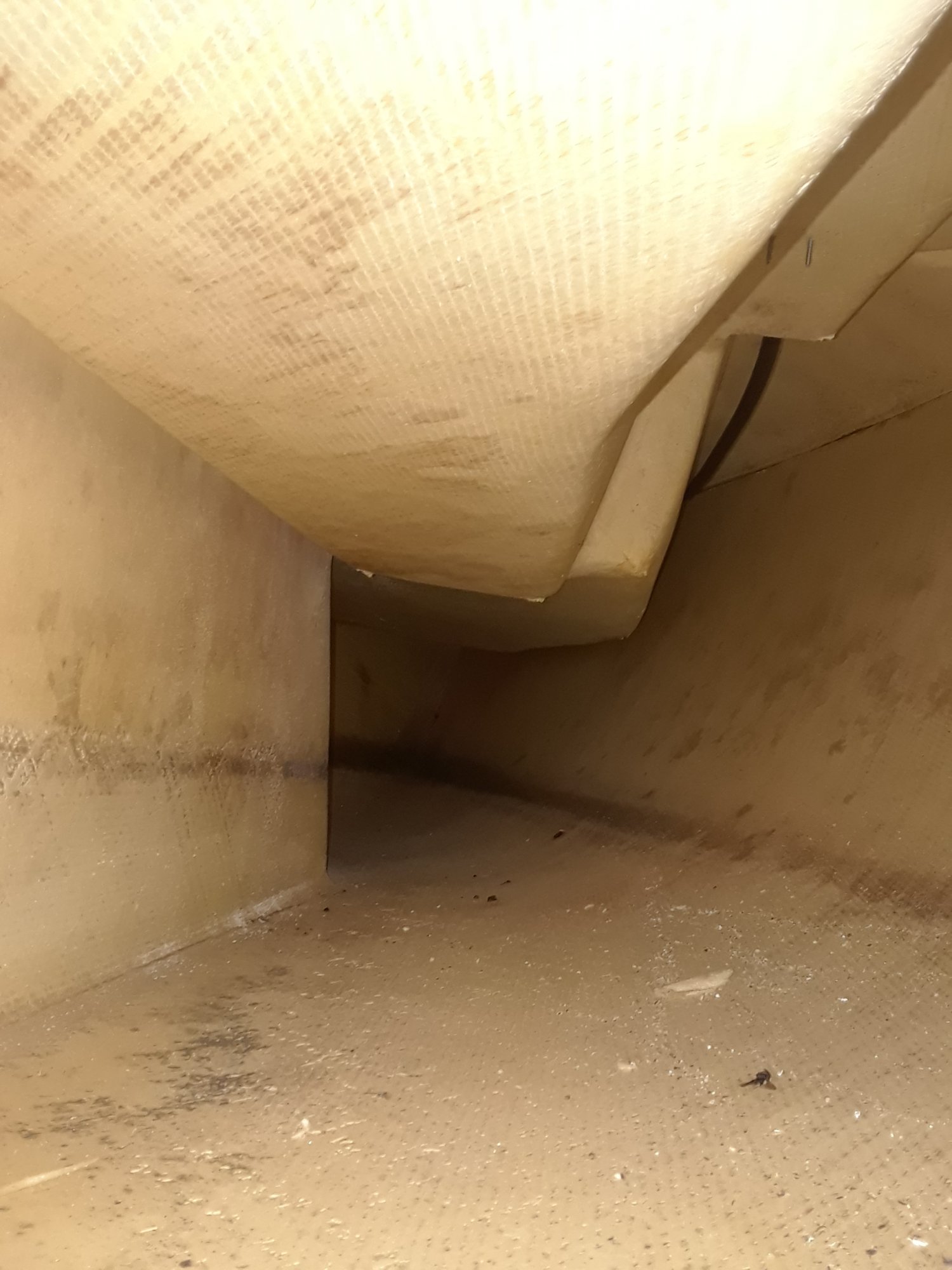

The attached picture shows what inside. You're looking at starboard side centerboard and deck. Can see the roller furling thru hull tube and even a screw that hold the roller furling cam
If it was me i would be try to be sure its sealed up. It will be hard to get anything out if you drop something in the hull. You dont want rain water filling the hull either. 2 part foam is cheap, make your own box to make it watertight.

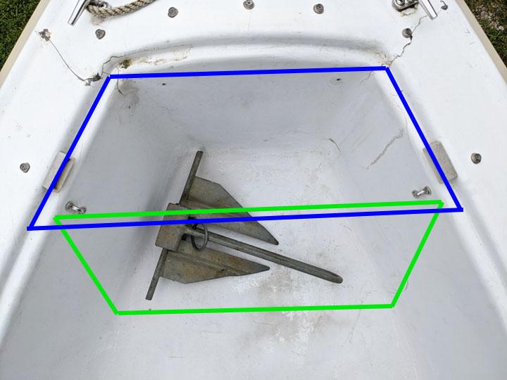

My idea for a less-destructive approach...
Create a partition (as outlined in green) that will accommodate my anchor using this or similar material. Create a flat cover (outlined in blue). It would be supported on the port and starboard side by the existing lip, on the aft by the new partition, and at the bulkhead by a strip of material attached to the bulkhead. Attachment points would be minimal, and could be patched if I decided to uninstall. Slots would be cut to allow for drainage.
I would make it strong enough to serve as a step, and come up with a way to secure the top so it wouldn't end up on the bottom of the lake.
That might be effective. I wonder if you could add an arch to the green shape to mimic the fiberglass battens.
I alway wondered if there were plans for a hard top in that area that would rest in tbe groove.
Then it would mean the blue portion would need to be curved to follow the curve at the bulkhead (if I am understanding you correctly). That would be possible if one were willing to heat the blue portion up enough to bend it.
On the other hand, leaving the blue part flat makes it a more stable platform to step on if need be. I was thinking about adding a non-slip surface there.

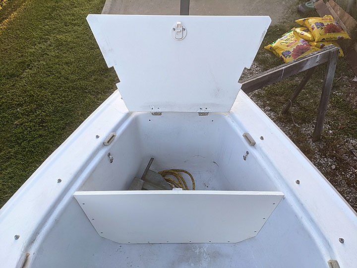

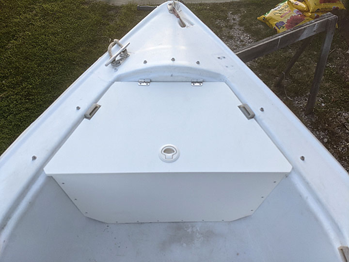

I have ordered materials to do an add-on locker just aft of the bulkhead. $165 for two pieces of 27x24x.5 Arctic White King Starboard Plastic Sheets, 2 hinges, and a flush latch at boatoutfitters.com. Will update for those interested.

Well, the good people at boatoutfitters.com sent me everything I needed (except the stainless steel screws which I already had) to create my bulkhead stowage solution. It doubles as a nice place to sit if you are not under sail running a jib.
Let me know if are interested in product numbers and other details, and thanks to everyone for you guidance. A special thanks to Crazy Dave Condon for his knowledgeable advice and a great conversation!

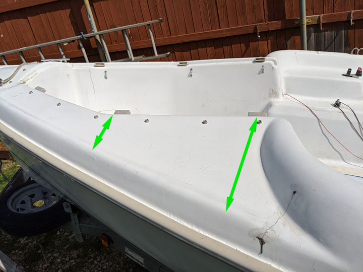

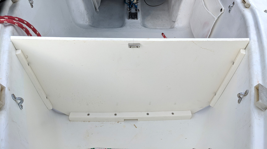

Yikes! Forgot I said I would show how the front panel was mounted. Better late than never? View is from bow looking aft. At the bottom, I found that the screws were too close to the cubby deck to work a drill driver, so I added a cleat on top of the two that were mounted to the hull. I used 2" screws to be sure they grabbed in the Luran outer and fiberglass inner linings, being careful not to strip them out.
