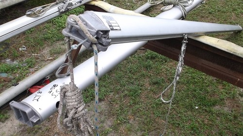

Might this be a good fit?
US Spar Hunter 26 PS Aluminum Mast & Boom Combo 27'6" mast + 12'4" boom, rigging

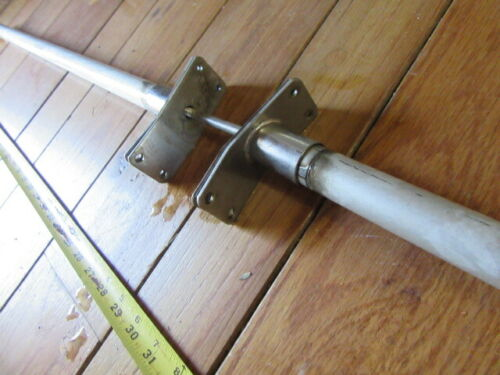

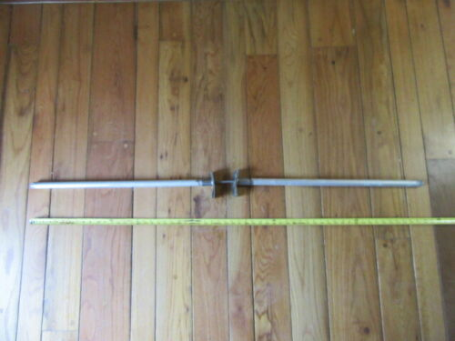

Here is a pic I found of how the Catalina 22 does it..
... the bushing is the piece in the very center. Here is one on eBay...https://www.ebay.com/itm/165048231110?chn=ps&norover=1&mkevt=1&mkrid=711-117182-37290-0&mkcid=2&mkscid=101&itemid=165048231110&targetid=1645685073288&device=c&mktype=&googleloc=2840&poi=&campaignid=16730423415&mkgroupid=135815925780&rlsatarget=pla-1645685073288&abcId=9300841&merchantid=101697201&gclid=Cj0KCQiAw8OeBhCeARIsAGxWtUyTyOLFCBWVxydpMwAwH1wZgiAY01KMqEgNOsGYX5tUhYVi626UEZQaAlVHEALw_wcB
That pin that runs between the two speaders takes the load and keeps a lot of the stress off of the walls of the mast.

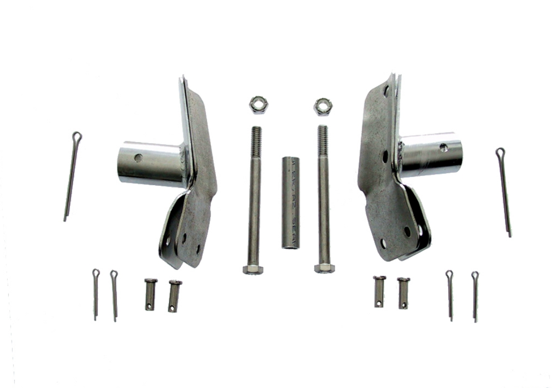

There are a lot of different ones out there... and I suspect that you can find a spreader bracket that fits your mast... for example..
View attachment 212444... the bushing is the piece in the very center. Here is one on eBay...https://www.ebay.com/itm/165048231110?chn=ps&norover=1&mkevt=1&mkrid=711-117182-37290-0&mkcid=2&mkscid=101&itemid=165048231110&targetid=1645685073288&device=c&mktype=&googleloc=2840&poi=&campaignid=16730423415&mkgroupid=135815925780&rlsatarget=pla-1645685073288&abcId=9300841&merchantid=101697201&gclid=Cj0KCQiAw8OeBhCeARIsAGxWtUyTyOLFCBWVxydpMwAwH1wZgiAY01KMqEgNOsGYX5tUhYVi626UEZQaAlVHEALw_wcB
View attachment 212439View attachment 212441
View attachment 212442View attachment 212443
Awesomeness! Thanks so much. The store here has the Hunter spreader bracket. I’ll take a good look at the new mast and see if fits.
13,052
The hunter mast was a Z-spars... which I think changed names (US spars?). So if your new mast was made by them, it might fit.
