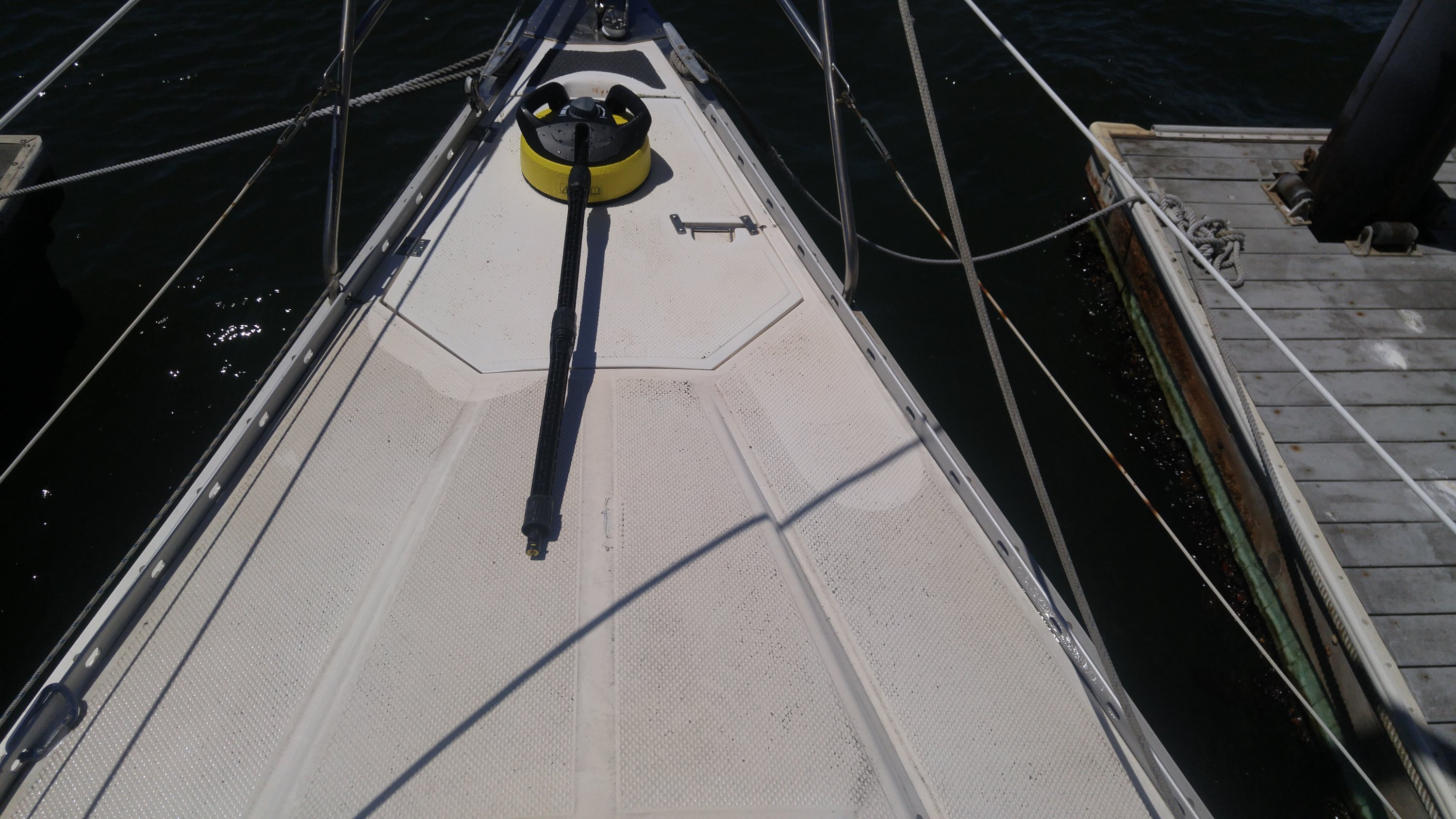

I spent most of last Saturday cleaning that black stuff out of my non skid. When it's dry the stuff feels like cement. When wet it is super gummy like adhesive residue. My solution was to wet it down with a solution of Simple Green and keep it wet for 20 minutes. After that I had to pressure wash it very slowly to blast it out. The picture shows the rotating scrubber I bought for my Karcher high pressure washer. It was marginally effective. I had to go back to the spray wand. My washer is only 1400 psi. More pressure would have been faster. But the boat does look much better as that stuff was accumulating for a few years now.
Maybe you can zoom in on the picture and let us know if it's the same gunk.
I'm going back Saturday to scrub with a Doodlebug and medium pad. I use Soft Scrub with bleach for the final cleansing. Then I plan on coating with Woody Wax to see if that keeps the stuff away.
