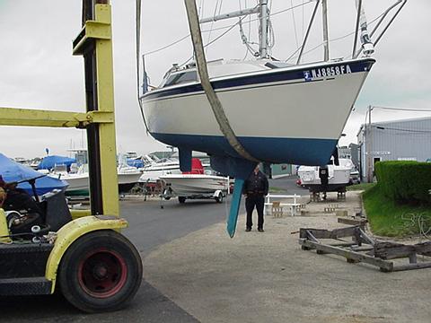

How O'Day did it
The original Shipping/storage cradles for the O'Day sailboats (pretty much all models) used a basic rectangular frame of wooden timber and the hull was supported by 2 plywood profile supports, one forward and one aft. For the 22, I think that used 8" x 8" beams about 10' long for the longitudinals, 4 cross beams (6" x 6") about 7' long, one about 12" in from each end, and 2 under the keel (about 6-12" in from fore and aft ends of keel). The keel set on these 2 cross beams. The hull was supported by plywood supports cut to match the shape of the hull over the 2 outer (furthest fore and aft) cross beams. These plywood parts were held up by short 4" x 4" posts on the beams, and braced to keep them from moving. I'll try to include a picture that shows a similar cradle for a 222, it sort-of shows what I'm talking about.
