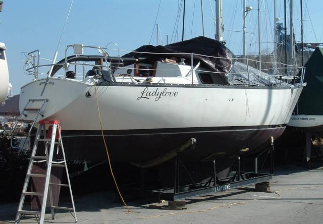

If you study boats around the marina that are on poppits you can get a good idea where the pads make contact. They have to be slightly under the hull, maybe ten to twelve inches below the water line at the mid-point and a little closer near the bow and stern. In the picture if I had pads where the cradles are located you can see they would need to be higher. The weight is on the keel, the pads just keep her upright. But you knew that. Given all that I think your pads need to be adjustable from about four feet to four feet six inches.

Here are the dimensions of my cradle for an 81 H33 with shoal draft: Aft uprights=51" high and 65" wide, fore 59" high and 67" wide, distance between fore and aft uprights is 140". Note that I have to block my keel about 9 inches to sit properly on the pads.
