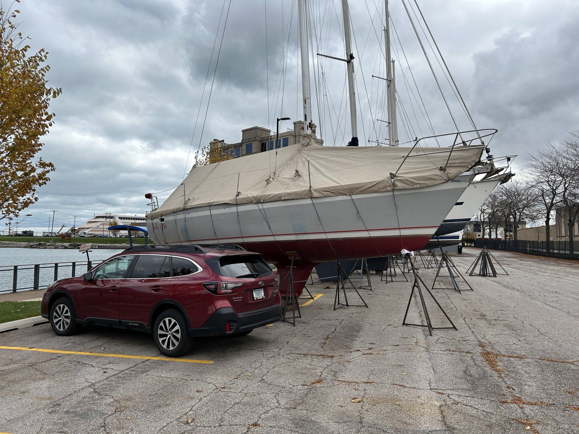

My yard doesn’t allow cradles to be left at the marina over the summer…so even though my boat came with a cradle, I never took it with the boat.
Marina provides jack stands for winter storage on the hard, so that is how Tally Ho stays upright all winter.

Our yard uses jackstands and allows owners to leave their masts up all winter. We've used them for more than 25 years, and gone through 50-knot windstorms. They handle more than 100 boats on the hard each season without cradles. Maybe you can sell your cradle to someone who needs one.
