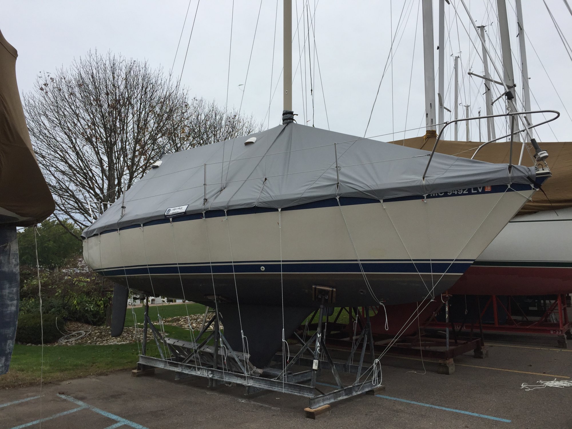

Does anyone know now far forward of the transom are the rear cradle pads to be set? Also haulout sling locations

Determine the bulkheads locations. The aft pads on my cradle line up with the aft bulkhead at the cabin entrance, the forward pads line up with the forward bulkhead and the middle pads are about mid keel. Sling are at bulkhead locations. The lift operator should know.
