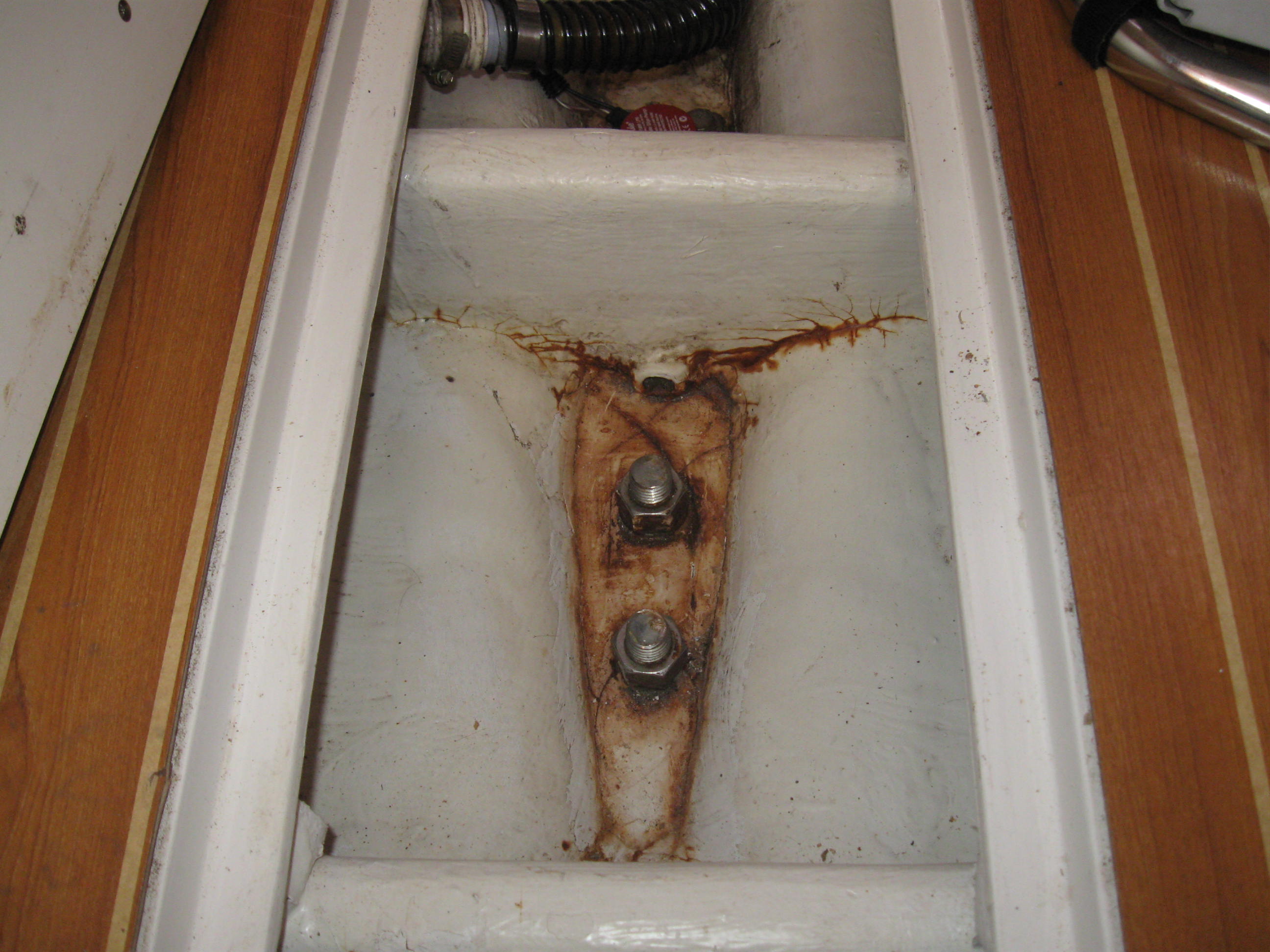

Do you have any idea what that crossbrace is cored with ? Wood, Glass, etc I can't tell on mine as we share the same hull. It could be the cracks are just in the glass covering the brace. Have you had any groundings?

Had them too. I talked to a former boat builder who did our survey when we bought the boat. He said they were superficial and not structural. Its cracks in gel coat/ paint used in the bilge. Talked to a fiberglass guy that did some repair work for me, too. He said the same thing. His recommendation was to knock off any loose areas with a scraper, lightly sand the area with 80-100 grit paper and then paint with Bilge Kote from Interlux or a similar product.

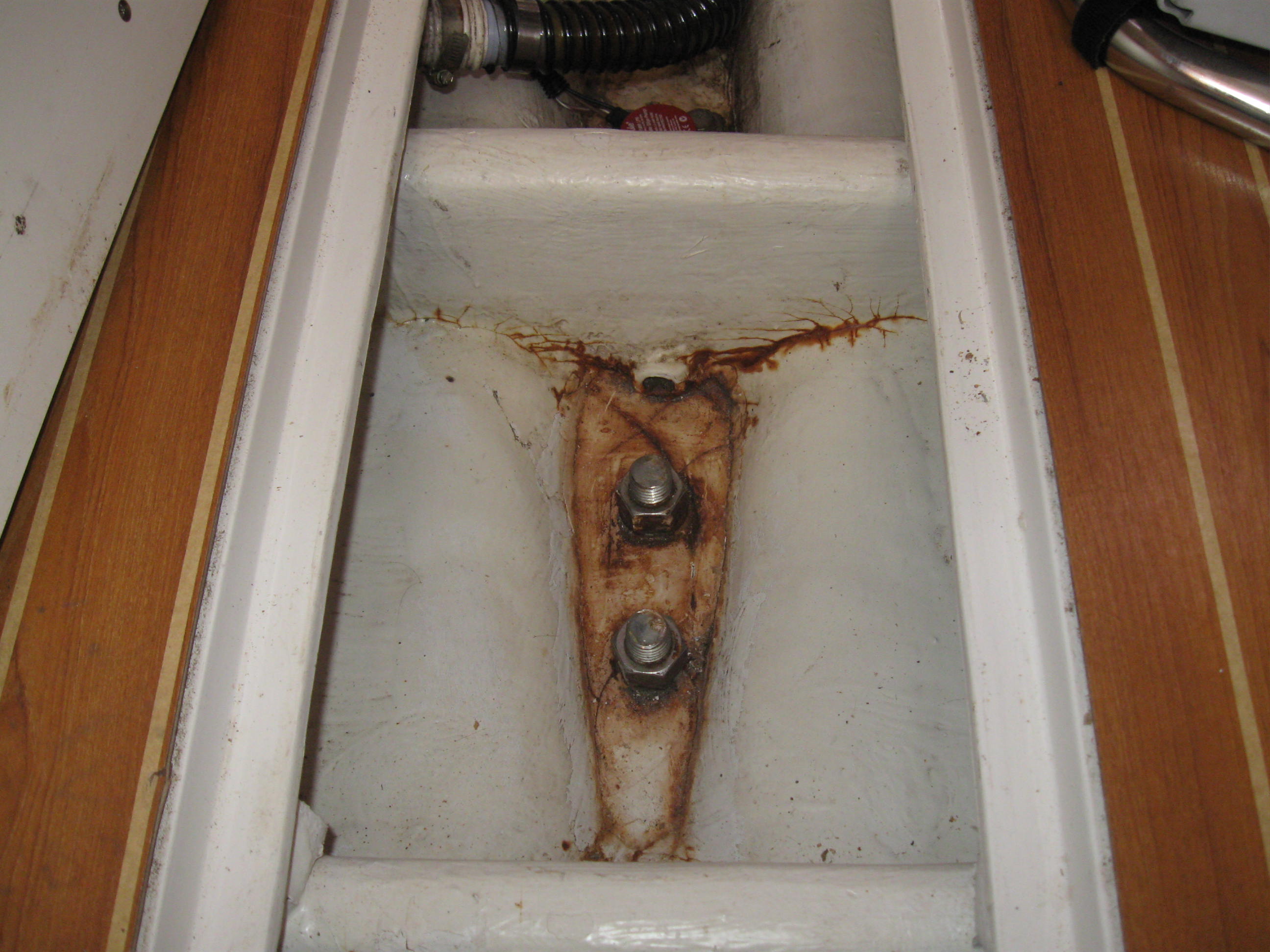

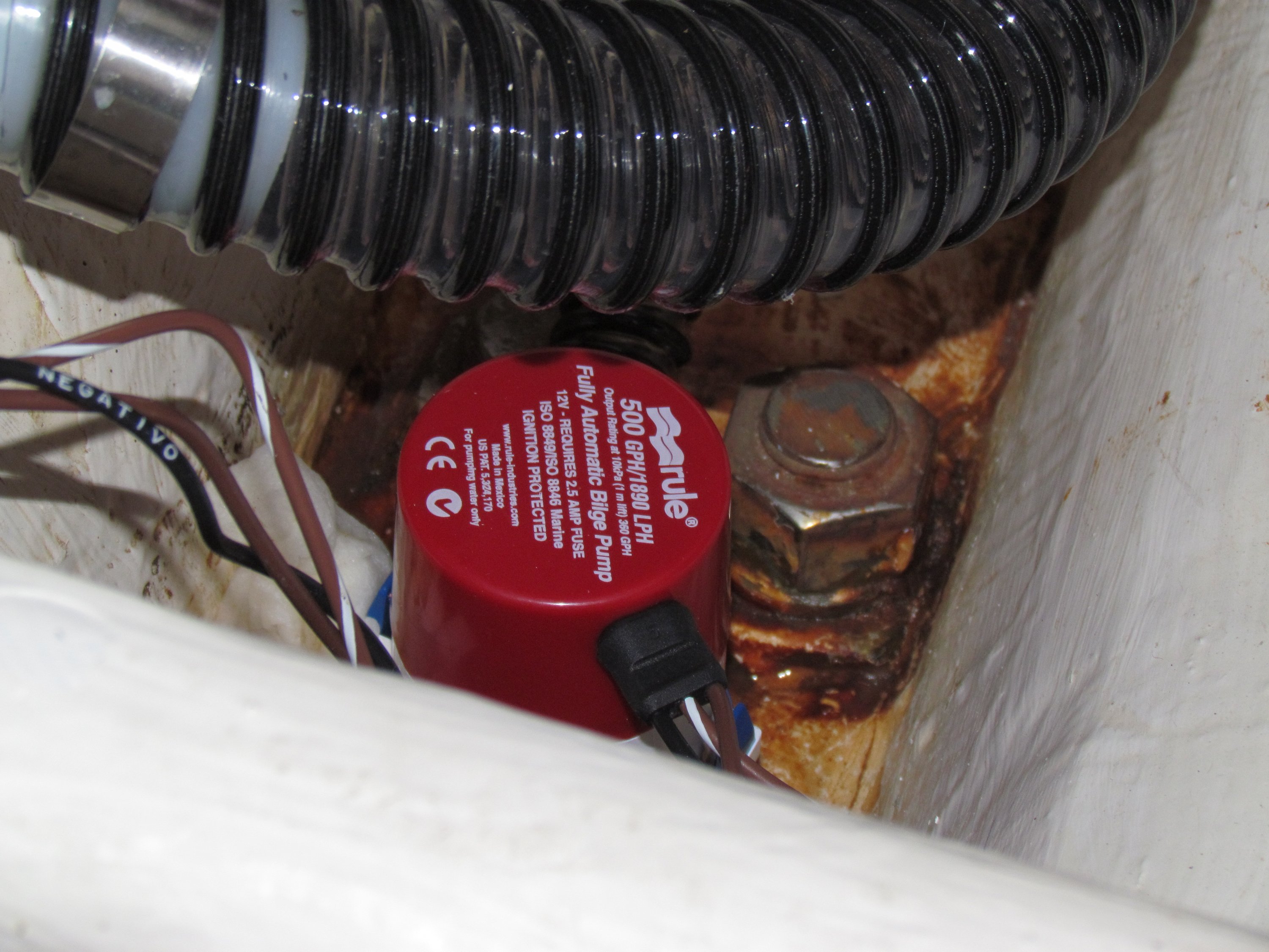

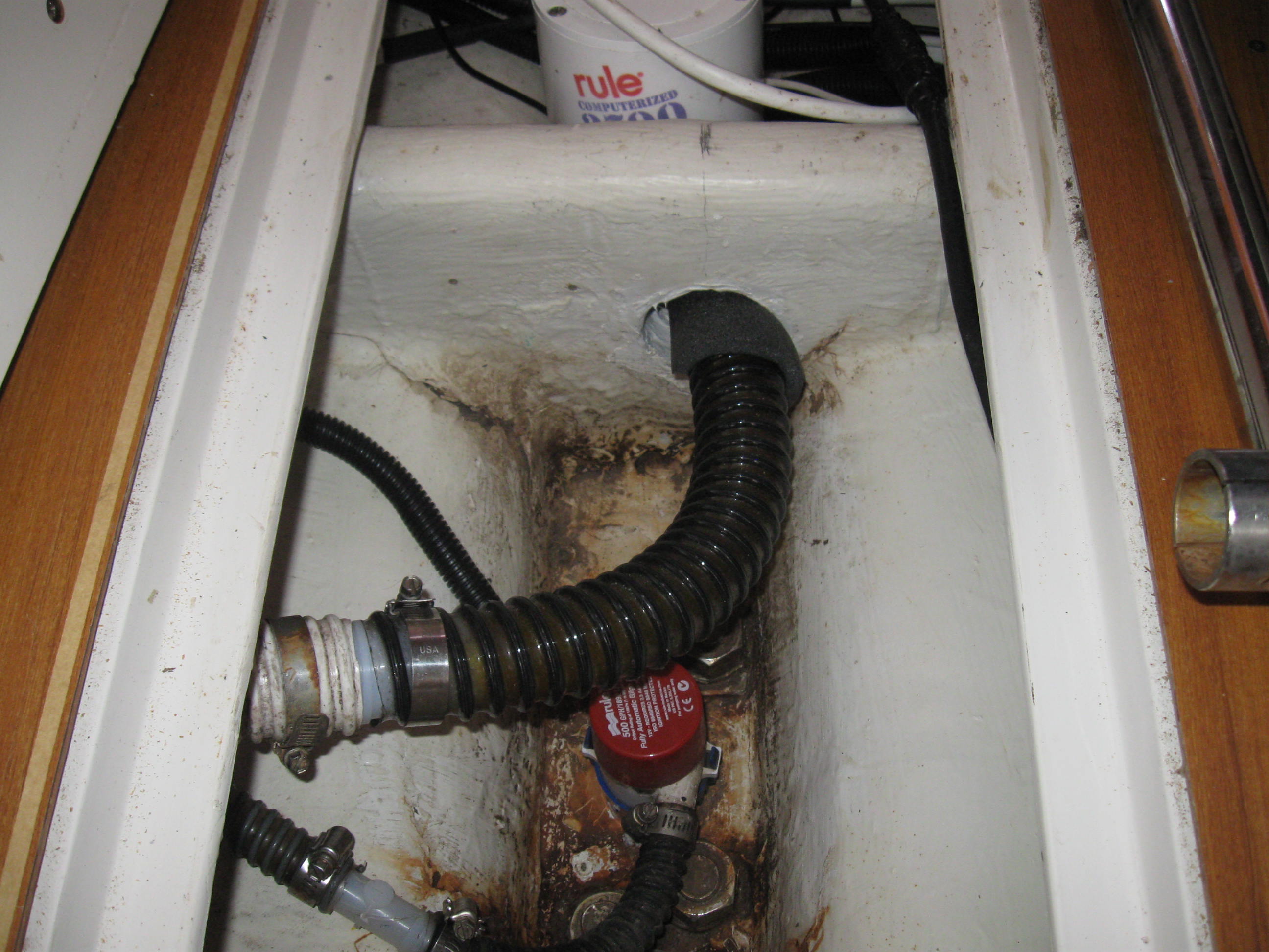

Anyone else have cracks like these ?
Yes and they were at a stress point like your. Since mine were in the bilge, like yours, I would just water tight seal them, and not worry about "matching" the color.
I would be more worried more about the metal miss match on you keel bolts. That is a "no no".:(
It appears that you have mild steel washers on Stainless Steel bolts.
Jim...
Nov 18, 2010
2,441
Catalina 310 Hingham, MA
Jim...

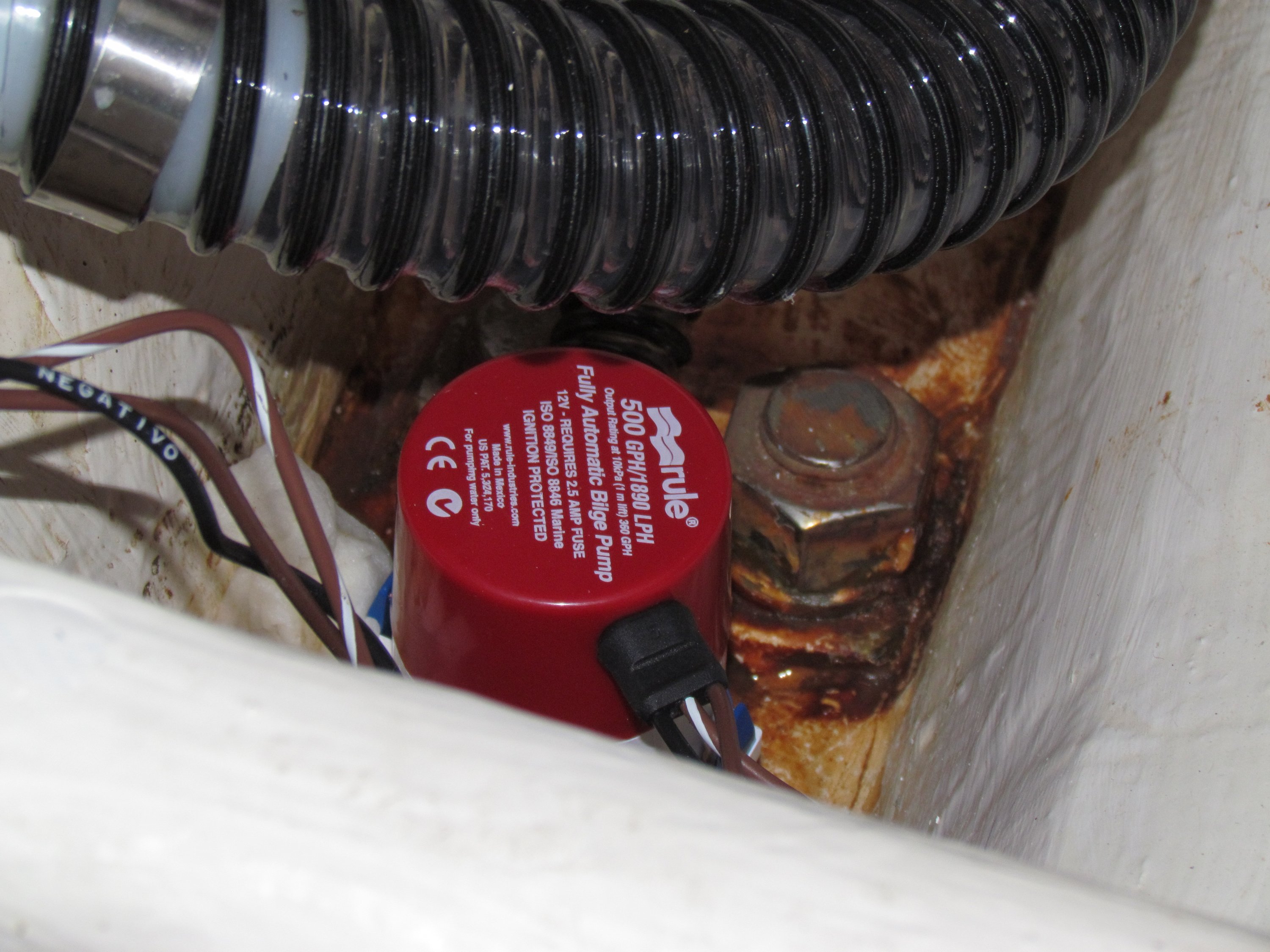

Really? Mine are stainless washers, bolts and nuts. Might just be some bilge gunk on the ones in the pic.

Yes I have them with some delamination at the front stringer in the bilge.
Warren Pandy says the stringers are fibreglass so you dont have to worry about rotting wood cores.
He said scrape away any loose stuff and take a dremel to it to see if it is gelcoat or fibreglass
If gel just clean and paint... if glass, grind out and fair in new tabbing.
I havent got that far yet.
I also have spalling in the bottom paint on the curve of the keel/hull transition that looks like it flexes there.
Warren says its a solid glass hull keel joint structure so it doesnt have wood to rot away like some of the C&C mountings so not to worry...
Did you fix them ?
