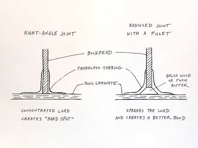

These cracks are due to the bulkheads causing a "hard spot" against the hull. Fiberglass will flex and that is mostly OK, but anytime the flexible fiberglass is stopped from flexing by bearing against something stopping it.... cracks may develop. Some custom-built or higher-end boats were built with a gap between the hull and bulkhead, sometimes a foam strip is placed there to cushion the point of contact, to prevent a "hard spot". In other works, it is basically "normal" for this to happen on older fiberglass boats. Keep an eye on the area to be sure it doesn't get worse, but.......as others have said, gelcoat is not as flexible as the fiberglass lay-up underneath it, and so little cracks (crazing) may appear in places. Again, the hull (and/or Deck) flexes, the bulkhead is preventing that area from flexing, and so crazing occurs. I found the picture below o n the following web page, FIBERGLASS BOATBUILDING: Internal Hull Structures - Wave Train

I was able to check the inside joint this weekend, it looks like right angle joint.
Luckily, I don't see any cracking on the inside, so I think it's as suggested, limited to the gelcoat.
