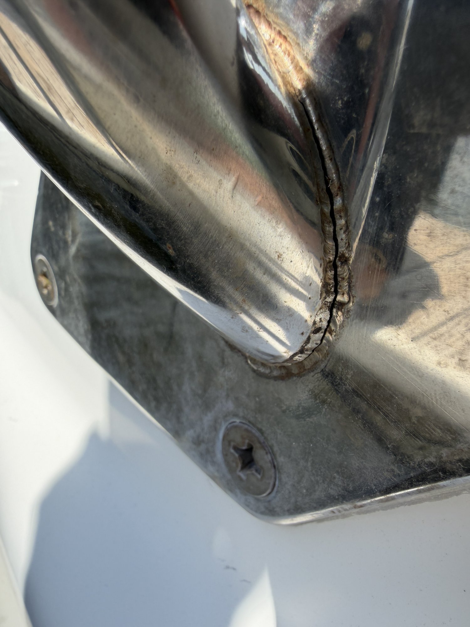

Hi all-
Have a Hunter 310 (2000) with a stainless steel arch. Discovered over the weekend we have a crack in the weld on the starboard side. Anyone ever dealt with this? Do you need to remove the arch to re-weld? Thanks in advance.
This is the forward tube on the arch. 1.9" dia
weld is about 50% failed;
Load is about 4500 lbs from the main sail, more during a jibe.
With a 1.9" pipe, we had about 6" weld, about 3" left.
In steel the weld is good for about 5500 lbs.... less in stainless. Assuming about an 1/8" weld.
@Ralph - structurally this does need to be repaired -
Looking to weld, not repair with JBweld.

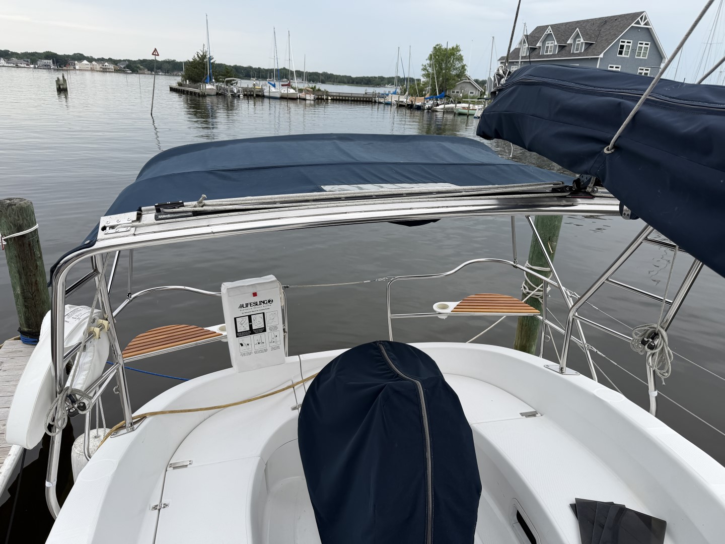

Actually, I am an Engineer - had already determined that structurally it was a problem. Am looking to see if anyone has ever needed to remove the Arch on a 310. If that is doable, it is an easy repair. Otherwise, we are looking at loosening it to get a heat break so we don't damage or ignite the fiberglass doing a repair.
Here is an general geometry picture of the arch - forward leg, starboard side.

Seems like a good deal compared to removing the Arch and reinstalling it just to save a few hundred.
The question of removal of the Arch, assuming the screws/bolts come out, is will we be able to reinstall. The hull is flexible. The Arch could have stress related to the hull - in water is different than dry dock.
My concern is being able to re-align and refasten. Will we need to use a come-a-long to reshape the hull to get screws re-aligned.
Not a simple question - looking for guidance from someone who has actually done this on a Hunter 310 with the stainless steel arch (later models are fiberglass)
@rjadelsohn , you definitely have this in hand and I agree with your method of repair. Seeing as how the weld crack is so complete, I might also consider some form of reinforcement around the entire base of the tube.
This could be one holy bastard. As previously mentioned, my FG arch is attached with 5200 which means it's not going to part from the deck. Some of the sealant material is visible and cuts like an old vulcanized tire, just like 5200. This is yet to be determined with your SS arch and we're all hoping for the best.
As far as welding in place is concerned, the FG beneath the arch pad will suffer given the length of the weld. Also consider that the bonding strength of the 5200, if it was used, will be gone with the heat. Something was used as a sealant between the arch pad and deck but I don't know if anything was applied in there for strength. Any way you look at it, I would recommend removing the arch for the least post welding worries.
Hoping that 5200 was not used on you arch and looking at my own 1999 H-310, for sure the hull will have twisted once dropped in the water and screwed up the alignment with the arch bolt holes if disassembled. My first thought for realignment would be short pieces of 2X4 in the required places held in place with heavy double sided tape :
The shear strength of this stuff is amazing as long as you apply a little perpendicular load which requires a Rube Goldberg imagination and a large number of bar clamps. A few drift pins in unused holes wouldn't hurt either.
Please keep posting on your progress. A very interesting problem and I thank God I don't have it :eek:.
