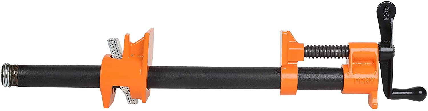

I have two of these and I find uses for them all the time (see pic). The pipes are sold separately at lowes. You adjust the "clamp" on the left to fit the job and then squeez it down using the screw on the right. It is a great way to glue a lot of boards together into a larger board or a stout block.
