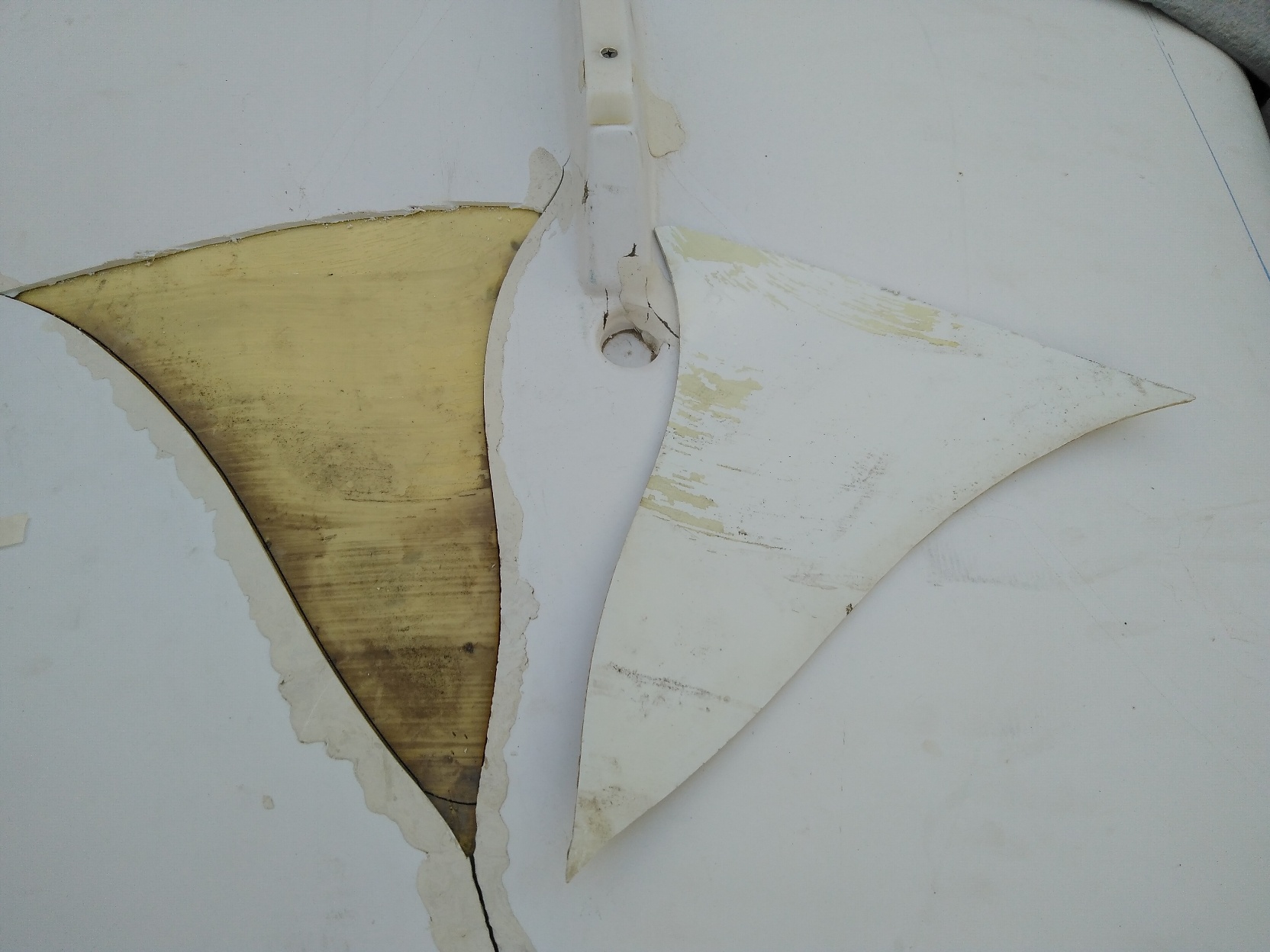

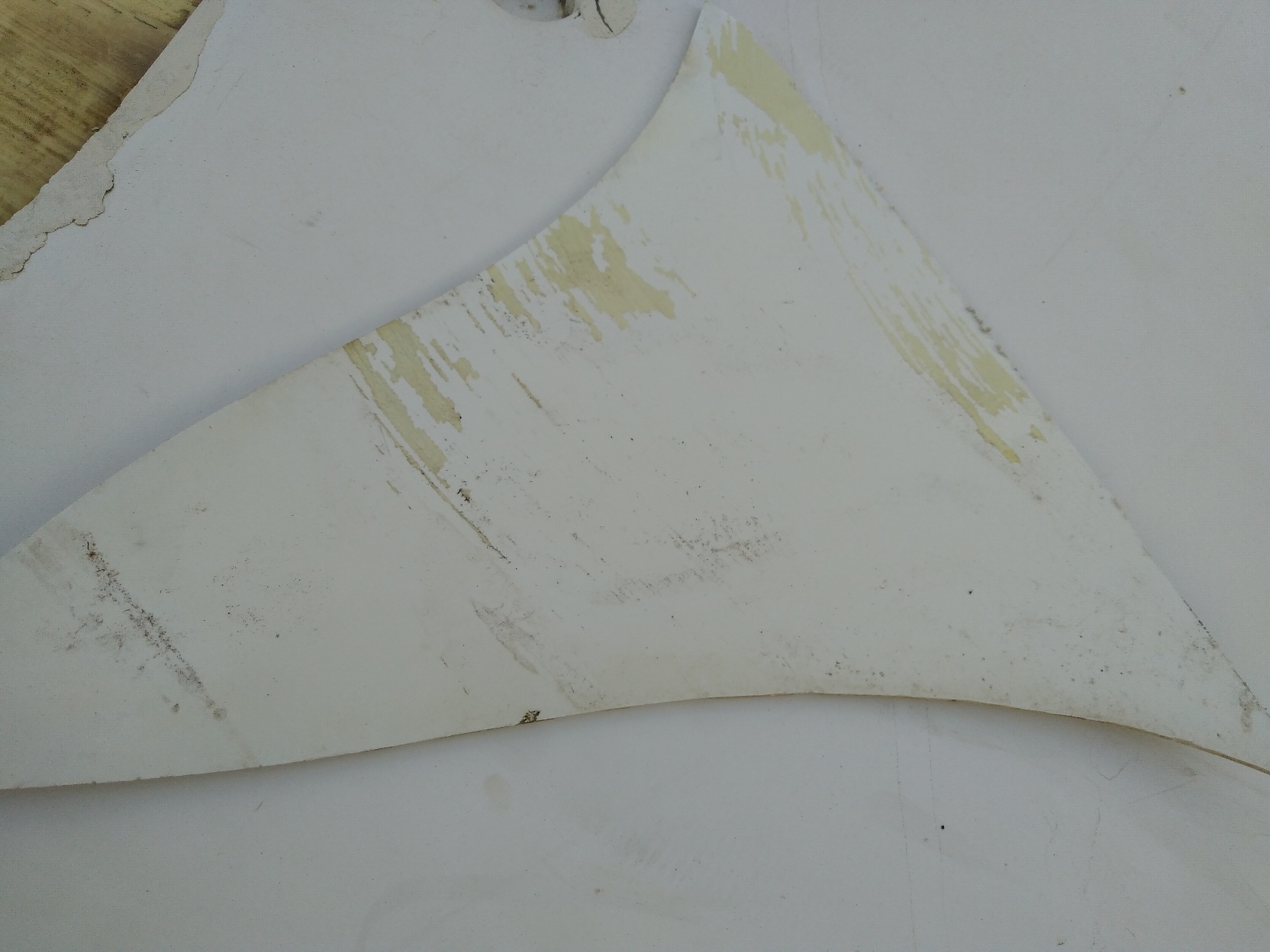

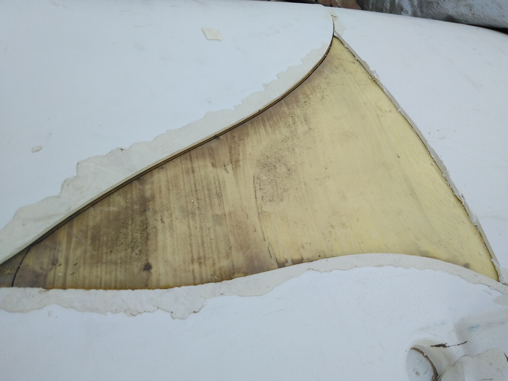

I have cut out a small triangular panel ,which was already separated on two edges, so I just took a dremmel and cut a third side to remove the panel. Some pictures of the innards are attached.

Present plan is to cut out small manageable size panels, one at a time, glue these back to the foam, one at a time. Will make the cuts with a dremmel or other rotary cutter, avoiding damage to the foam, and leaving a slightly jagged edge, and a gap of 1/16 inch between panel edges. Once the outer panels are glued back all over, use a glue like g-flex to seal the gaps between panels.The jagged edges and slight gap between panels ( aim is 1/16 in gap, but even 1/8 gap should be ok I guess.) will likely ensure good bonding between panels with g-flex.
The limited goal is to extract a couple more seasons out of this cracked hull.
