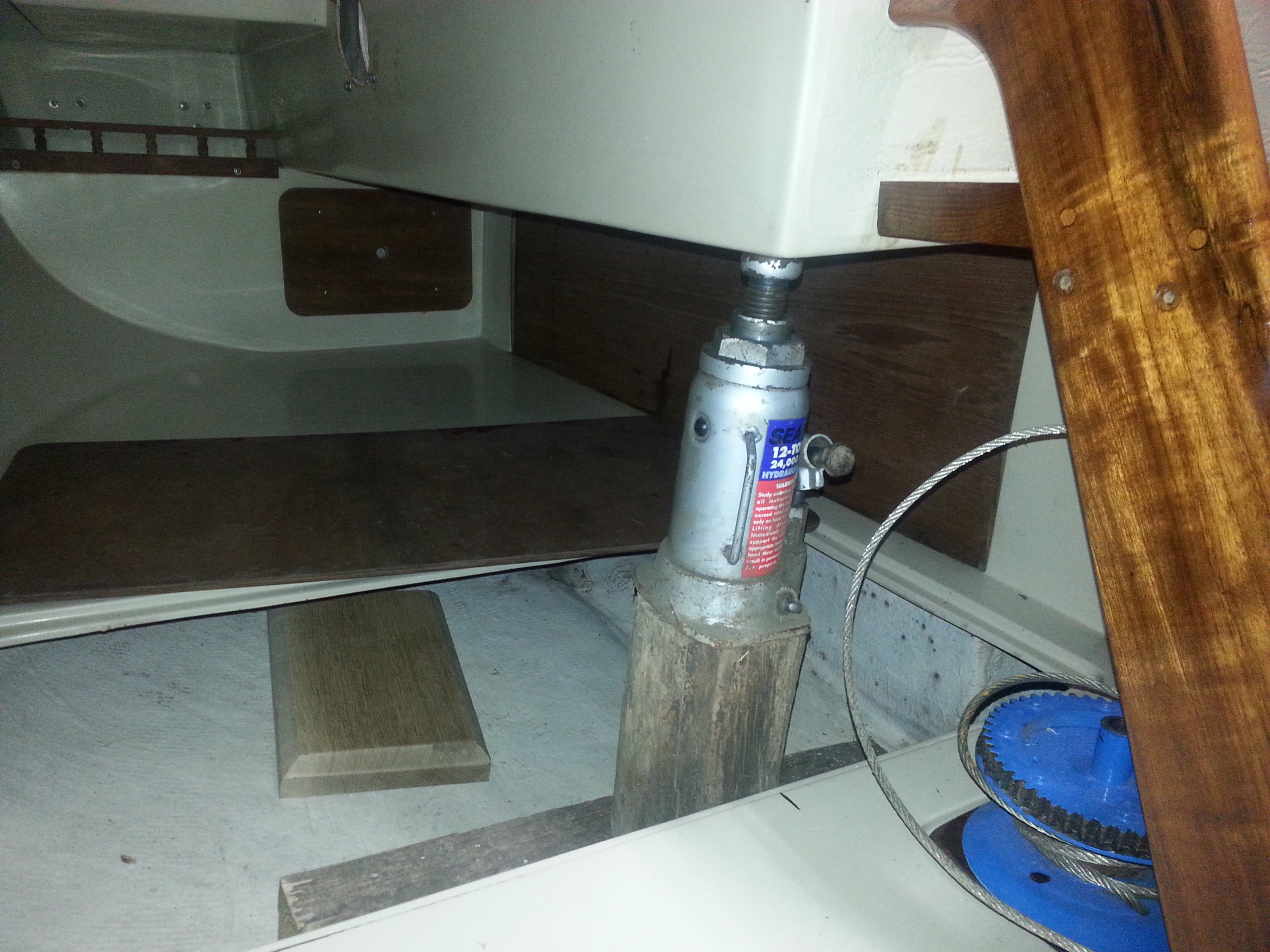

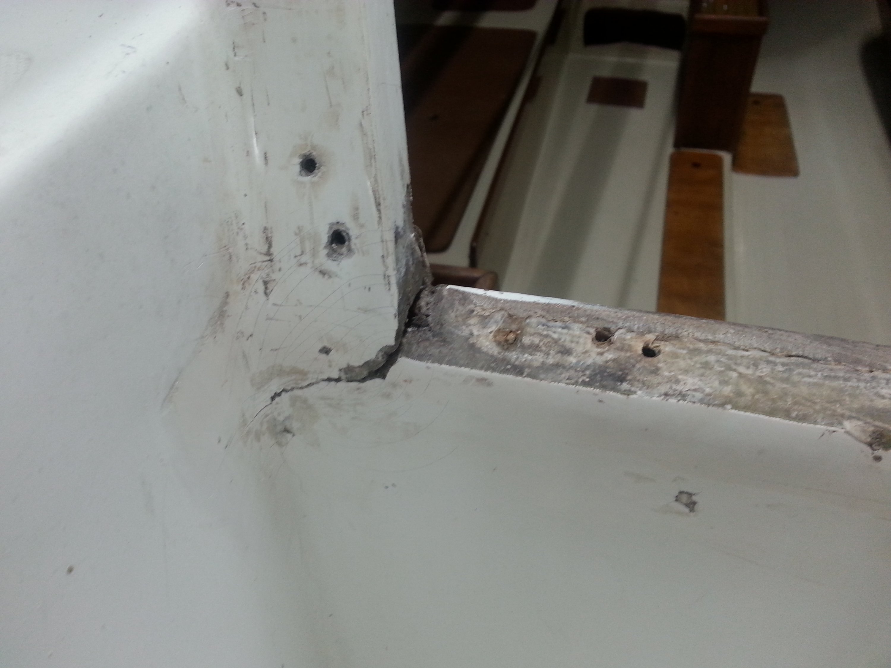

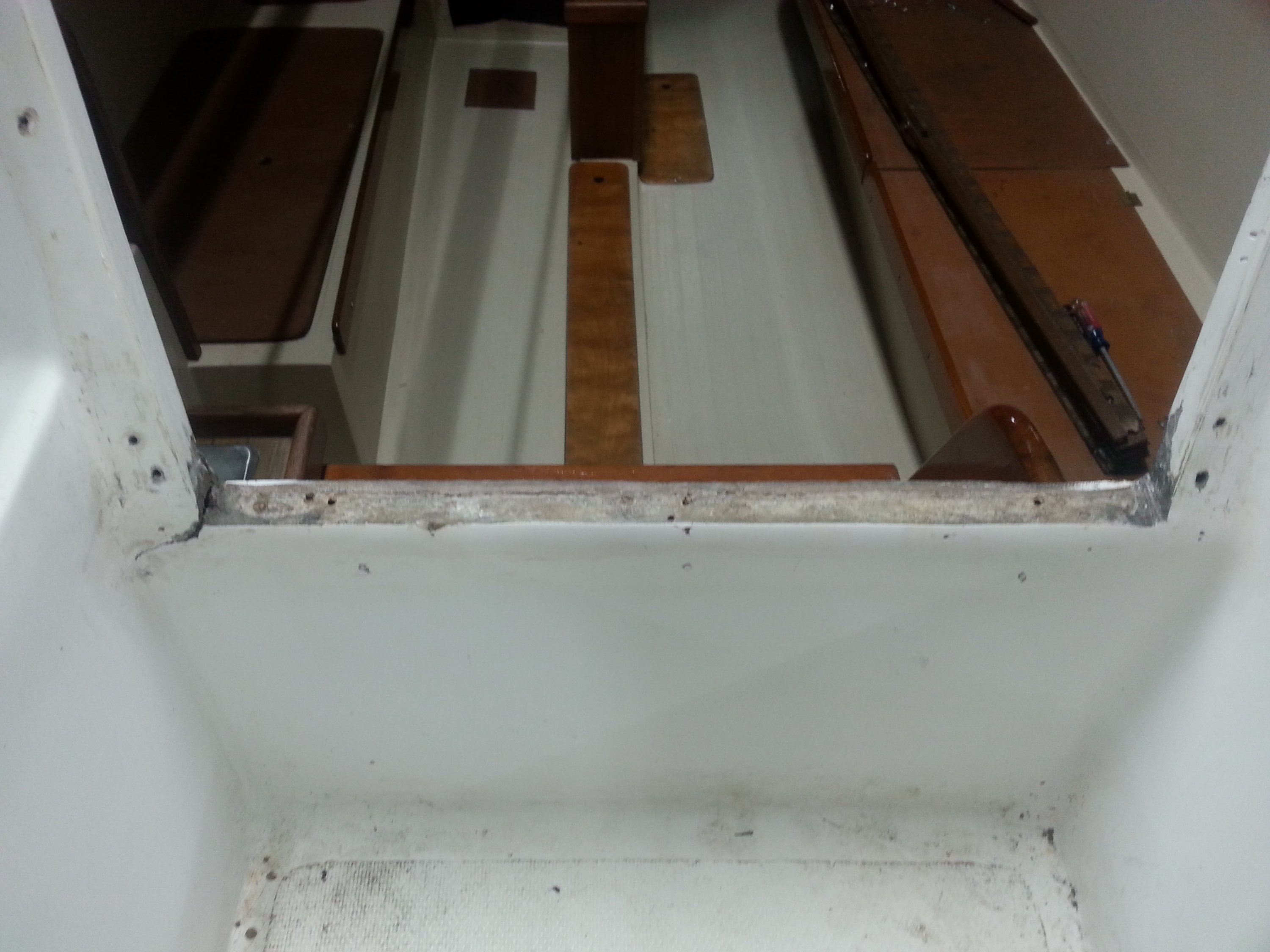

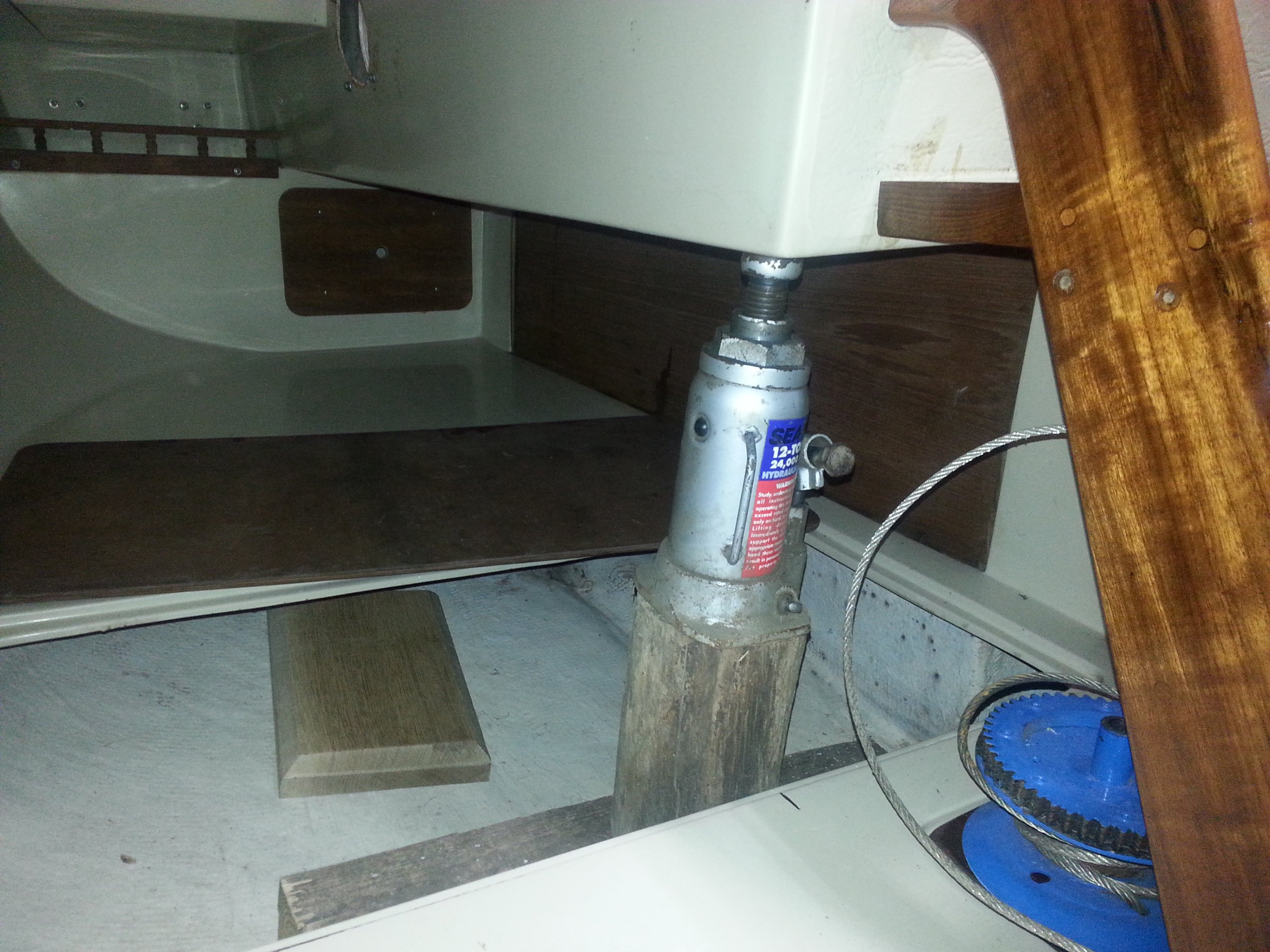

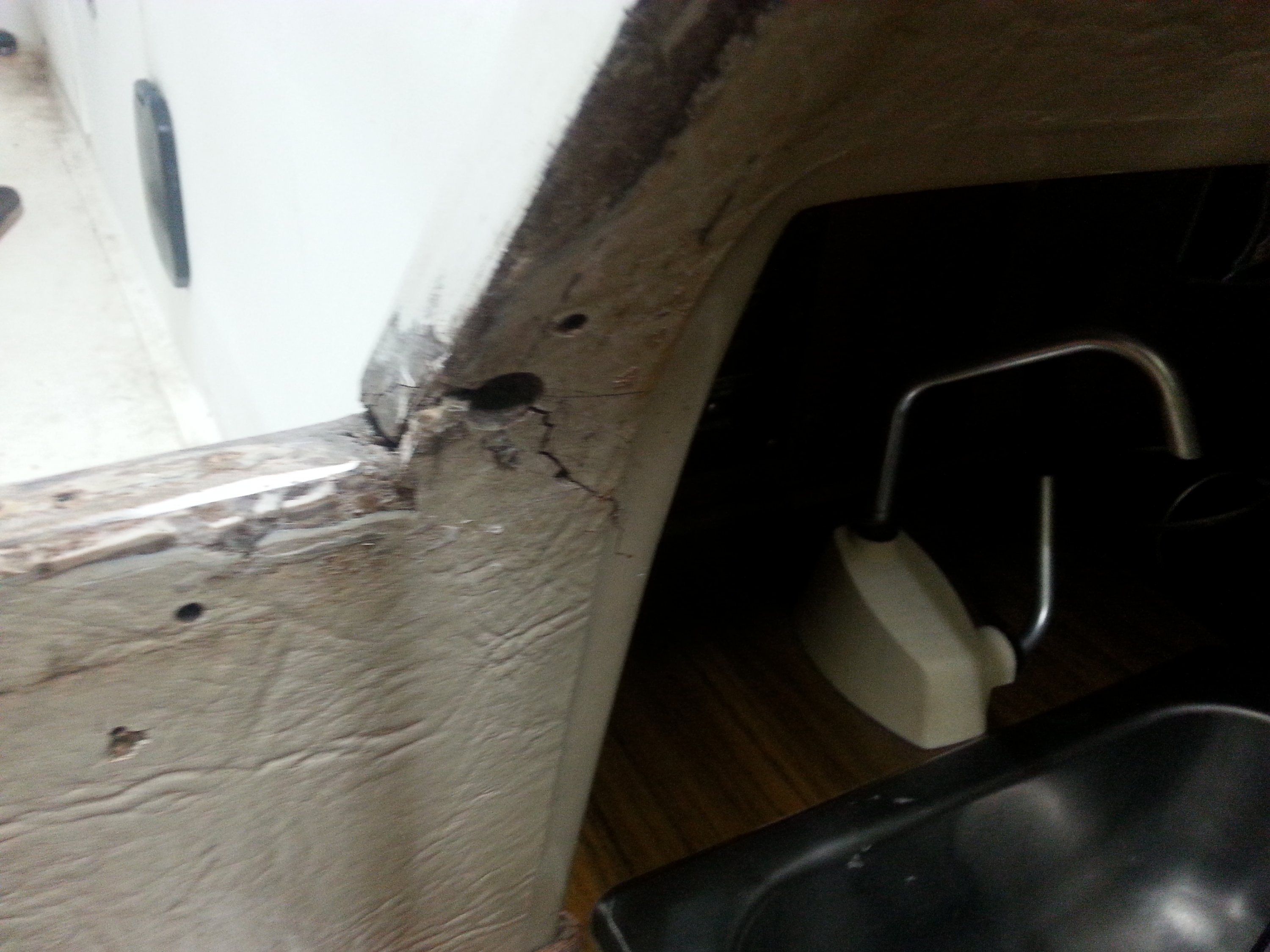

Probably typical after any used boat purchase, I'm finding lots of little issues with my '81 Catalina 25. The most recent is finding a crack in the lower port corner of the companionway bulkhead. The crack has displacement, and the companionway step is noticeably lower on the starboard side. When measured it looks to be 5/8". I supported a bottle jack with cribbing on the hull and jacked the starboard side from the corner inside the cabin to see how much effort it took. Looks like it moved back with the jack with some effort, and all the surrounding items line up much better, but now I have the issue of repair. I'm skeptical that a full fiberglass repair on the crack will support the breakage. I'm wondering if a semi permanent post under the starboard corner would be acceptable. Or maybe I should just pour a whiskey sour and pretend the crack doesn't exist. Has anyone else ever see this, and/or seen repairs?
