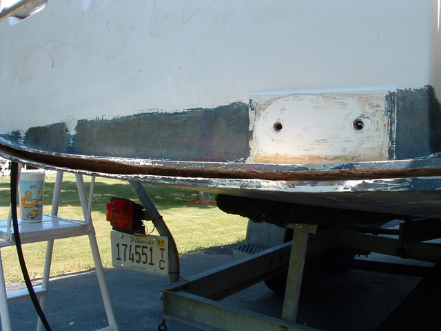

Here's a picture of what it looks like with the material removed. I was getting water in when the hull was stressed while sailing but not sitting. I chipped it out and used bondo/glass to refill it. I just kept chipping out until it got solid. I thought for awhile I was going to go all around the boat but it eventually got solid and I stopped chipping it out. I'm guessing from memory about 4 to 6 feet was bad. I don't remember what I covered it with but some kind of two part epoxy gel coat.
I used 5200 on a three foot rubrail crack a couple of years ago but I prefer the bondo/glass. It has fiberglass in it that gives it strengh and flex and stays where you put it. I made a sample of plastic and 5200 that I put in the same conditions as the rubrail repair and every morning I would check the sample. It took more that 2 weeks for the 5200 to fully cure in that depth and thickness. Don't put it in there and then go sailing.

John, It looks like you didnt just take out 5200 but also took out a considerable amount of hull and deck material on the port side. Was it some sort of power tool that got too aggressive or was the layup too thin or joint poorly mated and flawed somehow? maybe some SS 1/4" bolts every 12-18" would prevent any further flex induced fractures.
It's no wonder you had a leak back there and did you say you filled all that space with a bondo/glass infused filler or was it filled with resin saturated mat. Could you squeeze it together with clamps while the material setup?
Thanks for detail while I prep my Summer drydock punch list. Mike

The original material in the joint is not 5200 uless 5200 gets hard and brittle, which this material was. I took out the material by hand and was careful not to remove any hull or deck material, only the bonding material. All deck and hull joints have space in them to put the bonding material into. First, there is no way to make a perfect fit in something this size and second, there must be space for the glue/bonding material. The side joints, which I had to make a small repair to, have at least an 1/8" to 1/4" gap as well. As far as I know, all of the boats are made the same way.
Trying to squeeze the joints together would distort the shape and put an undue stress on the joint. I filled it with only bondo/glass and it has worked perfectly. Bondo/glass has chopped fiberglass material in it and has both strength and flex. The bondo stays where you put it and sets up relatively quickly. I did not use any clamps. I then covered with either gelcoat or white epoxy, I can't remember. I check the joint periodically and it is working perfectly.

I'll be doing mine sometime in the near future. You're definitely right about the 5200 being too runny for the hull joint. I'll probably end up with your Bondo/matt mix with gelcoat to finish it. Thanks for the input. Glad it solved the leak.
