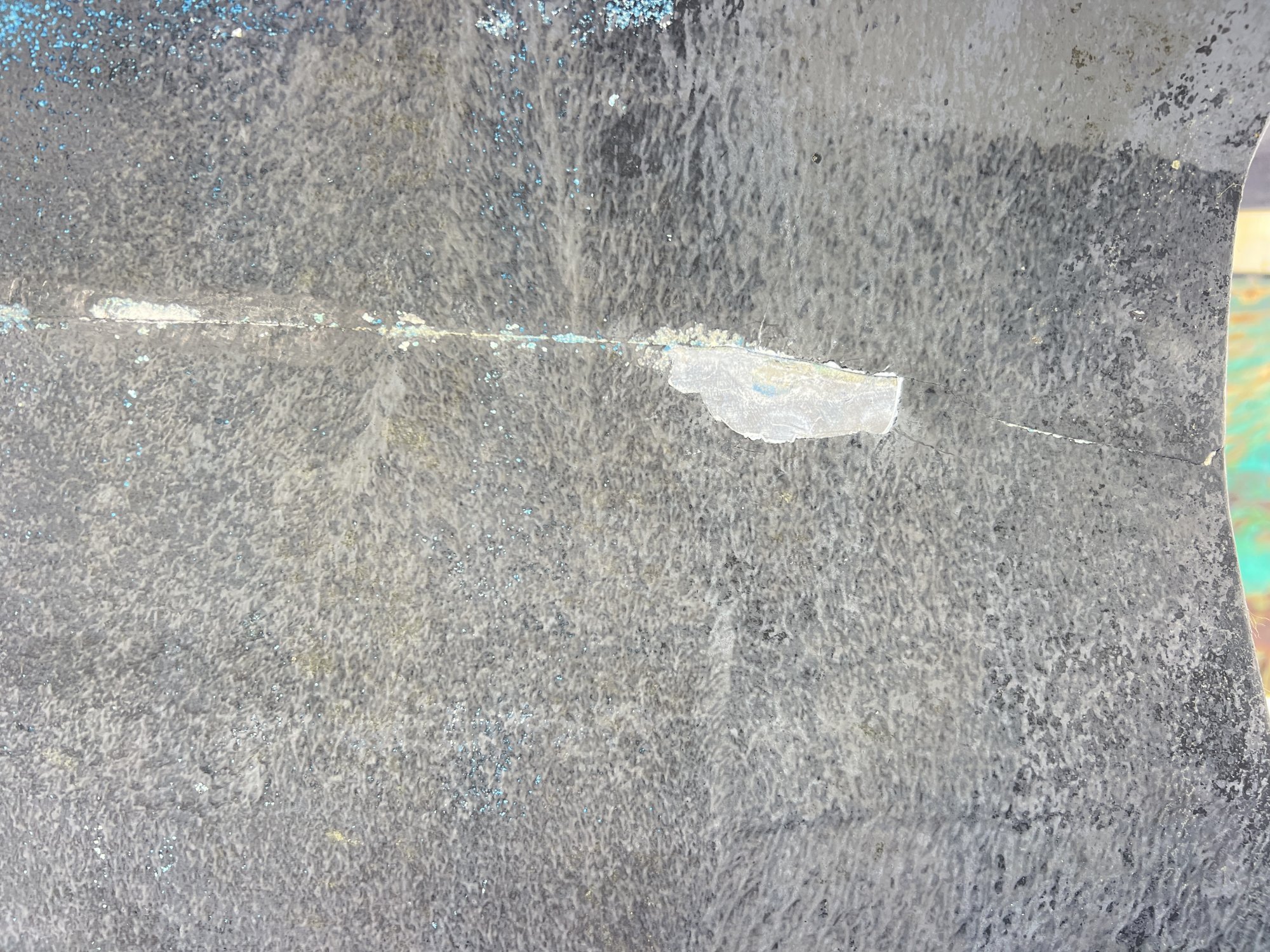

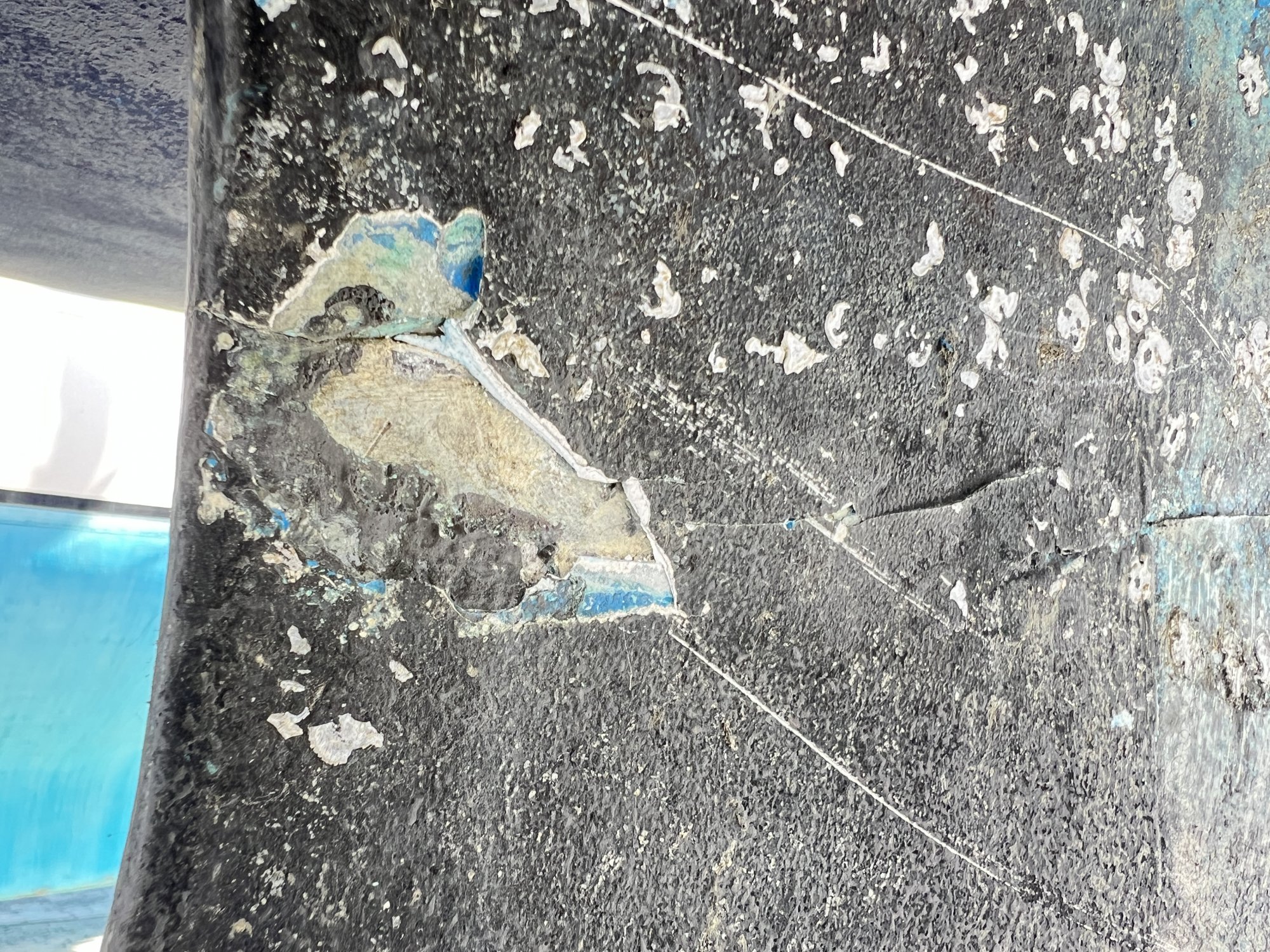

I noticed a crack along the trailing 6 to 7 inches of my keel, around where the seam is for the keel bolts. I pulled off some flaking bits of ~1.5mm thickness to expose lead on the Port side. The starboard side flake was thicker, around 3mm under which no lead was exposed. I got the opinion of a fiberglass technician in the yard who seemed to think that it was not an issue to be concerned about, and that I should fair it, sand the exposed lead, epoxy it and then do my bottom paint.
Any thoughts on this?
