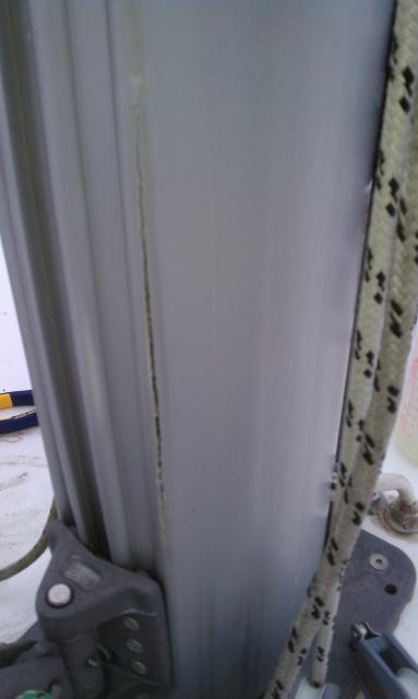

My mast has a 12" crack at the lower section of this 50 ft mast. (see photo) Is there a risk sailing with Genoa with this condition. Has anyone ever had this type of crack repaired with welding ?

1. you need to stop drill that to keep the crack from getting longer ....
2. given the cost of a new mast you prolly need to try and weld it using a pro a pro...

Looks to be failing from the stress from the boom. Welding can't make it worse but is like back surgery after the first effort it doesn't get easier to do it again.

I had a crack after a hurricane and JSI welded a sleeve around it. Good as new.

I agree with drilling a small hole at each end to stop the crack and then call a mobile welder that does aluminum welding and a bead should fix that

small hole = 1/8 inch.

I would want the opinion of an expert - a good surveyor or a trusted yard. I would not mess around this.

There are two posible outcomes: the weld will work and all will be well OR the weld will fail and the crack will re-open. If the weld fails and you make it bake to the dock plan to replace the mast.

Ross is correct about the welding working or not working ...if welded by a pro more than likely it will turn out ok fine and will look a little like it has been repaired but thats ok give the cost of the mast......

Welding aluminum is a bit tricker than steel. You need to find a master welder from a better shop. The amount of magnesium in the alloy will be important in the welding and welders that have experence with aluminum will have no problem. Those without that experence will blow holes through the metal.
Now what caused that crack? It might be a very good idea (just because I thought it up) to check your rigging tension before the welding is done. Loose rigging is very hard on a rig and to crack the mast that low means it has flexed alot.
Good luck with your repair. Ray

I've watched a new mast extrusion being cut, squeezed together, and welded into a taper with all the masthead components welded into it. I would venture that this can be fixed by a good welder.

make sure if it is welded that whoever does it cover a large area of your deck arounbd the mast with thick fire proof material to prent little piece of hot steel from embeding themself in your fiberglass deck, or better have it done with the mast of the boat,

Personally, I would consider removing the mast from the boat if you are going to weld it.

Where will the steel come from when welding an Aluminum mast? The job is much better done down hand with the crack horizontal. Not many would want to attempt to weld that vertical.

Many years ago I worked at a metal fabrication shop, and the boss brought in the mast from his sailboat, snapped in half. He had the shop welder, an expert in Aluminum welding weld on a 12 inch sleeve around the break - back in service with no problems.
The key point is an experienced Al welder - We had lots of steel welders claim they could weld Al, but they usually just burned through it - ouch.

if you hire a good welder he may not care if its up or down....most aluminum welders can weld overhead as well as flat or vertical.......most have been trained to do it all positions.....and if they are certified they will be able to do that ....if you need to know if they are certified just ask them for there papers and ck the date... to be current the date will be no more than six months old....

Yes, I can just see the welder cooking wires, lines and conduit.
That is the only reason to suggest it. When the stick is down, it is a great time to replace sheaves (even if they look okay). It is not an easy job to do with the stick on the boat.
