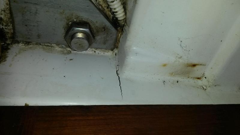

I'm a relatively new owner (four months) of an '83 Hunter 34. I just discovered a crack in the FRP next to a keel bolt in the shower sump. I don't believe it is structural (I'm a mechanical engineer, recently retired) but wanted other's opinions.
The crack is on the side of the hull rib that goes under the compression post (and before anyone goes there, I know about the compression post issue, and it appears to have been addressed on this boat). There is no matching crack on the other side of the rib or the other side of the keel.
I believe the crack is in a cosmetic cover over the real rib, but can't figure out why it would be on the side and not the top where the maximum stress would be. Or what stress could have caused it.
The pictures came in upside down (don't know why, they're right side up on my computer). Sorry about that.
Any thoughts?
