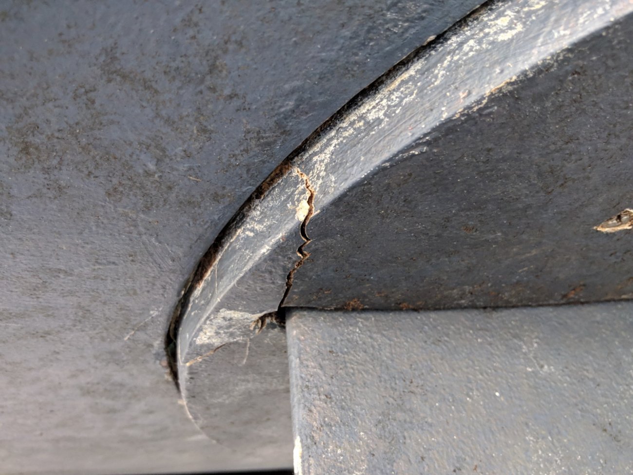

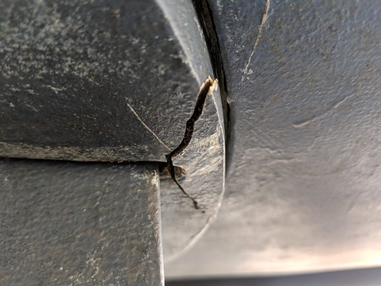

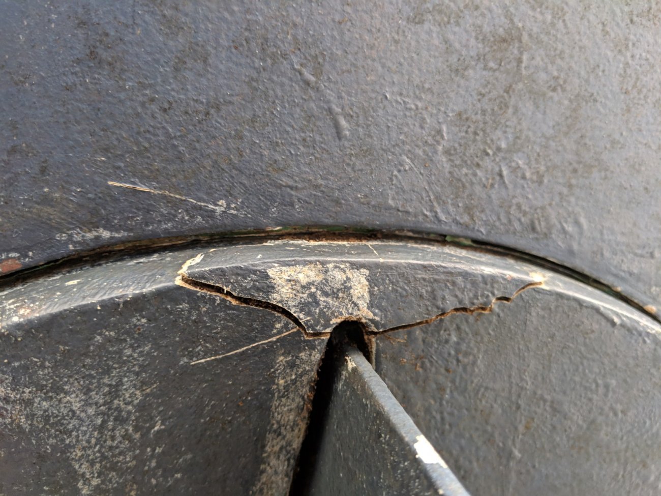

I was inspecting the bottom of my Hunter Edge 27 before launching and noticed the base of the rudder drum is cracked. I think it happened a year and a half ago when I pulled onto my trailer with the rudder partially extended.
I'm fairly certain it was cracked all last summer with no issues. So I don't think it is causing any mechanical problems. I would like to repair the drum before launching, but I have no idea how to remove the bottom of the drum. I've looked through the manual and am not finding any information how to disassemble it. I know there are bearings around the drum, so I'm afraid to blindly try anything. There are 4 phillips head screws in the bottom of the drum (not shown in the photo). I was tempted to unscrew them to see if I could remove the bottom of the drum, but I wanted to check here first.
