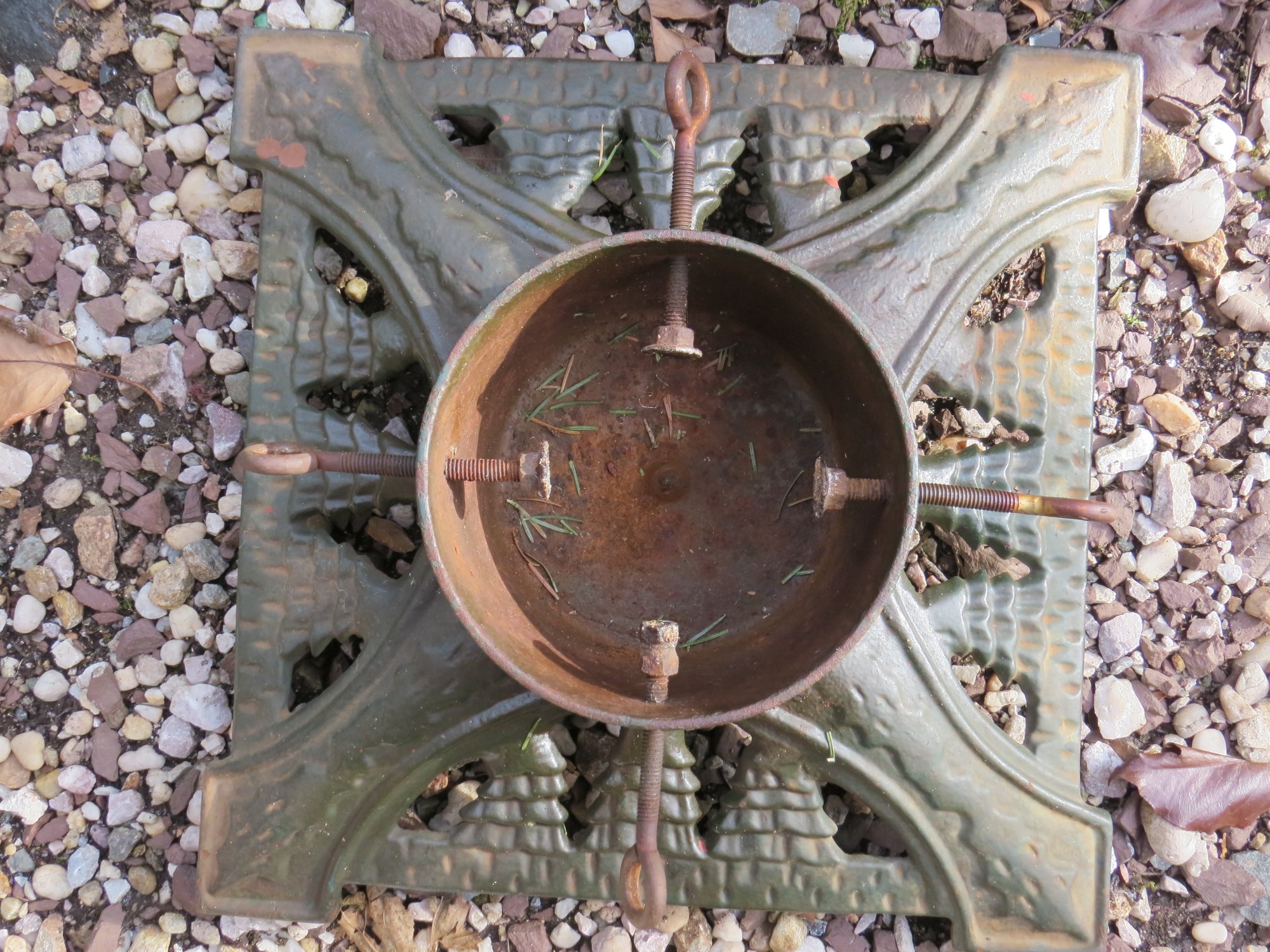

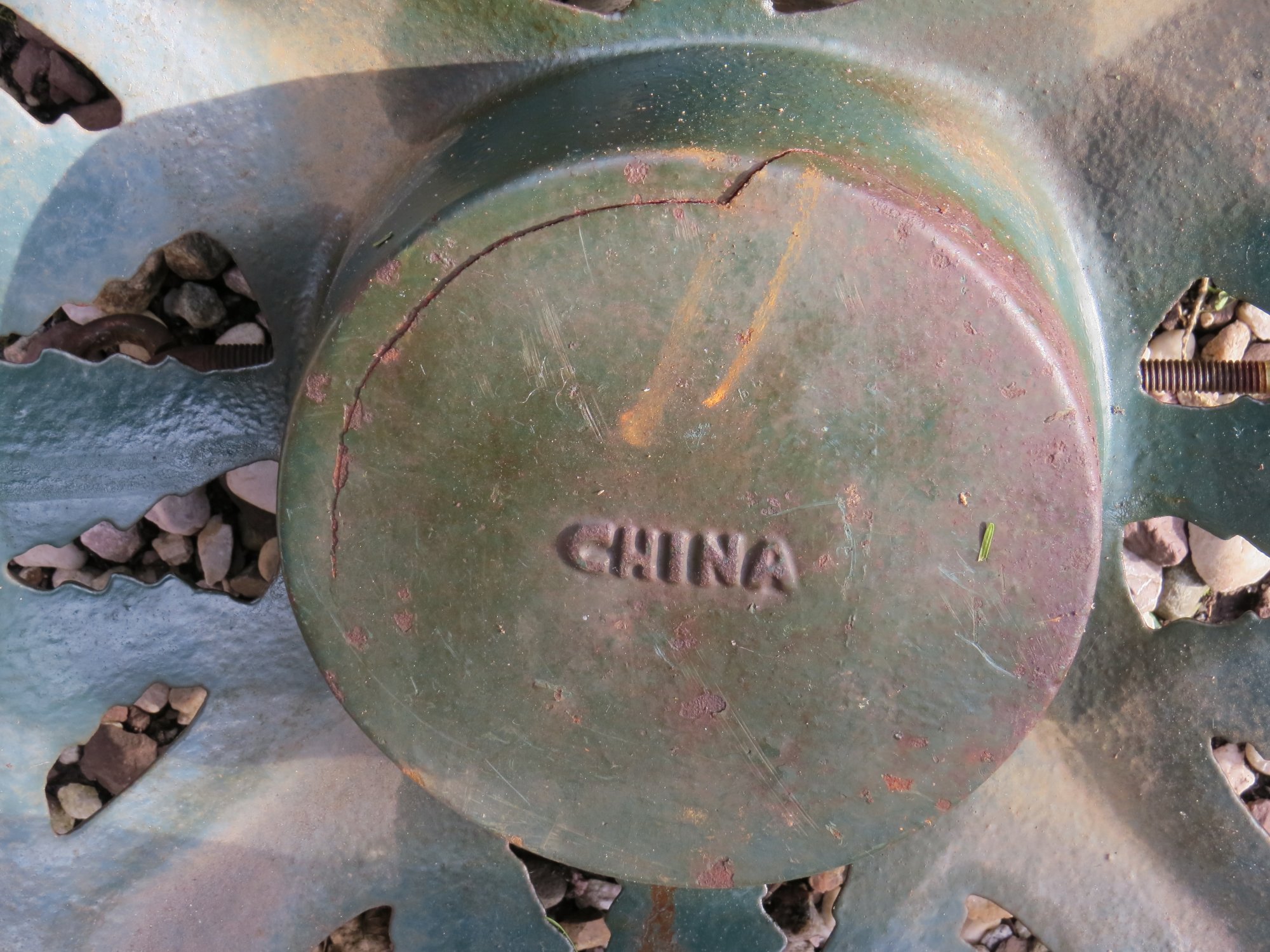

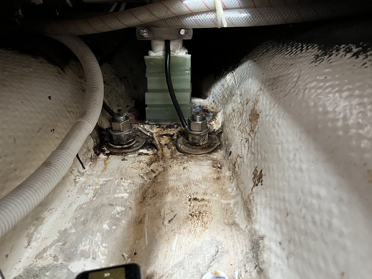

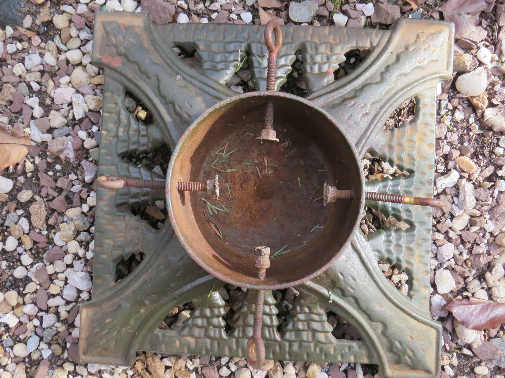

Last week I went to get my cast iron Christmas tree stand ready for the season. I had left it standing upright on the patio where it filled up with rainwater all spring, summer, and fall. Recently there was a cold spell and the water inside froze, resulting in a large crack from expanding pressure. If ice can do this to a cast iron stand, just think what it can do to your boat. I am enclosing pictures of the tree stand, as well as a bilge typically found in a sailboat with a bolt on keel. Any water left standing in the bilge during the off season, has nowhere to go except outward, possibly cracking the hull. If you have an opening at the base of the mast for in mast furling, rainwater can enter through the opening. If there is enough and it gets cold enough, it might freeze and crack the base, rendering the spar useless for anything except recycling into beer cans and screen doors. IMG_2133.JPGIMG_2134.JPG076198B3-E042-41CB-B615-33D5833C1913.jpeg

A bilge isn’t a confined space as is your tree stand base. It can, however, damage bilge pumps, float switches and hose connections and for that reason can be problematic.

Sorry for your Christmas tree stand - that was a very nice one! You could go get that piece either brazed or welded and keep on using it - if you wanted to go to the trouble....
Just a note - the grey cast iron your tree stand was made from is a very brittle material. It will break before it stretches to any degree.
For sure, you don't want water sitting in your bilges and freezing, but it is not a fair analogy to compare with that grey cast iron pot...

We put antifreeze in the bilge to avoid problems from expanding ice. Pink stuff.
I do the same, but some sailors simply pump it dry, let the remainder evaporate during the fall, then forget about it. Depending on the boat model, whether or not it is shrink wrapped and the angle on which it rests, water can still find its way into the bilge. Most yards store sailboats with the bow a few degrees higher than the stern. This lets rainwater that gets into the cockpit drain out through the stern if its an open transom or the through hull fittings if otherwise. Sometimes, however, this lets water flow into the cabin via the companionway slide. If the boat has the mast stepped on the keel, that is another possible point of water ingress.
dj
I would not have paid a welder $50.00 or more to fix something that I bought 20 years ago for half of that. Looking back, I could have used JB weld steel epoxy putty on the inside to make a repair. Ended up buying a plastic stand. You are right about comparing brittle cast iron to fiberglass which does have the ability to flex under pressure.

Technically, since it's cast iron it should really be brazed instead of welded. But I understand completely.
dLj
Mar 23, 2017
5,026
Hahaha - well we could certainly get into some serious thread drift on this one....
Grey cast iron can be both brazed and welded. It's easier to braze. But I've welded a lot of grey cast iron...

Empty your bilge, toss some -50F antifreeze in there if you prefer but whatever you do, make sure your bilge pump has no water in it or highly diluted antifreeze. A Rule 2000 will run you about $200

Your bilge will act like an ice cube tray. In 5o years of storing in cold weather I have never heard of a boat damaged that way. I knew one guy who bought an O'Day 35 that had been stored with water over the floorboards and it froze solid in the Wisconsin winter. Even the engine was encased. The boat was fine other than some water damage to the interior wood.

My bilge was bone dry when I put Tally Ho on the stands last year, but I found ice in there upon doing a boat check in the winter. This year, I emptied the remaining pink AF in the jugs after winterizing the water system, head and engine. I turned on the bilge pump to circulate the pink stuff in the pump as well.
If the water were to freeze in limber holes and other constrained area, I am not sure what would happen.
