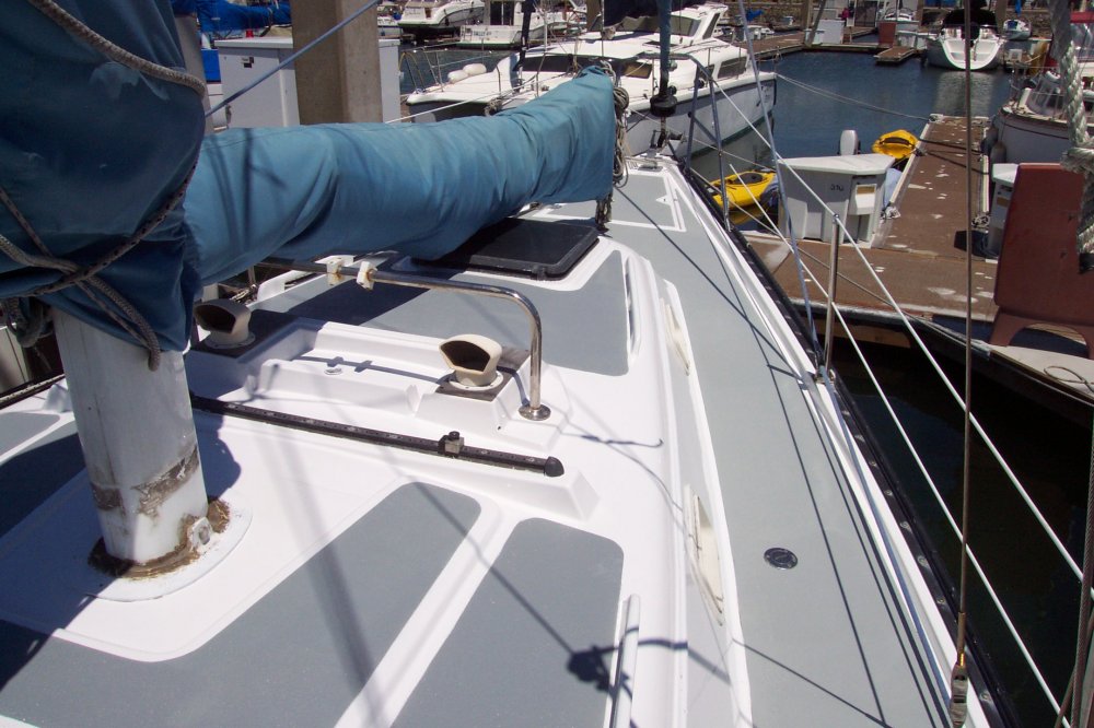

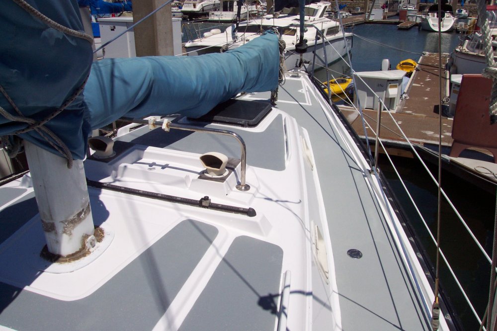

By the way, I would love to see pictures of how the crash bars are set up on the 37C...

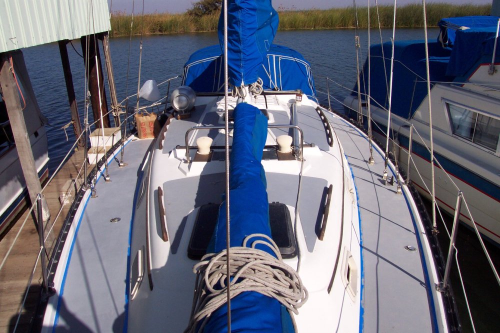

Thanks for posting the picture Johnb. So it is one bar, there's not a cross bar(s) for additional support? I can't tell from the picture.

Thank you - that helps. What are the two little white things on the crash bar in the center? Is that to keep the boom from sliding if you rest it on the bars?
Yes it is. However most of the time when we are on board I raise the boom up because if it is tied down you could not escape through the Vee berth hatch. They are home made out of Starboard.
