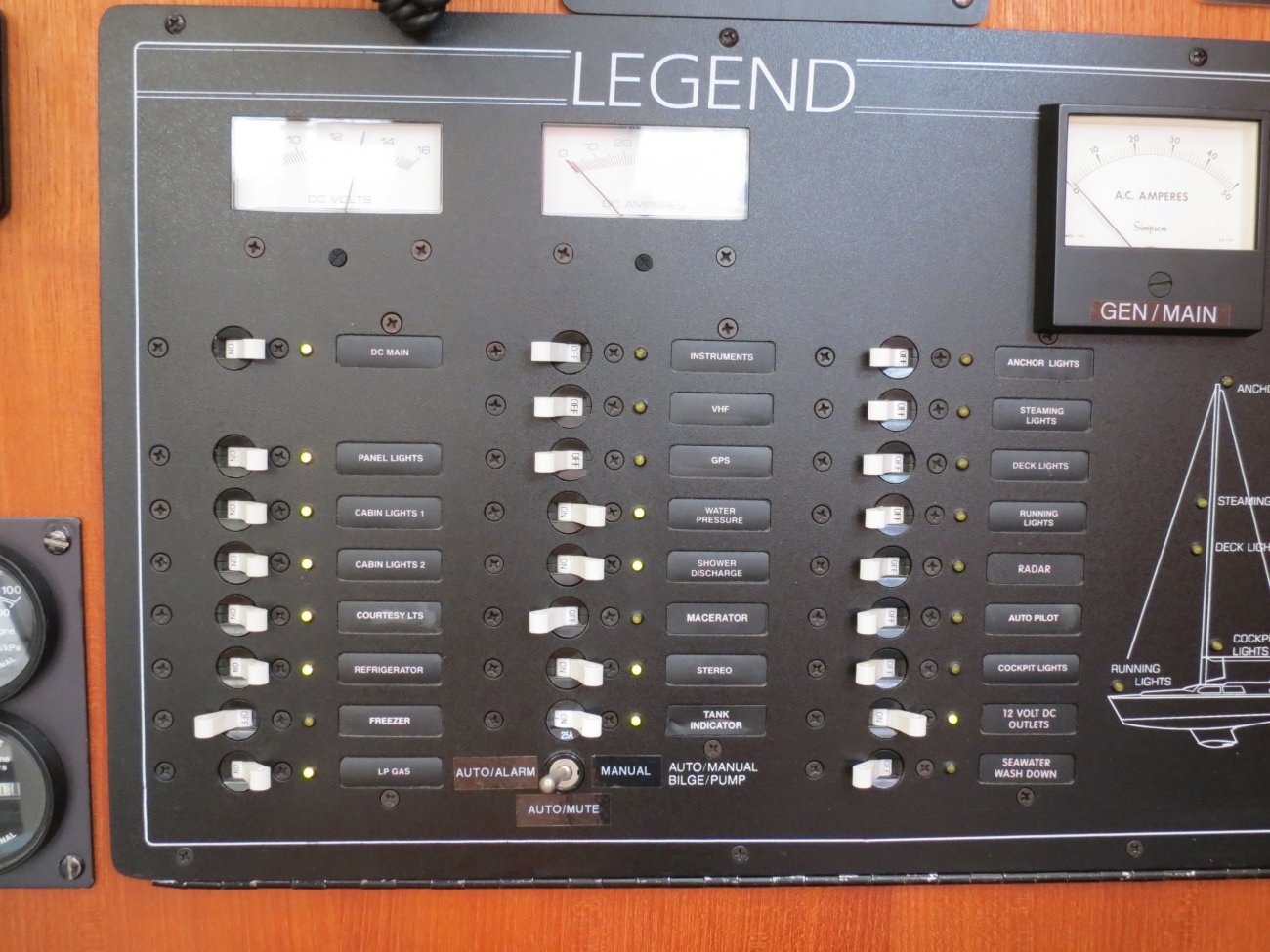

The tips for replacement are to turn off the main 12V breaker and disconnect any 120V A/C power to the boat to be certain that nothing is "live". You will have a 2-3 wires to loads on the breaker- be sure to count and identify so you get all back correctly. One wire will be to the LED indicator and the others to lights onboard.
Be careful not to drop the screws!
My panel is labeled a bit differently- see attached. I think my "Courtesy Lights" also feed the U-shaped lighting around the companionway.
