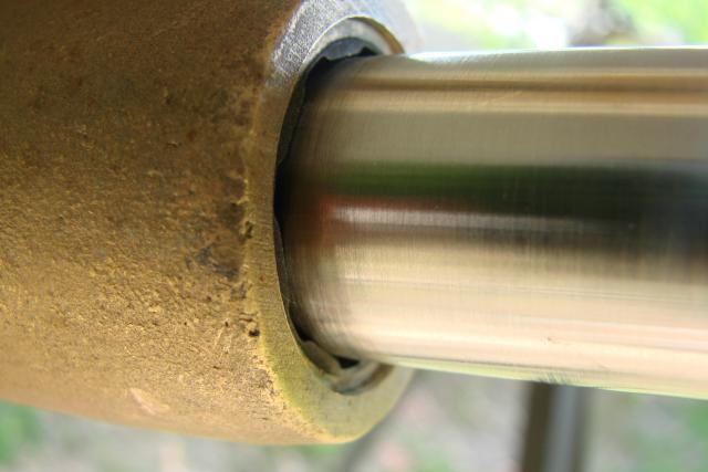

Steve, the only reason why I went ahead and purchased the R and D was that the boat already had an anti-vibration coupler on it. However when I got the old coupler and shaft tube off, the evidence of mal-alignment was obvious. The shaft tube was worn thin on the bottom and to the side and crumbled along the trailing edge where the friction and contact with the shaft was worse. The mal-alginment over the years had also worn the shaft and made it thinner in diameter the entire length of the tube. Now starting all over again with new parts, I "dry fitted" the new tube, shaft and coupler and I saw that I had little room for the R and D flexible coupler. Actually, the forward edge of the rotor of the PSS was less than an inch away from aft edge of the coupler when the R and D was added. So I decided against it and concentrated on getting a good alignment.

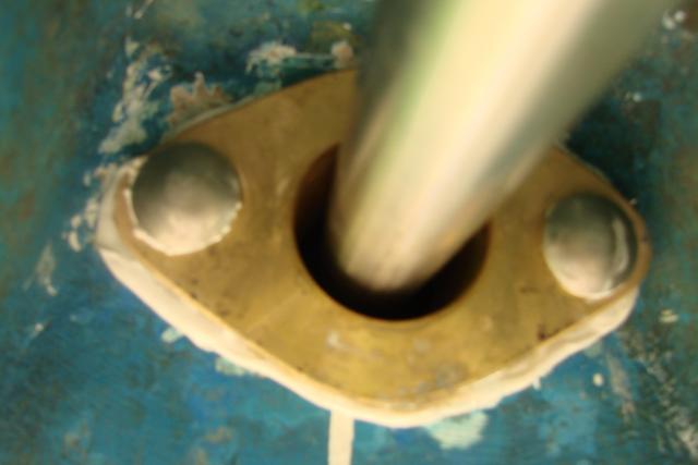

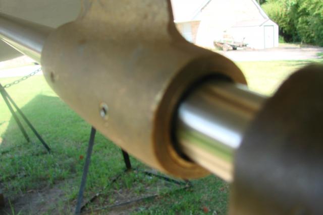

I have carefully set the strut ( took me three times to get it positoned correctly), to make sure that the strut when sealed and bolted, was at the proper location in relation to the tube and output flange so that later, the engine alignment would require only minor adjustment. All that was done last week. Today, I aligned the engine. I lifted the engine by turning the motor mount adjustment nuts three complete turns to each of the four mounts and with a feeler gauge, the output flange and coupler were dead on and even all around. Ck'g 12 and 6 o'clock positions and then 9 and 3, all were within .001. I did this by ck'ing with one coupler fastner on but loose at each of the four holes. They are flat to each other with or without a bolt on. Outside the boat, looking from the end of the shaft (without the propeller) toward the tube, the shaft is dead center in the tube, same amount of space all around. This was obviously not the case with the old shaft and tube.
I know I will have to align again once in the water, but the engine is low on the bolts and I will have room to further adjust. Right now when in neutral, the shaft turns nicely. Most importantly, the shaft sits in the cutlass bearing un-pinched and contact with the rubber insides of the cutlass bearing is even top, bottom and all around on the forward end and aft end of the strut. Before adjusting the mounts I found out that you really have to observe carefully how the shaft sits inside the stut. It is subtle. Looking closely though, you can tell if the shaft is pressing on one side within the bearing more than the other if not laying in the strut straight. The motor allignment took care of that. Turning the propeller is easy all the way around with no feeling of tightiness or pinching at any point. All is new so the fit is snug but it rotates evenly.
