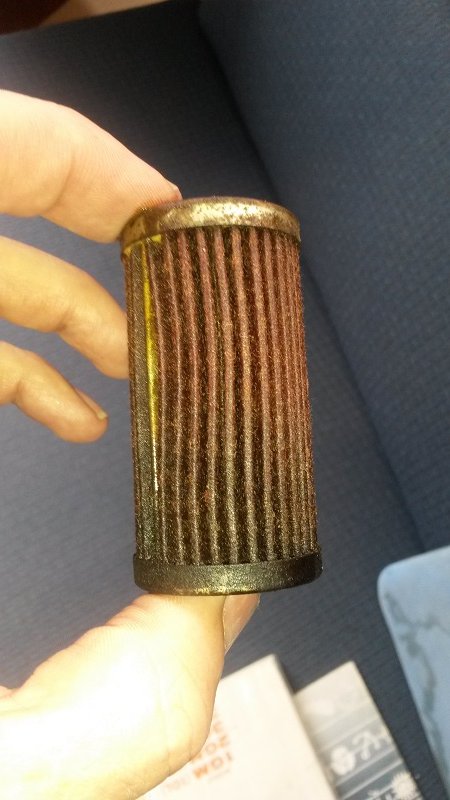

I've replaced the impeller before.
Yesterday, I replaced the fuel filter for the first time. It was definitely due. Bled the fuel line, fired the engine. Beautiful.
Nice! Did you change your primary fuel filter too?

Also changed the oil (engine and trans) and oil filter, and air filter.
Can't say enough about my new oil extractor from West Marine.
http://www.westmarine.com/buy/west-marine--manual-oil-extractor-6-5l--11047123
The largest of the suction tubes just fits in the dipstick hole. 5-6 pumps and it sucked out all the motor oil in 60-90 seconds.
I see that they also sell a smaller version of the same pump. It is large enough to have done the job too. Oh well.

Yeah, the tougher one is the secondary and having to bleed the fuel system. Saved yourself a bundle there!
Feb 6, 2013
437
Hunter 31 Deale, MD
Actually, bleeding the system was pretty simple. There's a lever on the fuel pump at the aft edge. After I replaced the filter, I removed the bleed screw from the top, pumped the lever until fuel came out the bleed hole and them reinstalled the bleed screw.
