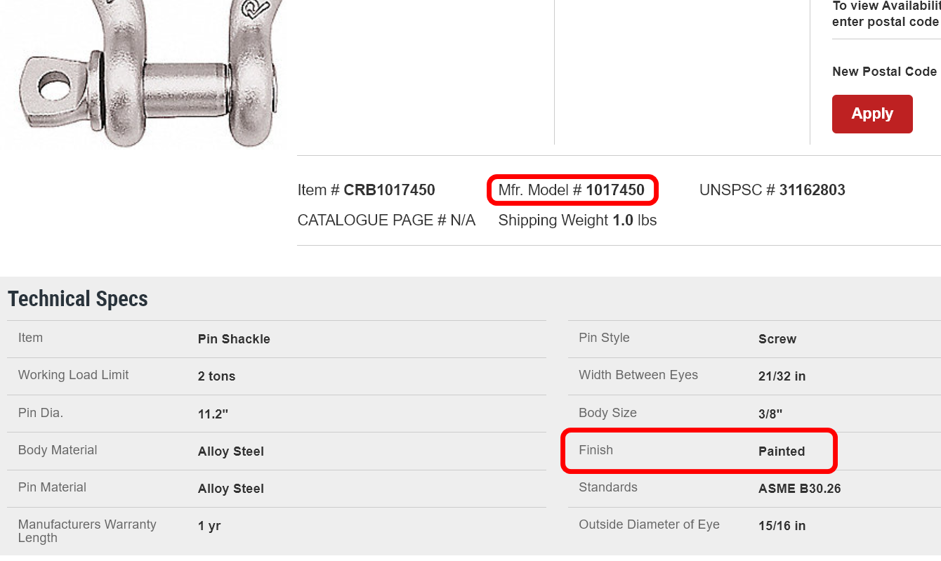

Interesting - when I went looking for that shackle, I saw a couple places saying it was hot dipped galvanized. The photo of the part told me that could not be the case. Painted? Lordy, that's lame for a marine shackle...
It also makes sense given the rapid corrosion being experienced by @skunther with those shackle...

Crosby does still make hot dipped shackles. From their website they indicate shackles 3/8” and smaller are mechanically galvanized rather than hot dipped.
Can a 7/16 shackle pin fit through your chain links? This would give you the hot dipped version.
Likes: skunther
Jan 4, 2006
7,685
Cheap beyond f***ing words.
Some bean counter at Crosby figured out a way to screw the customer for a few dollars more and some one in charge said "Yah. Let's screw 'em !" Send in an order for several hundred shackles and I'm quite sure they could get them hot dipped for well under $5.00 ea. No one with any thinking capacity is going to buy a Bargain Brand Crosby Shackle for $5.00 less than a regular hot dipped Crosby shackle if it means "Painted Only. Sorry, No Hot Zinc. Sorry, No Returns. Sorry, No Refunds."

So these were advertised on Westech Rigging’s website as hot dipped (actually I see the next Iine after “hot dipped” states: Sizes 3/8" and below are mechanically galvanized), which didn’t clue me in to the fact that they are just painted. “Mechanically galvanized” was a pretty nebulous term to me.
Anyways, does anyone know if and where there are any 3/8” hot dipped shackles (that are actually hot dipped) out there?

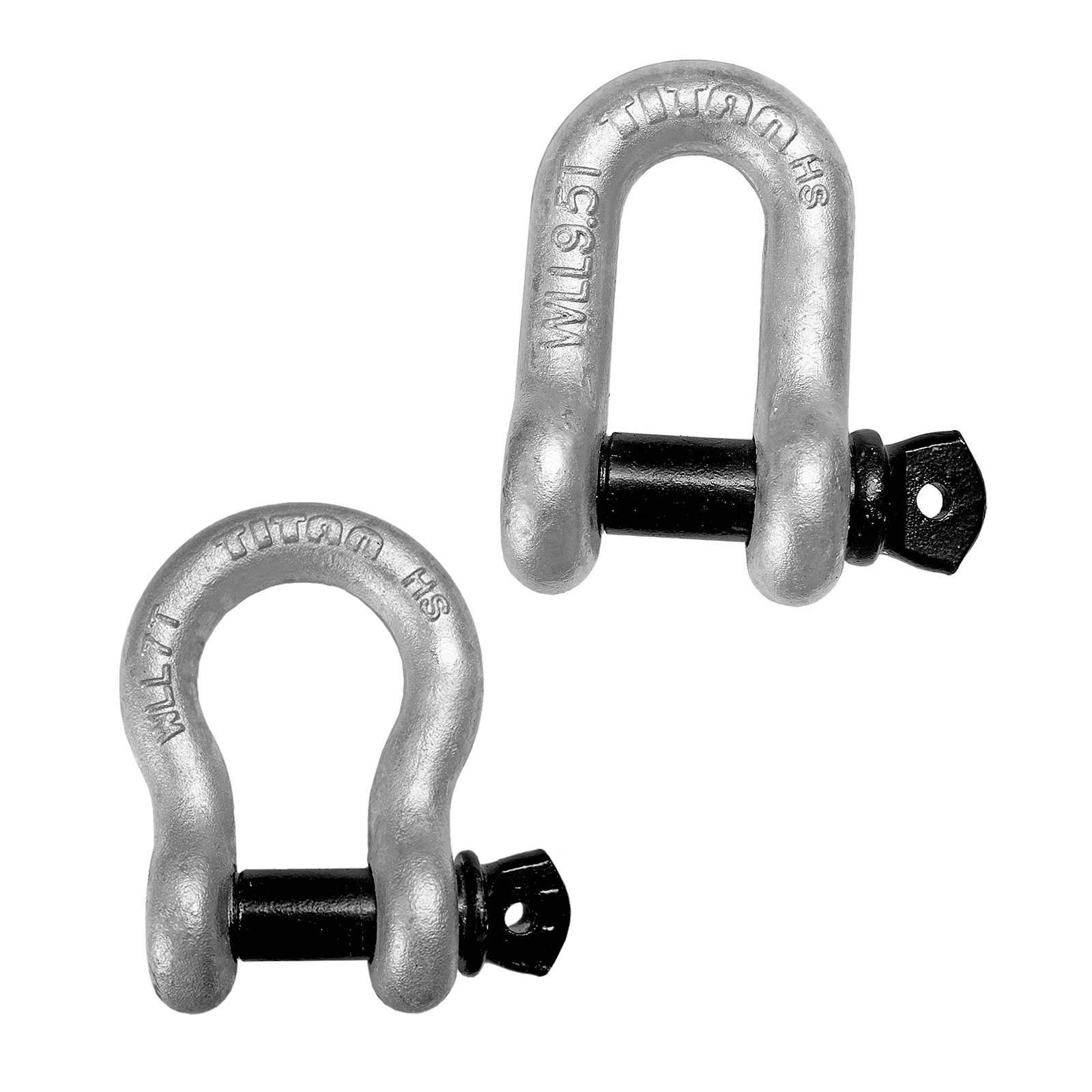

Those
High Strength, Forged, Hot Dipped Galvanized Shackles
Have a "Bold black colored pin". Is that marketing speak for "Painted Pin"?
From an engineering perspective, I can understand the idea of the colored pin. They can get a much better pin thread manufactured. It maximizes the size of their thread in the shackle reducing the potential for pin failure. They can get better results during their load failure testing. I note that none of their testing is done after 2 years exposure to marine environment use. After a boat owner has dipped into the deep, dragged it back forth and over rocks, coral, and exposed the shackle to the potential of stray current corrosion from a fleet of boaters.
John (Ooooops, edited), the pin is definitely painted. In CMP's case, I believe that the paint differentiates between load limits of their 2 - 3/8" shackles, one 4,000lbs (black coloured pin) and the other 2,200lbs (copper coloured pin). According to the link: Forged, Hot Dip Galvanized coating on both the shackle and pin.

So that's a bit confusing too. I was about to pick up the Titan, but was concerned the pin might not be hot dipped. I checked their website, which states the pin is hot dipped. Then saw @jssailem and @Hello Below's posts. Is painting and hot dipping an either/or scenario? Is it hot dipped as advertised, and then painted? Or is the pin just painted?

I just ordered 5 of the hot dipped 3/8” Titans that @Hello Below recommended. Hopefully that addresses it. Worst case if they still corrode, I can replace them yearly for $7 a pop.
