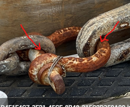

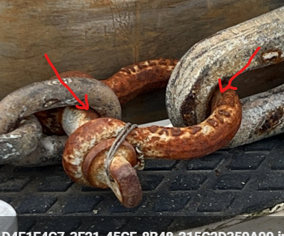

I’ve gone through 2 shackles in as many years. Something seems wrong as I see plenty of other anchor rode without corroding shackles. Anyone have any input on this? I’d just like to get a strong shackle I can trust that won’t corrode and need such regular replacement.

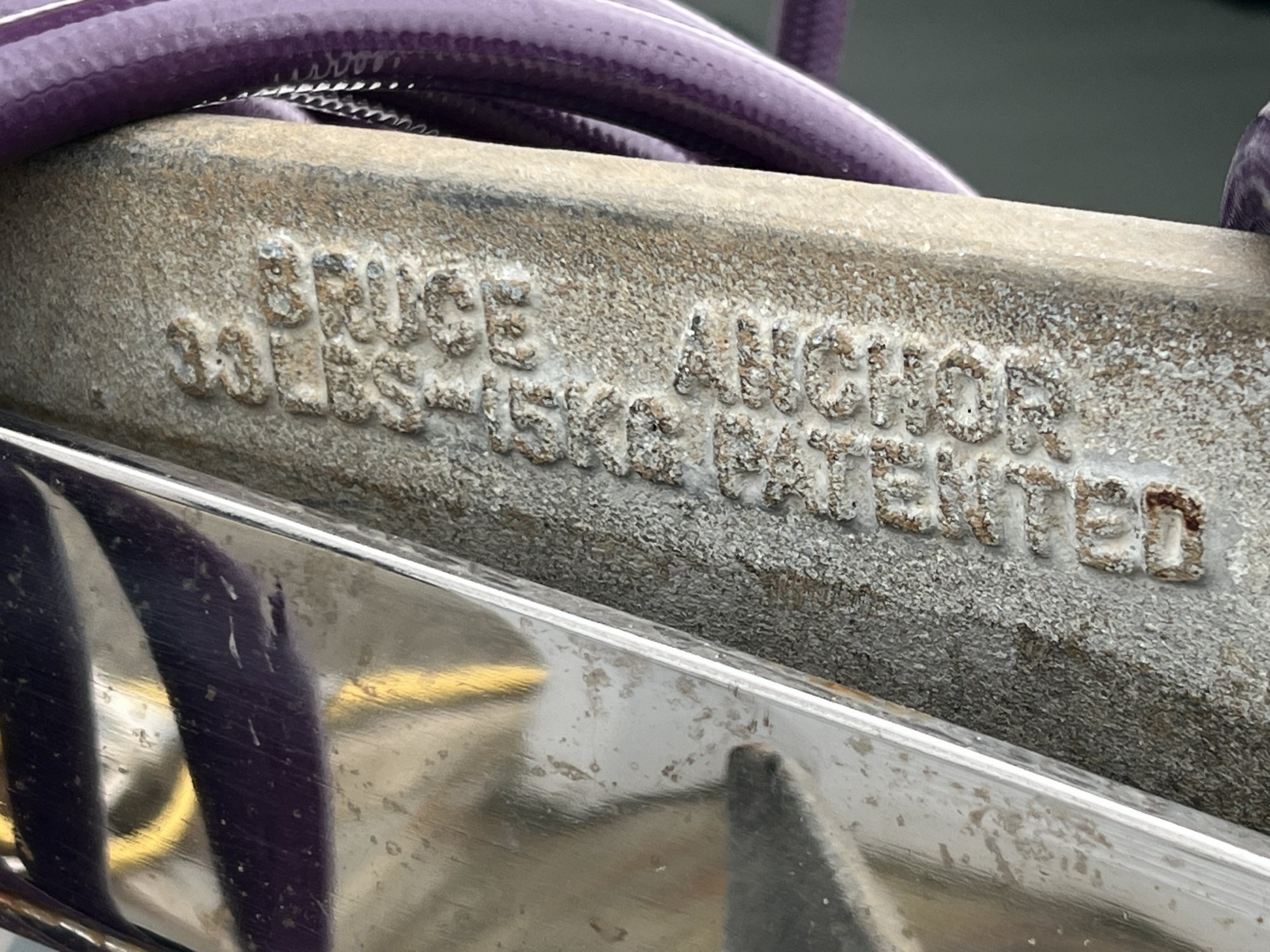

I have G4 chain, a galvanized Bruce, and the shackle in question is a Crosby 3/8" G-209A Alloy Screw Pin Anchor Shackle - 2 Ton WLL - #1017450
I got this response from Crosby regarding the shackle:
“The Anchor is most likely a carbon steel casting. The chain is most likely a carbon steel chain. The Shackle is alloy. These dissimilar metals will cause a galvanic action between the parts. The shackle has a Zinc coating. This Zinc actually becomes the sacrificial anode in this system. The galvanization for a boat anchor is a different chemical mixture than the galvanization of a shackle or chain.”

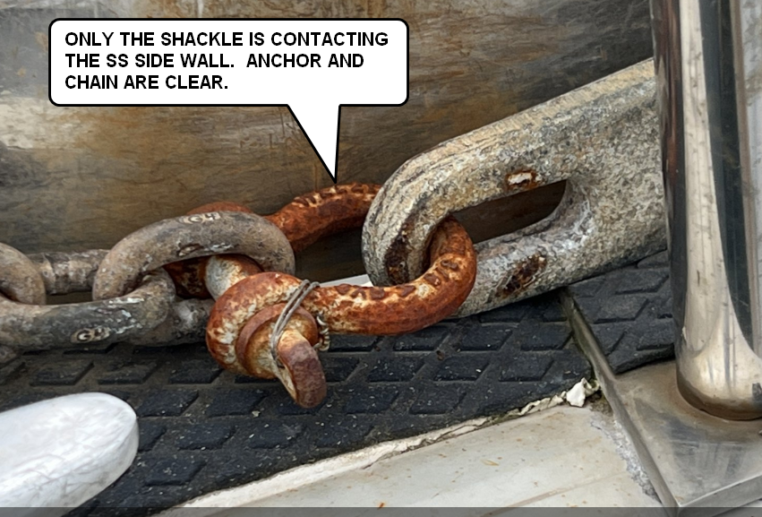

There's got to be a reason why the shackle is the only thing corroding and corroding so quickly. Look closely and you'll see :
What makes the galvanic corrosion so bad is that surface area of the SS side wall (cathode) is large while the surface area of the shackle (anode) is small. A recipe for fast corrosion.
A SS shackle would be a good solution because you would then have a small surface area for the shackle (cathode), no interference from the SS side wall and the anchor (anode) has a large surface area . The chain (anode) I'm not too sure of. If it corrodes over many links (anodes) you're safe. If the chain only includes one link (anode) then you may have accelerated corrosion on the one link in contact with the SS shackle.
OR
Convert all your tackle to SS.
OR
Install a 1/4" piece of Starboard on the sidewall where the shackle currently contacts the sidewall. Maybe that would be the easiest. Nicely bevelled forward edge to avoid getting damaged by the shackle as it passes by. Maybe bevel all around with a 45° router bit for a real professional look. You could make a real masterpiece out of it.

@Ralph Johnstone that's a really good catch and fascinating analysis. Some way of insulation the shackle from that stainless would do the trick, if you are right.

Very interesting @Ralph Johnstone! I would never have thought of or caught that. I will have to confirm that is the (only) point of contact and isolate the shackle if it is touching.

Or simply get a pool noodle, cut a 6 inch peice, slice it open and wrap it on this section when you pull the anchor in. Isolation.

It is an interesting observation by @Ralph Johnstone but I don't think that's the problem. I looked up your shackle and some sources say it's hot dipped galvanized, but the appearance does not look that way to me. It looks more like a mechanical galvanize, a more modern zinc deposition process used instead of hot-dipping (that the marketing people like to call equivalent to hot dipped - it's not). Your chain and anchor do look like hot dipped galvanized from the little I can see in your pictures. It would also make sense that Crosby would use the mechanical galvanize method as they are using high strength alloy for the shackle - hot dipping oten lowers the tensile strength of these alloys.
Your shackle in your photo does not look bad to me. It's just got surface rust on it. If it were me, I'd simply clean it up and spray it with cold galvanizing spray paint, as many layers as I had the patience to put on, and go sail. If that rust bothered me, I'd swap out to a stainless shackle.

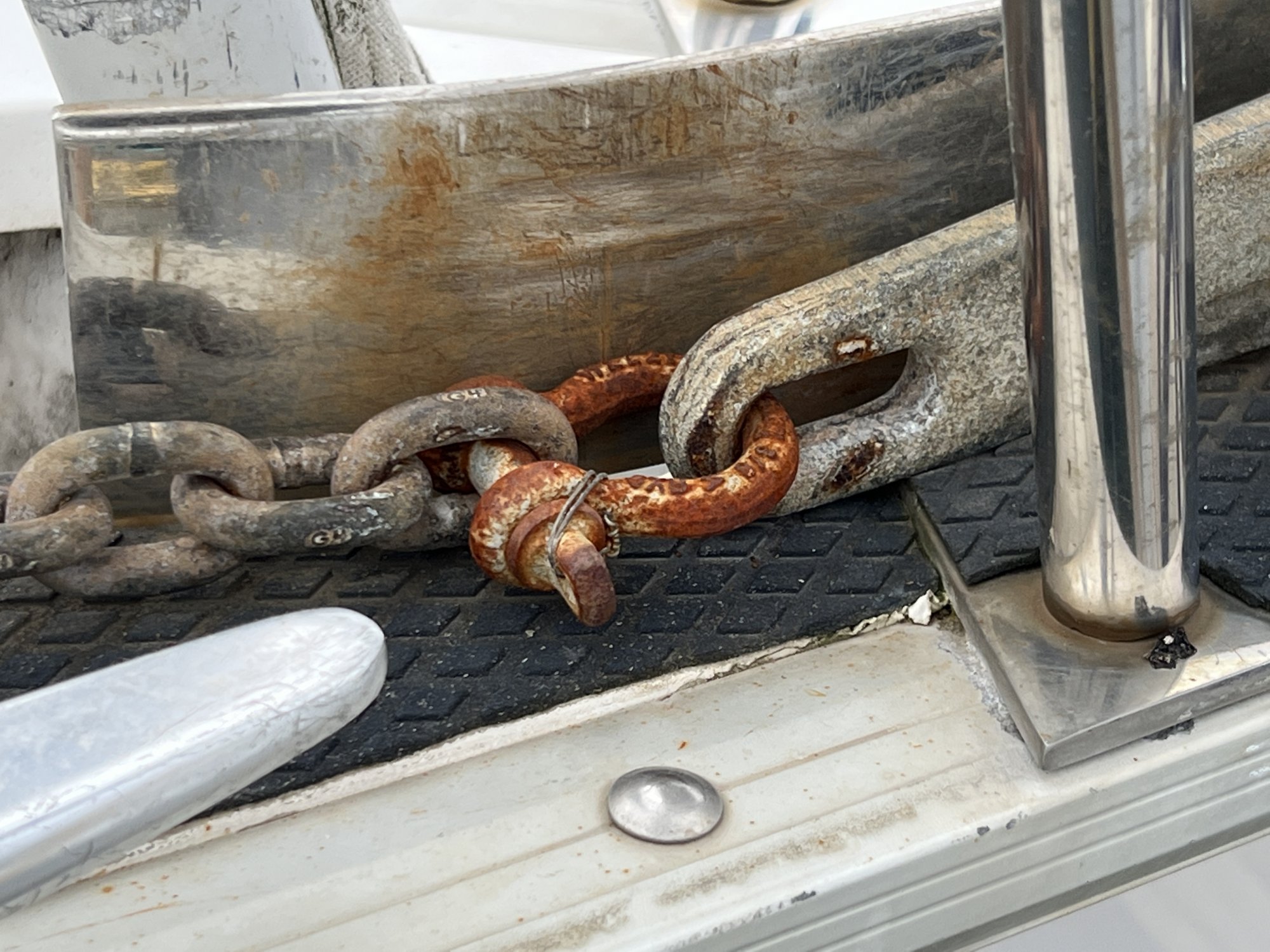

In your photo, note the more visible rust at the contact points at the chain and anchor. That is actually indicative not of galvanic corrosion as suggested to you, but rather mechanical abrasion, removing the galvanized layer in these locations. If the corrosion was occurring due to the contact with the stainless guide, the majority of the corrosion would be on that side. This is additional indications to me that the shackle is not hot dipped galvanized and the galvanizing in this region is simply being abraded away through contact with the hot dipped galvanizing of the chain and anchor.
dj
Interesting observation. I have a similar wear issue on my anchor. When raising or lowering a short section of the shank often scrapes against the bottom of the furling drum, which has worn away the galvanizing. The plan is to clean it this spring and spray some galvanizing paint on it.
dj

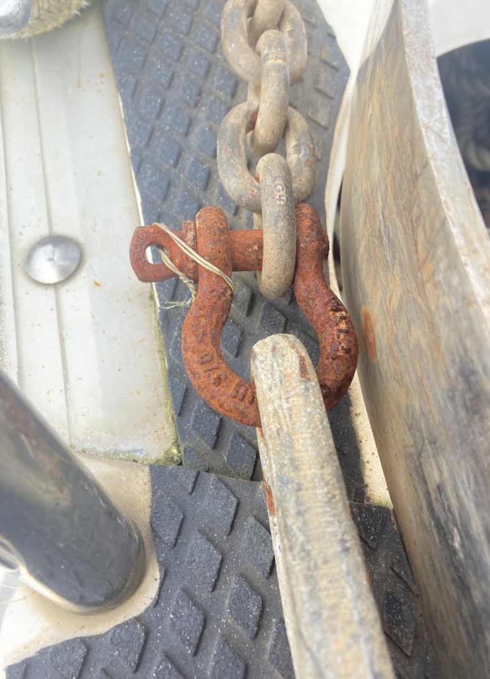

If the shackle I got wasn’t actually hot dipped as advertised (Crosby 3/4" G-209A Alloy Screw Pin Anchor Shackle - 7 Ton WLL - #1017538), then what shackle would you recommend? For <$20 I’d rather just have a shackle that doesn’t corrode than to mess with cleaning and painting it every year.
For reference, here’s what the previous shackle (same Crosby shackle before replacement) looked like after 2 mos in the weather (PNW) and 7 months in the roller

Looking at the pictures, I think dLj explanation is the correct one. It looks like surface rust to me. Dano
I actually don't think anyone is making hot dipped galvanized shackles today. I'd suggest you go to a stainless steel shackle. Get a high strength one - not easy to find - but ask for 17-4 PH stainless steel shackle.
