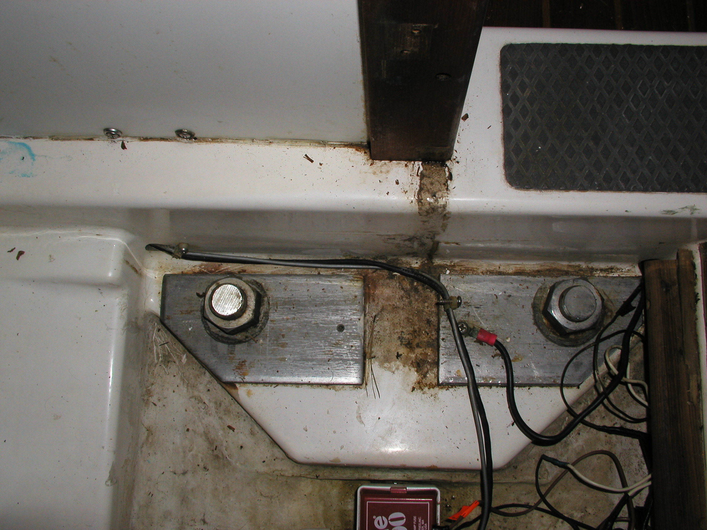

So I'm replacing the soles in my 1983 H31, and have gotten my first look at my forward keel bolts. What are the heavier gauge wires running to both these keel bolts, under the nuts and washers? They are clearly not tinned, as they have turned green. Are they for bonding purposes?
Also, I couldn't believe that on the right keel bolt, two wire ends have been "connected" simply by being paralleled and taped together with electrical tape. I'll fix that connection with the correct marine grade butt connector (I've bought good tools from MaineSail), but when I measure the wire with calipers to determine what size connector, I want to do it right. So I measure the diameter of the bare wire, NOT the diameter of the sheathed wire, correct?
