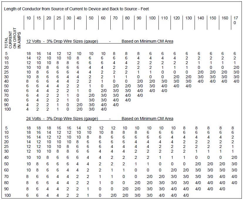

Look at the Blue Seas calculator to properly size the wire. On longer runs and primary runs I like to go up at least one size, from 10 to 8, 8 to 6, because the line loss is cumulative; if you lose 3% from the switch to the panel, and another 3% from the panel to the device, the total loss is more like 5 or 6%.
The circuit protection should be sized to protect the wire. Look at the ampacity charts. If the wire can safely carry 20 amps, then a 20 or smaller fuse can be used.
In your situation with a 40 amp main breaker on the DC panel, I might use cable that can carry 50 amps and then fuse for 40 amps. This will reduce line loss and afford a higher degree of protection due to the larger cable size.

The chart is suggesting with 50amps 1AWG to limit drop to 3%. Note a switch cabe add to your drop by 300-500mamps.

The wire gauge needed to address a 50’ round trip run that only has a 3% voltage drop is 1awg. The switch you place in the middle of the run adds a 300-500ma loss to that run.
You already have 1/0 to the switch. So 1awg can get you the rest of the way from switch to panel. Be sure to use 1awg for the return to ground.

I'm suggesting with a 40 amp breaker you don't need to maintain voltage within 3% at 40 amps. You need the 3% at whatever amperage you will likely encounter. So if you do the math at 40 amps you need "0" cable to manage a 3-volt difference over 30 feet, but 12 gauge wire is rated for 41 amps for chassis installations. So anything bigger than 12 gauge will cause no wire damage. The problem with 12 is the voltage drop, not wire damage. You need to know your expected load.

Now we can begin to determine cable size and breaker size. For the 40 amp draw, I would up the max draw a little and call it 50 amps. This yields a safety margin and room for error or unusually high current draws. Since I abhor line loss, I calculate cable sizing to yield less than a 1% line loss.
Now it is just a matter of knowing the wire distance/length and calculating the necessary cable size to yield less than a 1% loss at 50 amps over that distance. The circuit breaker will be a 50 amp breaker. The system will be safe and efficient.
